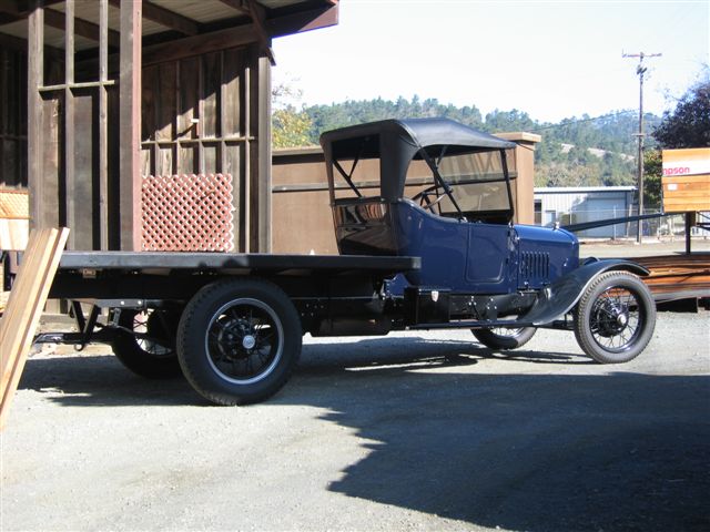

    Here's Pete Eastwood's Model TT flatbed hauler. 327/TH400 with a 9"

    Thanks still dreaming what to do. I know Peter I grew up in Pasadena. He did me a Huge favor when I was a young dum***. I like the way he moved engine to p***enger side to make more room for things like steering? And made neet wheel adapters. Always nice work.

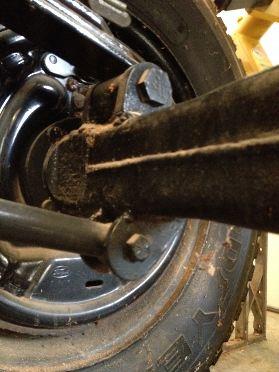

    Hay Osage Orange how did the rear spring setup ride? Just pickup a Dana70 that fits with leave springs. Frame tapers maybe a little to much for perchs your set up seams eaiser. I may make lower arms longer like stock just to be more stock looking.
  5. I've yet to get it on the road, but know that the spring stack can shed a few leafs and still be stiff, as it is certainly a truck. I've debated with a couple of friends whether it makes sense to put shocks on the back, and the consensus is that it would be a waste of time and effort. Another thing: I've not dropped the front axle, but will probably flip the eyes on the spring to drop it an inch. All along I have wanted this to have the stance of a farm truck more than a hotrod, look stock but with just a hint of "that ain't stock."
    Here's another look at the rear end setup, if it helps.

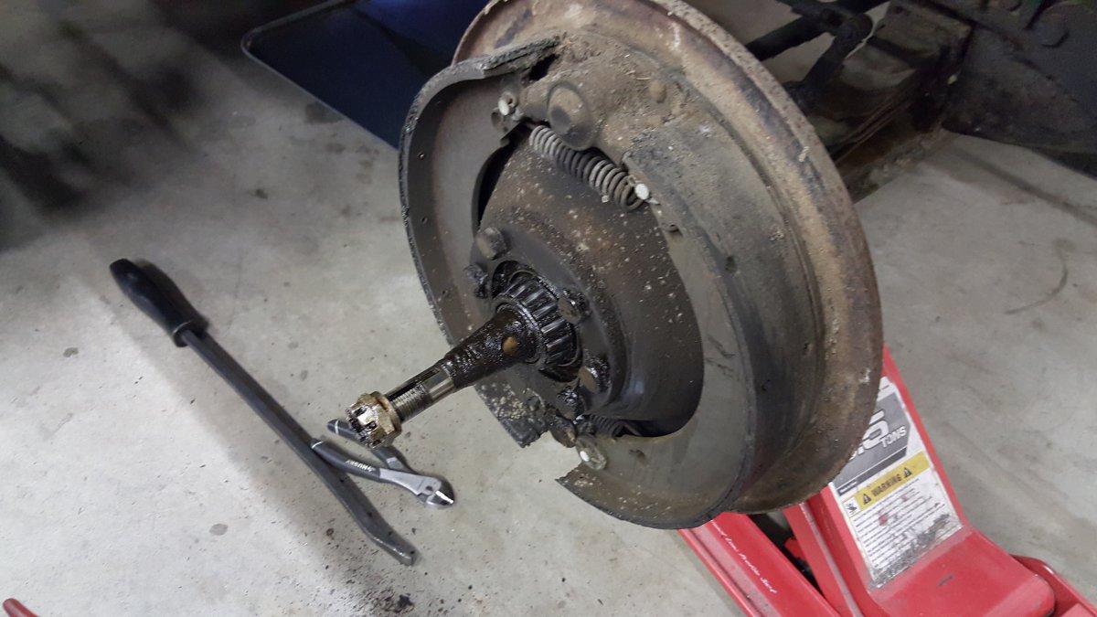

    Does anyone have AA front spindle? Want to compair to standard spindle. I guess if 2" is different than 4" show the 4. Thanks
    patmanta likes this.

    Is there any other straight axles maybe off newer truck that may be better choice for bigger brakes and dually style wheels

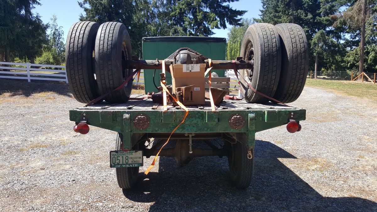

    No not duall wheels up front just a one wheel each side. BB axle is a good idea. Here is a picture of a rear end i may use. ID between tires match stock. The Inveco fits to and are much lighter duty. The Sprinter is 5" narrower but wheels are hard to find
    osage orange and volvobrynk like this.
  25. The photos explain it all. Too wide. What would it take to cut the axle housings and get shortened axles? Not cheap, but I sure like that Dana rear. Nice truck, by the way.

    I am not oposed to wider bed. But going to pull axles and see how much shorter the short side is. If it becomes any narrowed then spring would need to go under frame.
    I think its one of those things that when its rite you know.

    I will look for a rotor tomorrow. Happy that drum unbolt and that spindle is larger than pasanger car
