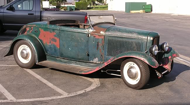

  5. Ok, nice find. Put it together just like this one. Paint and all. Even the fake louvers.

    I debated about running the fenders but decided to go without them, that’s the first thing a young man would have done back in the day, ripped the fenders off

    Looks like the same green house paint we get in Australia. It seems to be on all old cars here.

    got a hockey eye, but that looks like henry's green primer, maker a perfect patina whoever laid it down...

    If the fenders are decent and don't have the spare tire well I'd run 'em.

    They are good and match the car perfectly but I’ve always wanted a high boy but I’ll probably keep them if I ever decide I want to change it up

  17. That car would go together with the fenders and hood if it was mine. It's great to want a hiboy, but just not this car. Oh well it's yours, so do it your way. It'll be cool to see it back together after all those years,however you build it. Keep us posted.
