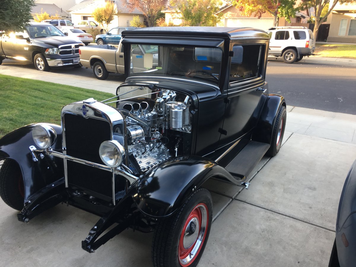

    You can always mix it up a bit! This is my Father in Laws '30. Only a week or two from being on the road.
    You can get your front axle dropped by Sid's droppedaxles.com . That the plan for this one eventually.

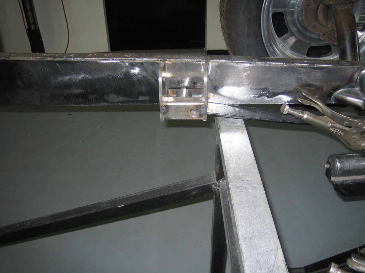

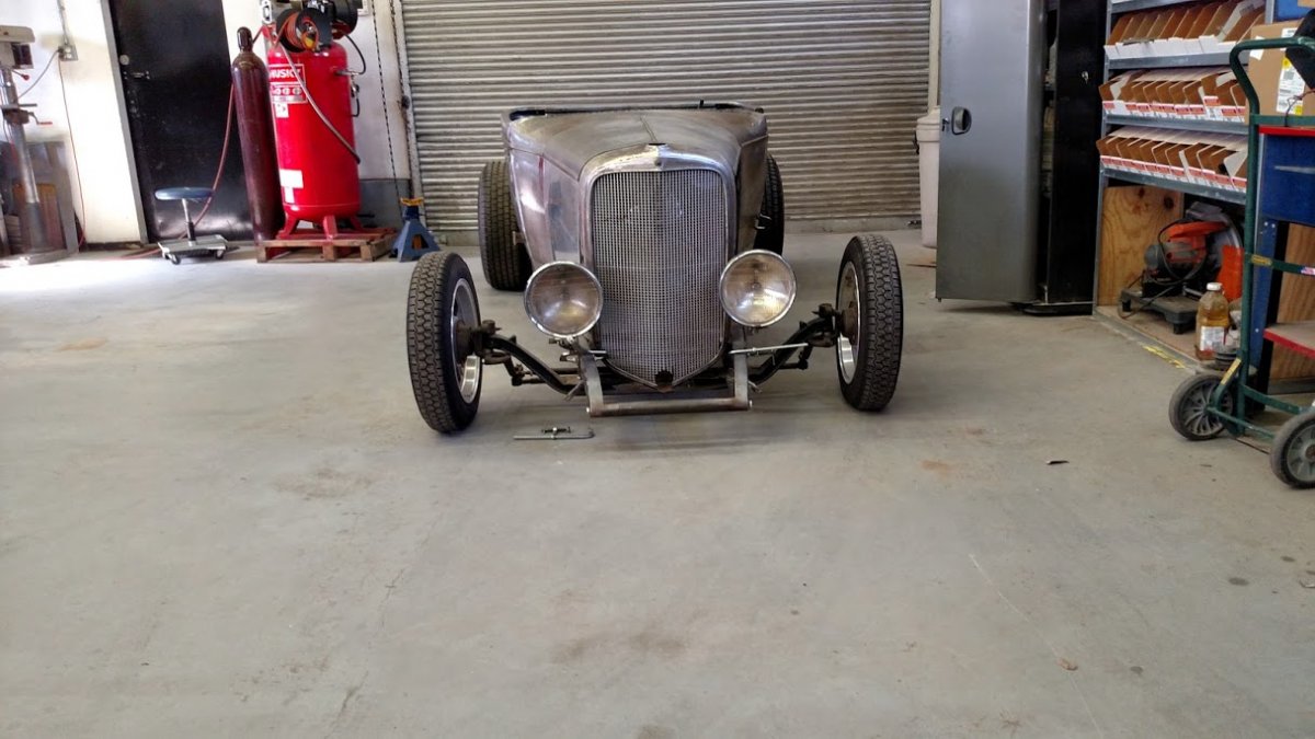

  10. r2c1
    Joined: Mar 27, 2008
    Posts: 201
    r2c1

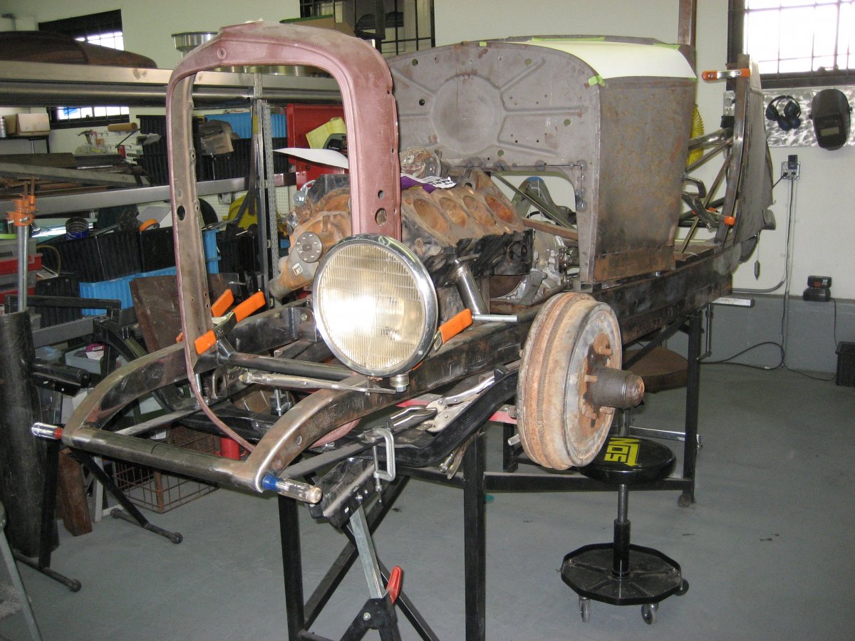

    More pictures. A little explanation here . Chevy ch***is with pinched rails, that's why you see a little more spring pad in the picture. Yes they are parallel . Axle is not flipped. Only one leaf for setup, will add 3 more for final support. Need more pics let me know. Ron IMG_1239.JPG IMG_1240.JPG
  11. Fast Eddie 27
    Joined: Oct 30, 2018
    Posts: 122
    Fast Eddie 27
    Thank you .... can you please explain the "pinched Rails" ? Like the front of the rails have been brought in and front tube crossmember welded in? Why is that done? So with a 6" dropped Sid Axle looks like a perfect ride height....also am I not seeing the front spring shackles?
    31chevymike likes this.
  12. Fast Eddie 27
    Posts: 122
    Fast Eddie 27
    Wait, you snuck them INSIDE the frame rails! I feel 12..:D.that's super clean!
    31chevymike and r2c1 like this.
  13. r2c1
    Posts: 201
    r2c1
    Eddie.... Since this car is a non fendered car and I am using a 33 Chevy grille I wanted the rails running next to the shell. Thank you for the likes on the front spring eyes. Much appreciated .
    A shot underneath. Not a good picture.
  14. Fast Eddie 27
    Posts: 122
    Fast Eddie 27
    You sir. Have just solved my issue. GREAT idea!
    And the rear shackles?(of the front leafs) Also. One would ***ume the 33 Grille is narrower?

    Yes sir .. Even with the stock shell there is a space from the shell to the frame rails, plus the 33 shell narrows toward the bottom. On the front I used a larger tube , then inside welded a 1/2" thick round plate that was treaded for a bolt. I am not using shackles but rather a drag race type slider. A 5/8" stainless steel pin rides in a Delrin slot. Also doubles as my front engine mount. This messes up the caster a little bit as the rear of the spring is higher than the front, but an alignment wedge takes care of that. IMG_1192.JPG

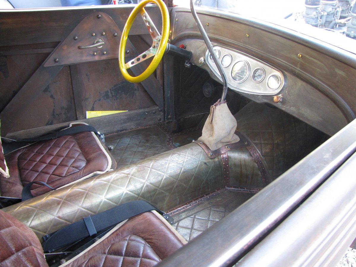

  18. Blues4U
    Joined: Oct 1, 2015
    Posts: 8,185
    Blues4U
    from So Cal

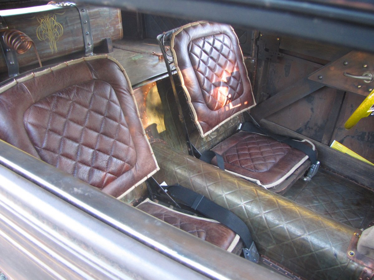

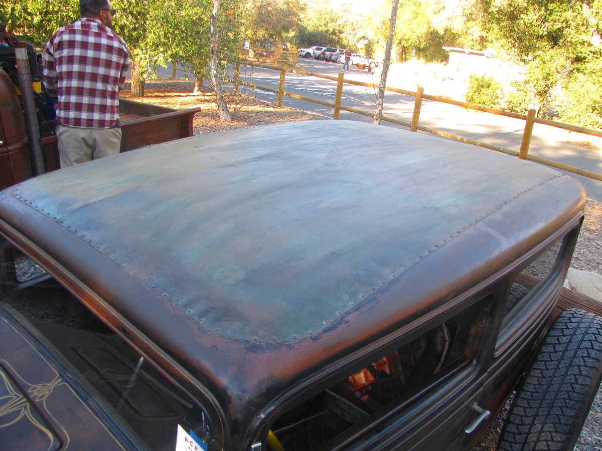

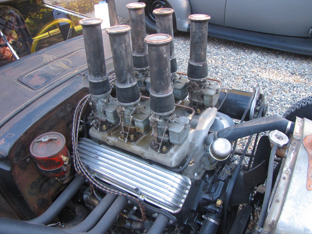

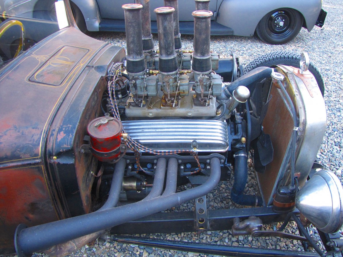

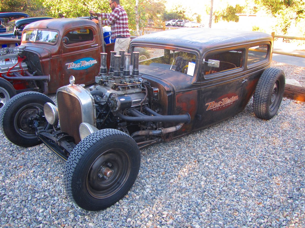

    OK, most of the guys won't like this here, and it's a bit too rat roddish for my tastes too, but I think you might like it. This car was at a rod run I was at over the weekend. You might get some ideas from it. Good luck.
    IMG_3346.JPG IMG_3347.JPG IMG_3348.JPG IMG_3349.JPG IMG_3350.JPG IMG_3351.JPG IMG_3352.JPG IMG_3353.JPG

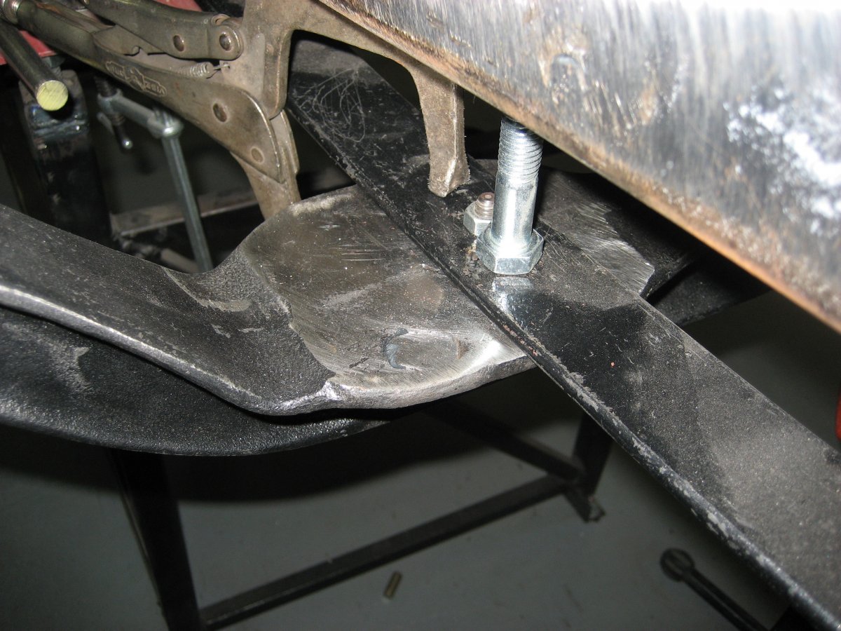

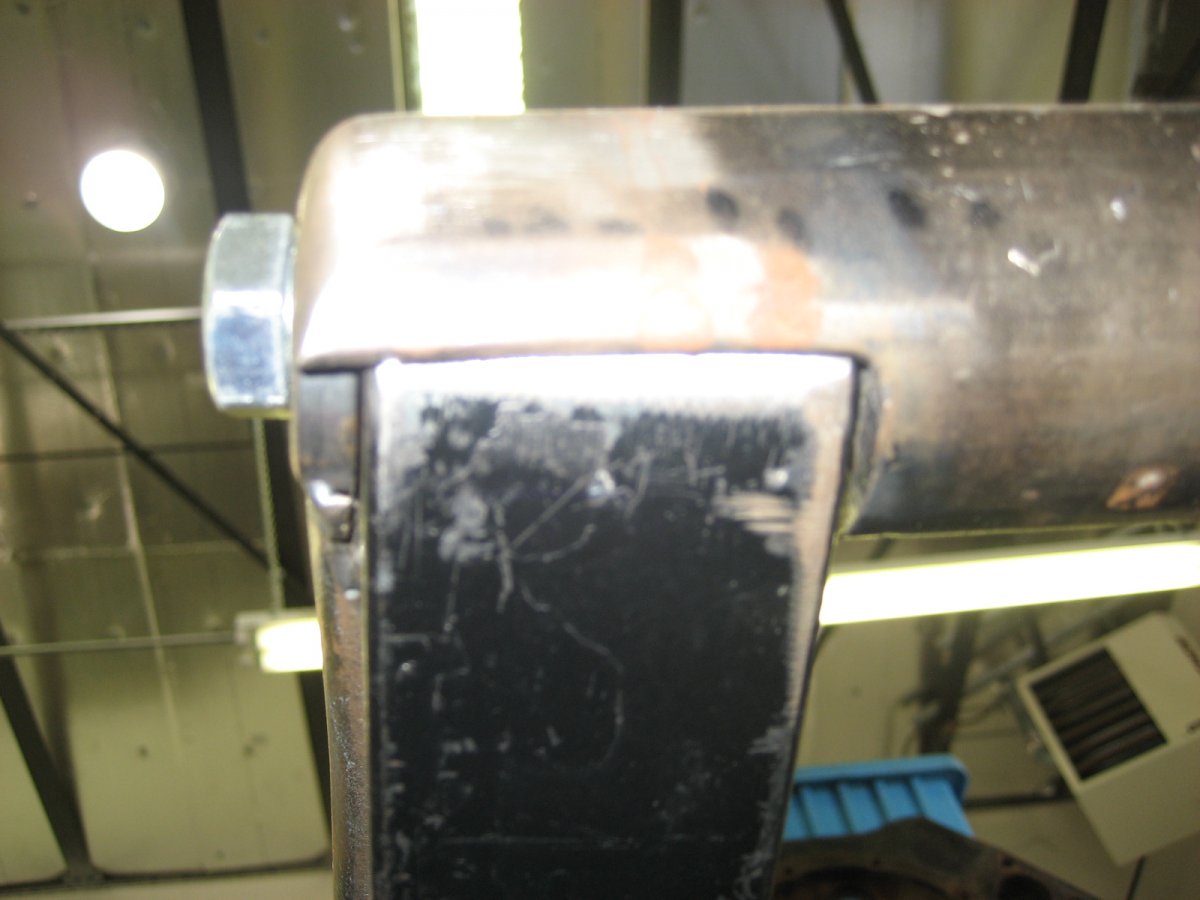

  19. r2c1
    Posts: 201
    r2c1

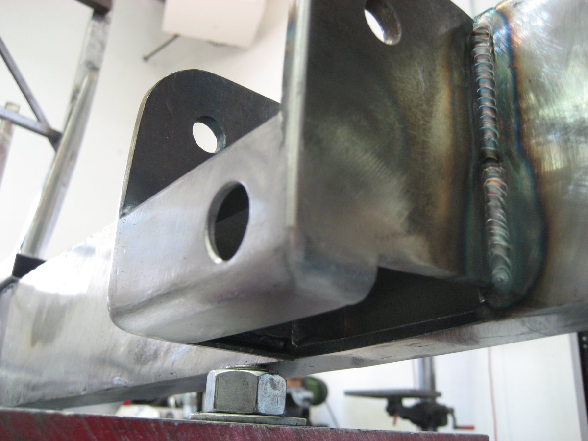

    Sorry I may have misled you on the "drag race slider". Actually spring is installed straight up into the bracket. A picture to make things clearer. You 'll notice the spring eye in the bracket and the empty space in the frame. There is a block of Delrin with a long 5/8' slot milled into it, one on each side. Spring placed in the bracket and spring eye with a poly bushing aligned to the opening. Pin, which is 1" wider than the leaf, is then is inserted leaving 1/2" either side to ride in the slot. A plug is placed to close the opening.
  20. Fast Eddie 27
    Posts: 122
    Fast Eddie 27
    goooootchaaa..! Very slick how its mounted inside the rail in the rear, and hidden in the front. I wasn't understanding as I was looking at the picture upside down ! ha! One would ***ume you could even simplify that a little (with less fab skills then you have obviously) and use a standard style shackle setup in the rear if it could be located inside the rail as it will still be partially hidden. Although with out "pinching" my front rails that geometry probably won't add up...thanks again for all the help...amazing work!
  21. Fast Eddie 27
    Posts: 122
    Fast Eddie 27
    Yeah...even a bit too rat roddish for me too! I do dig the br*** work inside and the door panels !

    Thank you very much. Your are exactly right on the shackles. Like your car and best of luck on the build. I don't always have the right answer, but will be glad to help with anything I can. Ron

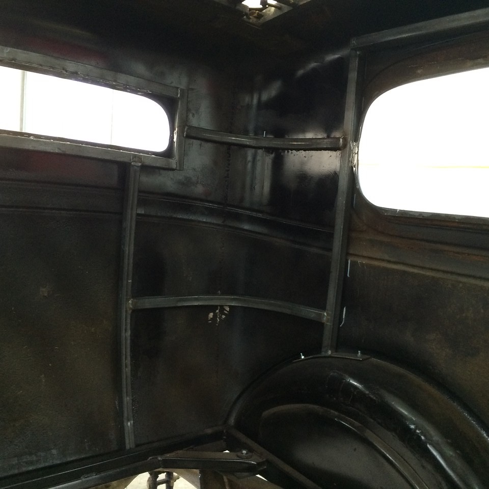

  28. DLRIDES
    Joined: Sep 29, 2014
    Posts: 130
    DLRIDES
    from Newton NC
    WOOD !
    IMO, do yourself a favor, forget the wood and build an steel inner skeleton, especially if you plan on channeling ! Takes a little more time, but well worth the effort.
    I used a Ford styled transverse/hairpin from suspension for a cleaner look.
    I would be glad to share any build information you may want or need, just PM.
    ‘32 Chevy
    biggeorge, r2c1, TFoch and 2 others like this.

  30. Fast Eddie 27
    Posts: 122
    Fast Eddie 27
    Yes! Absolutely framing it in metal. Although the wood is In great shape so I may keep it in some places and stiffen with 1by square tubing. Killer build man. Right along the same lines of my build plan. Although I have decided to keep with the Chevy front springs
