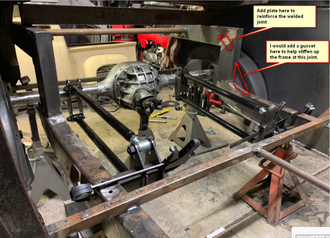

    I ended up really liking the shape the rails took. Wasn’t sure at first, but it’s growing on me. Any thoughts?
    Parallel bars are pre mades from eBay but should suit my build proper. I intend on driving this car hard.

    Looks like you channeled that body a lot. I remember you saying earlier in the thread you want it low. Did the body and cowl fit over the frame? I am going to channel my sedan 2"-3" but have not checked to see if the cowl will drop over the frame.
    My two cents...I would add a plate at the top weld in the inside and outside of the frame rail. I will also add a gusset at the bot horiz to vert joint. I****ume you are using coil overs attaching to a cross member at the upper part of the frame. If so, you will have bending forces at the vert to hoirz joint so beef that up a little. I added a sketch to go with my comments.
    Over all looks like you are building what you want which is great.
  13. Very nice work Eddie! I agree with Matt on the additional bracing, although the frame looks very stout, it can't hurt to look into it.

    Yeah it did fit right over. Some slight manipulation, but it makes it over the rails very snugly and nice. As far as the joints I 100% agree. I had originally thought to put in a cross member there at the top inner horz to vert joint but now I’m thinking plates. The outers already have plates and the joint (can’t see in pic)
    Great sketch by the way! That makes it too easy ...
    id go with a z snaped reinforcement inside the frame,with a few 1 1/2" holes weld the perimeter and around the holes

    Thanks! I agree as well with the bracing, as I mentioned, I originally intended on placing a cross member there, but now It'll get some reinforcing..I like the hole idea!
