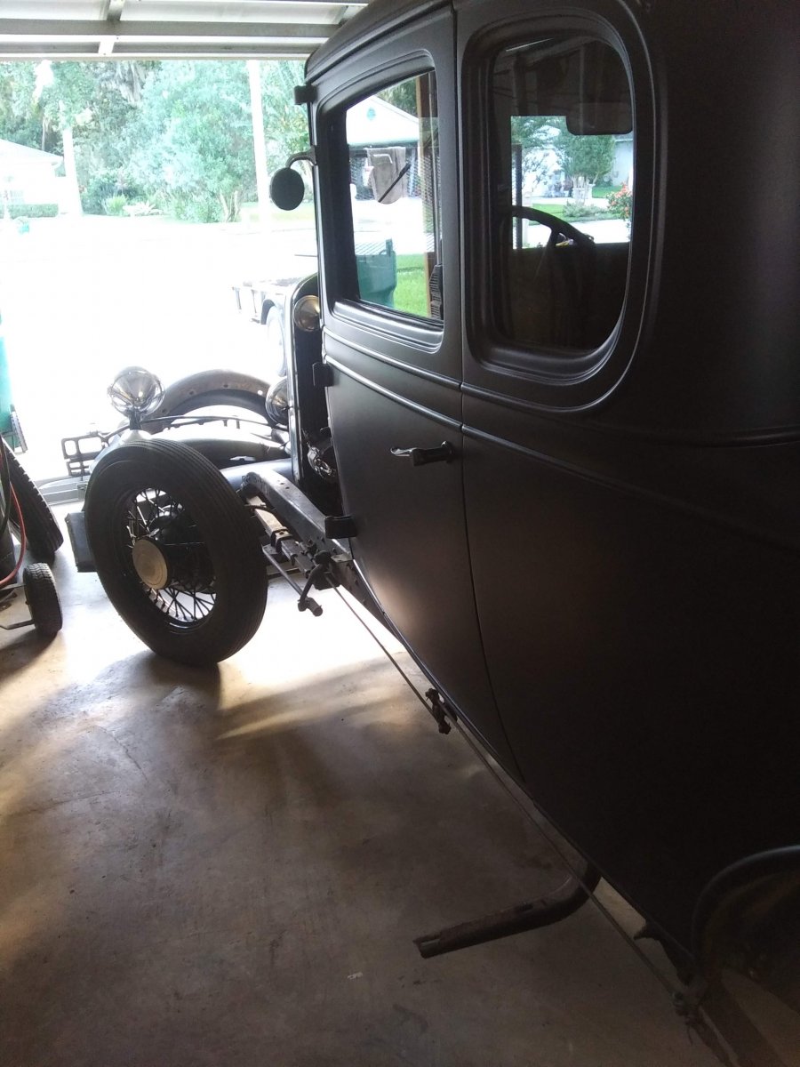

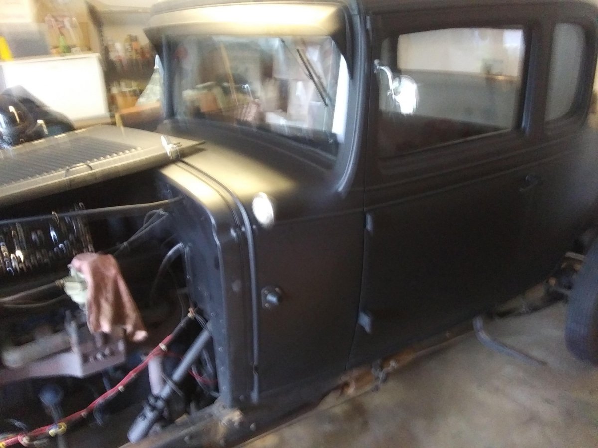

    Have it all stripped down as far as I want to go for now. I've decided to go fender less with a traverse spring front end with disc brakes. Switching it to 12 volt electrical system. Still want to keep the 6 cylinder engine and 3 speed ****** stock. That may change but for now want to keep it a driver while I'm working on it. Anybody have any recommendations on a transverse front end that will fit under this car? Would like to keep it Chevy but not opposed to any ideas. Also what later model Chevy rear ends fit . I heard s-10 will work? 20200930_084804_Burst05.jpg 20200930_084843 (1).jpg

  2. Changing the rear end will lead to driveshaft problems as the s10 is an open driveshaft and your original is closed . Use a 53 54 truck front axle and you will have bendix style brakes and a truck axle is also dropped 2 more inches than a car axle .

    Why? 1951 up Advance Design Chevy or GMC 1/2 tons used parallel leafs front and rear and had Bendix brakes.
    "Would like to keep it Chevy but not opposed to any ideas."
    By going to transverse springs you are basically trying to make this car a Ford. Why not sell it and just get a Ford?
    You actually have an advantage by keeping the parallel springs. Going to transverse actually makes more work for you. It's pretty much like stuffing a paper bag full of cash down a cannon barrel and lighting the fuse.
    Parallel semi ellipticals front and rear is one of the things that make a Chevy a Chevy, just like the wood and just like the stove bolt 6.

    You want it all Chevy but transverse front end? Seems like mutually exclusive terms. What you have presently looks to be in good shape anyhow.

    A) buggy springs are as old as the hills they aren't Ford or Chev they come from old wagons originally... B) he never said he was going to use a Ford axle... Trans leaf with a suicide mount has been around since racing started in the '20's and was not exclusive to any one make of car...:rolleyes:
    ...get one of those flattened model A style crossmembers weld it in behind your rad then use a spring behind set up with the above mentioned fact. dropped '52 truck axle, notch your frame horns...that will put her in the weeds a lot lower than a parallel leaf set up can...but you will also need to add radius rods to mount the spring etc.
    ...for the sake of argument reversing the spring eyes, de-arching and removing some leaves in combo with the '52 axle will get you fairly low too and no welding
    ...take off the front 6 -8" of your torque tube and driveshaft (or a parts one) and weld it directly to the plate where it used to "swivel" at 90* then find a seal that has the ID of your shaft and OD of your torque tube ID weld on a yoke now the slip yoke is inside your new tailshaft... voila instant open drive conversion
    ... forget o/t $-10 stuffo_O ...what about a '55 Chev rear? if you use the '52 front drums and '55 rears you won't need discs

    Wicked cool car man! I would drive the hell out of it and modify it when time/money permits.
