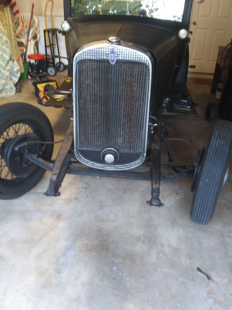

    The journey begins with this 31 chevy coupe. Any suggestions on front end ideas..brakes, axles, light and shock mounts would be helpful. Message_1601160313301.jpg

    probably depends what you want to build. If you're aiming for a traditional hot rod that might have been built in the 50s see if you can find some 1940s/50s chevy trucks to donate parts. The 51-59 truck brakes work well up front, the rear end from a 55-59 truck might work as well, and you can also use a 41-46 truck front and rear axles, with the later brakes and some other parts. The 1950s-early 60s 235 and 261 Chevy sixes are a good starting point, as well as the same era GMC 270 and 302.
    But you could also do a lot of other things with it, like putting in a V8 from a 50s-early 60s GM car, such as a Cad, Olds, Buick, Pontiac, or even Chevy.
    Kind of depends what you want, and you didn't offer any clues about that. Nor, where you're located.

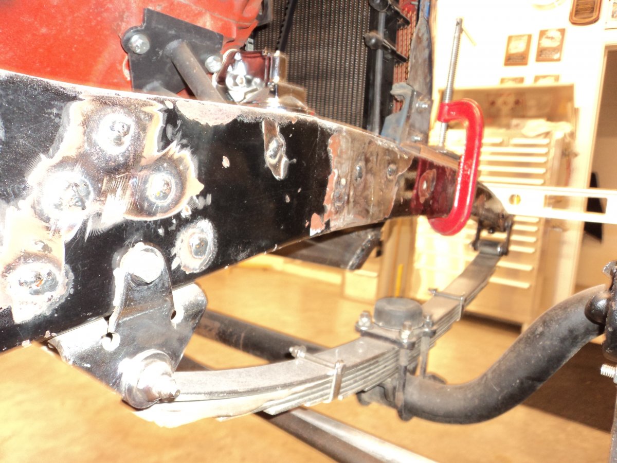

    Its a 6 inch drop front axel that I bought years ago from Butches Rod Shop. Not sure if you can still get them, it was ordered 2 inches narrower than stock. Works, handles and turns good and will fit under the stock fenders. DSC01079.JPG
