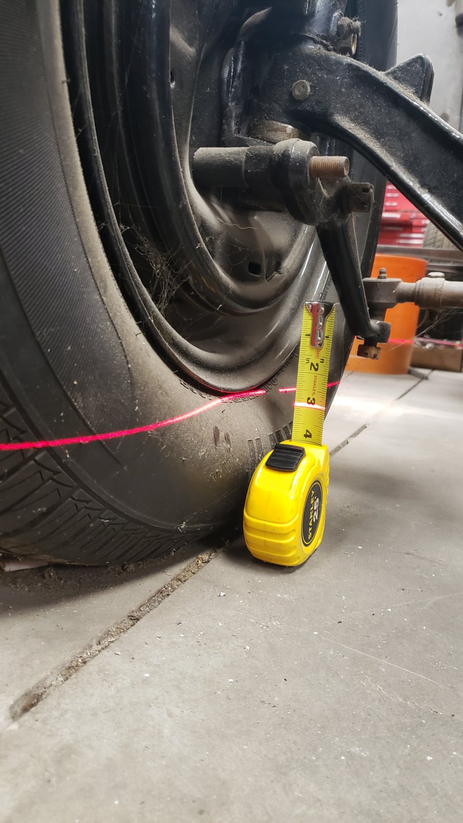

  11. I am starting to think there is a question here !!! And he may have been concerned about his scrub line . Maybe , hopefully he is just in mock up ...
    I am currently putting a 4 inch drop axle in my 33 chev ,but I dont think I can keep the axle above the scrub line unless I use a pre war rim .
    armymike and Stogy like this.
  12. I have a 52 axle in my 34 chev truck , pretty much the same axle other than king pin size
    Once I took off the 19 inch rims and put on 15 inch rims ,it leaves me about an inch and a quarter above the scrub line .
    If I put in the 4 inch drop axle it will put me at or below the scrub line .
    Have some serious measuring to do .
    The only way to correct this is to use a larger rim and tire .
    Oh Boy !!!
    Spoggie and guthriesmith like this.

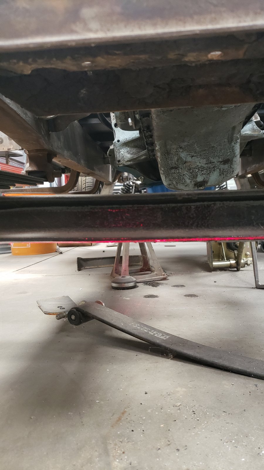

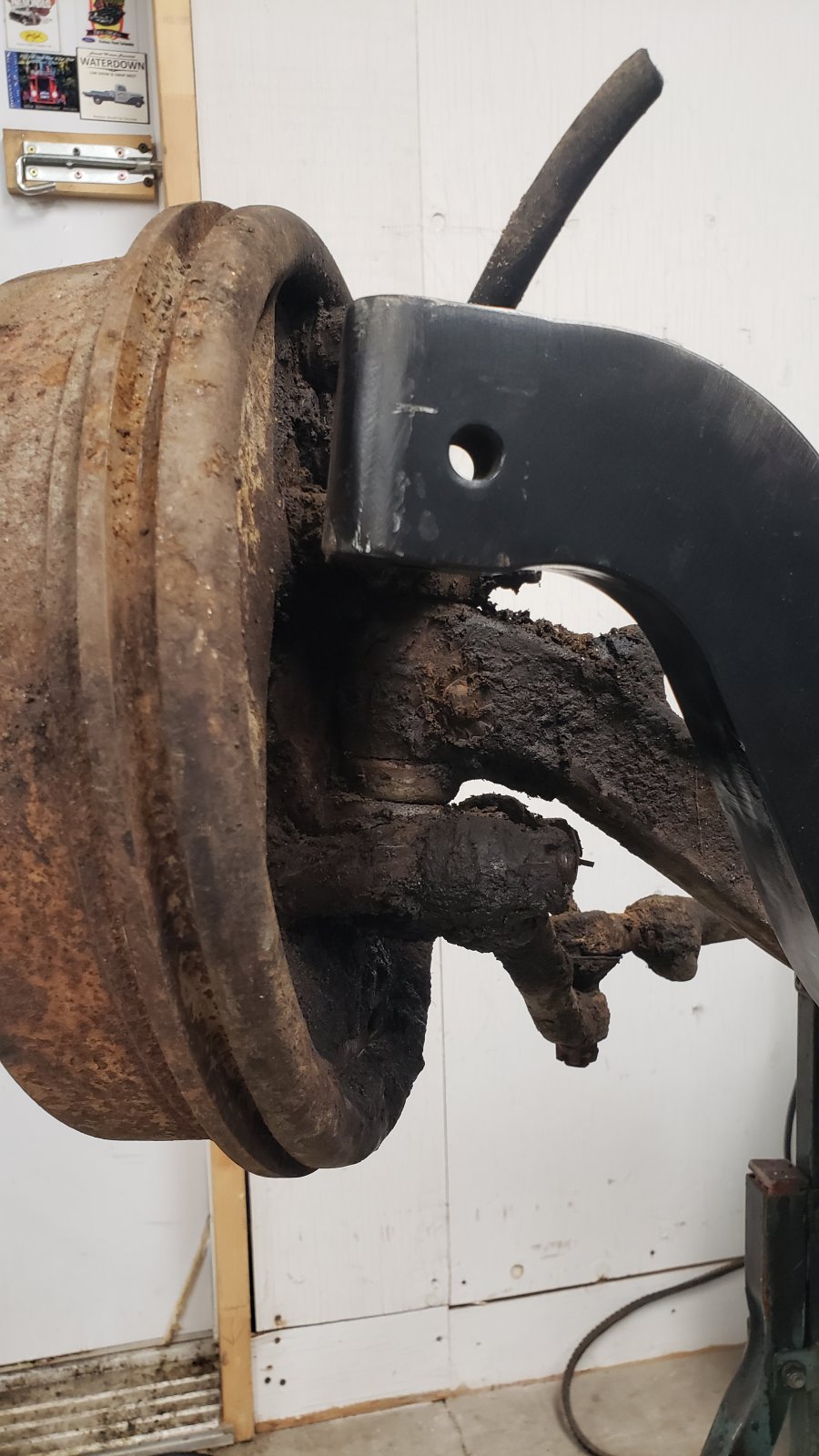

  15. With some measuring this morning , as I am installing an chevrolet axle in my 33 chev .
    The axle has a 3 inch drop and with 15 inch rims it will hit the scrub line . Might gain 3/4 of an inch as long as the flat tire stays under the rim !!!
    Anything much greater than a 4 inch drop is pretty much a no go .
  16. This is a 52 front axle in my truck , it is I identical to the 34 axle other than larger king pins and heavier tie rods and drops .
    With the 52 axle you can see I have 3 inches of clearance, if I install the 3 inch drop axle ,I will be sitting on the scrub line . The tie rods are already below the scrub line with the stock axle. The laser is set at the bottom of the axle for all pictures
