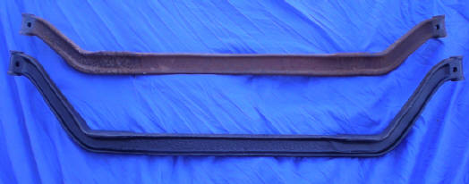

    :rolleyes:...I believe this is the Axle the top being stock 46-47 Ford...they didn't mention the drop but it matches the Chev counterpart at 4" drop to stock and has the I beam shape the Chev doesn't...
    @guthriesmith anyone who hung around here since 09 knows we are an excitable bunch...so chime in and let us know what's up...maybe he didn't ever look at the Hamb since 09...dunno...but one has to have a bit of give for the kinder, gentler Hamb as it's often referenced these days...
