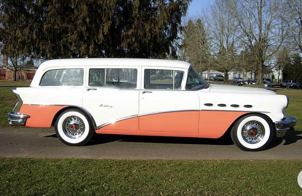

    [QUOTE="someone mentioned the Wagon, it is a strange model as that rear side door is extra wide...what is it ?
    [/QUOTE]
    Looks like some special body type, flower car?
    Some type of funeral car?
    Different rounded rear top corner at the roof

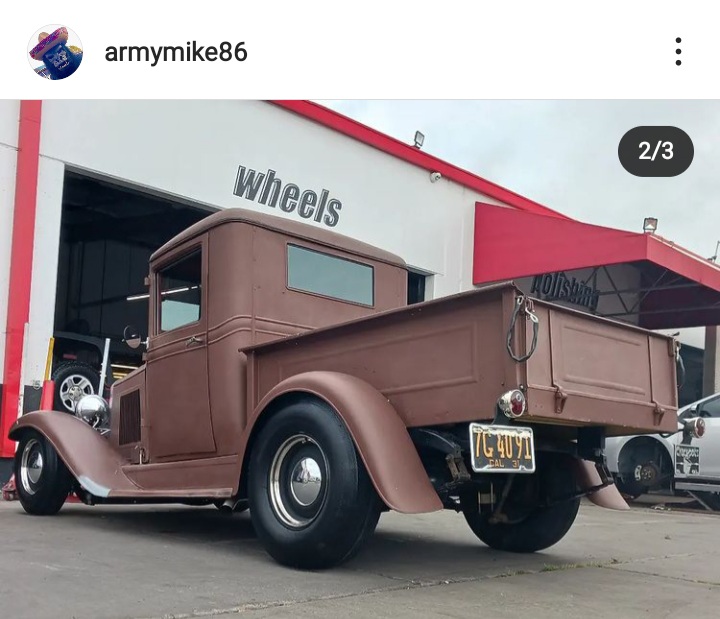

  3. Mr48chev
    Joined: Dec 28, 2007
    Posts: 36,515
    Mr48chev
    That wasn't a 46 or so jail bar F-1 sometimes known as Hound Dog that was bought out of Washington state? The guy who put that one together hung the springs under the axle to get it low and there was no way those springs were above the scrub line.
    Thing is with the 34 truck in question a taller set of wheels and a lower profile set of tires gets it past the scrub line issue for inspection but the stacked nuts on the tie rod to steering arm thing shouldn't p*** any inspection anywhere.

  9. Fordors
    Joined: Sep 22, 2016
    Posts: 7,051
    Fordors
    Different rounded rear top corner at the roof[/QUOTE]
    ‘56 Buick Estate wagon.

  11. upspirate
    Joined: Apr 15, 2012
    Posts: 2,303
    upspirate
    ‘56 Buick Estate wagon.[/QUOTE]
    That sure does look like the primer-ed wagon! Same roof line

  13. guthriesmith
    Joined: Aug 17, 2006
    Posts: 13,229
    guthriesmith
    I believe that a 39 axle is basically the same (maybe different hole size for the u-bolts). The only difference is that yours is dropped as best I can tell.

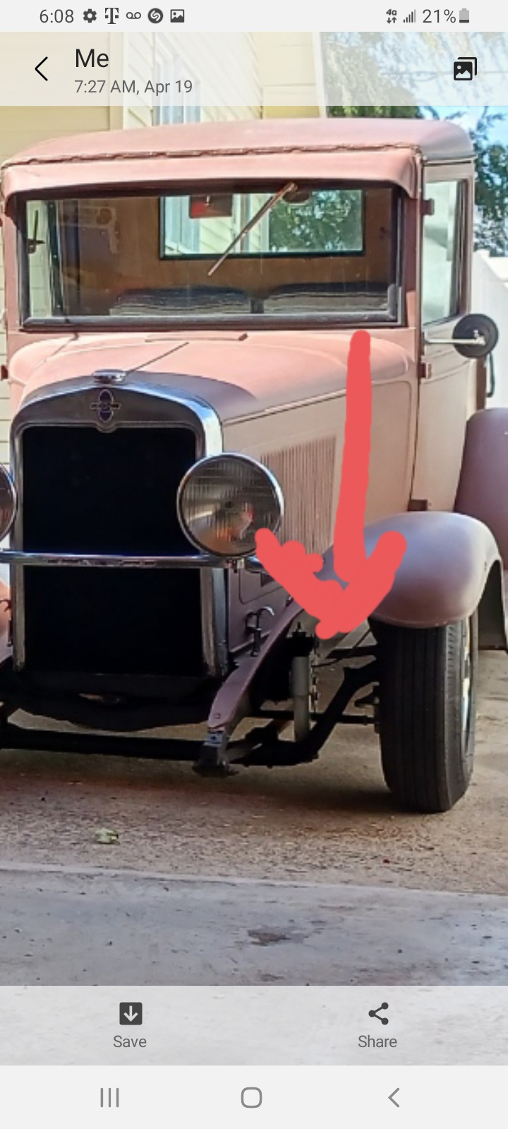

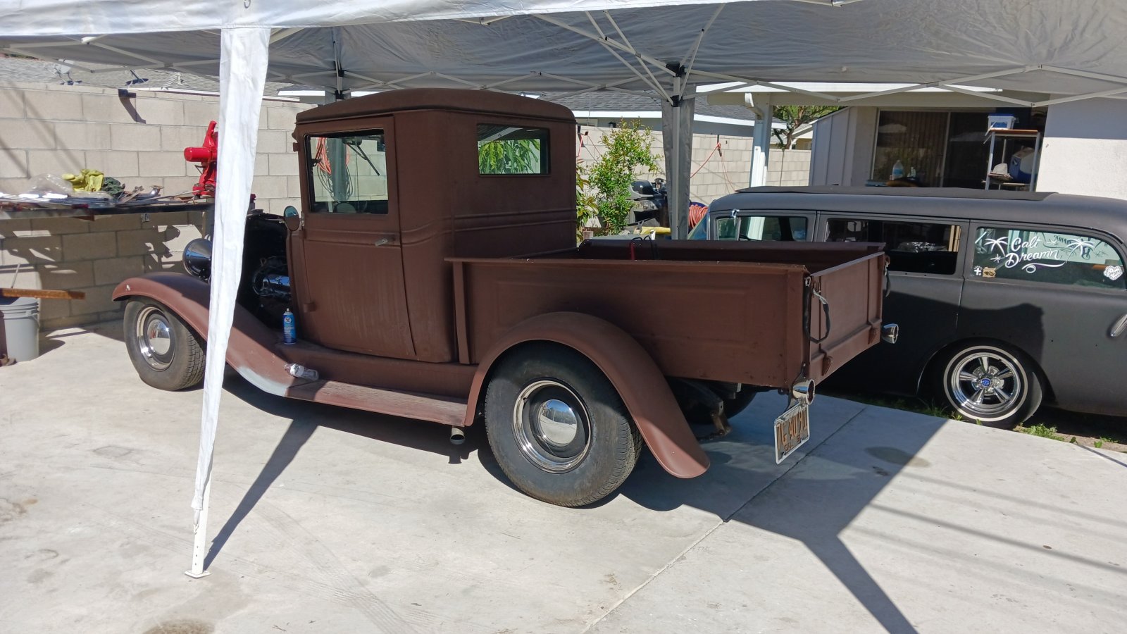

    I traded a car for this truck then realized after the fact. Trying to figure out how to resolve this.

    It is mine. I traded a project car for this and a friend brought it to my attention. Trying to figure out a solution

    I had just acquired the truck in trade when a friend told me of the danger that I didn't realize. I posted the photo and forgot about the post when a friend came across it. I bought new tires and still haven't found a solution. There are some good suggestions

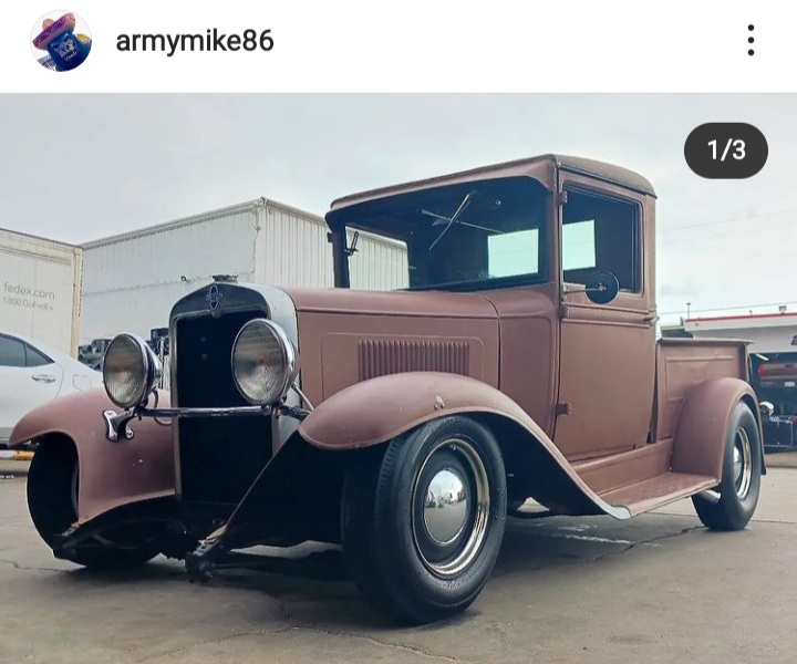

    I just realized this post drew alot of discussion. I traded a car for this truck and a friend pointed out this dangerous issue. That's when I posted it. I haven't resolved the issue and am still searching for a solution. I discovered www.droppedaxle.com yesterday and working on a fix.

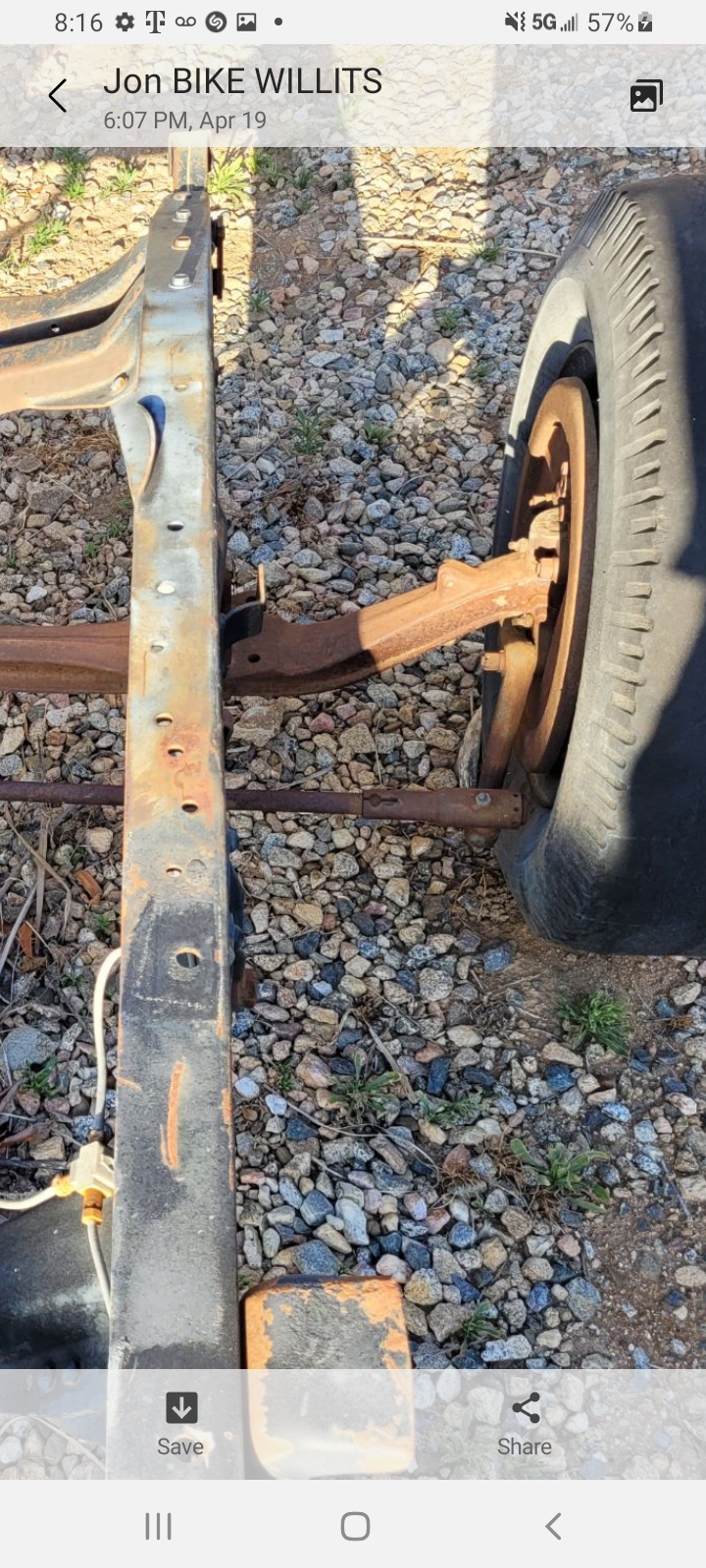

    I think it's a 39 ford axle
    Stogy and guthriesmith like this.
  21. manyolcars
    Joined: Mar 30, 2001
    Posts: 9,608
    manyolcars
    NOT a 39 Ford axle. Might be a 46/47 Ford pickup axle

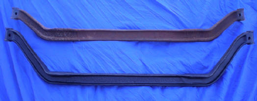

    I still need to take dimensions and get with droppedaxles.com wish they did 4" drops but they only do 3"

  26. Well, you're on the right track now. Give ALL the details that Sid's asks for, answer ALL the questions they ask, follow ALL suggestions they offer, and you'll be OK. And so will the people on the road with you. Good luck

    First let me say I really like your truck. For my taste it sits to low in the front. But because of that I would have crawled under and found the issues. I may get thrown out or tarred and feathered, but I think a really good blacksmith could help you out. At least with the axle and probably with the steering arms also. I think a good blacksmith could shrink (?) that axle. Hell I don’t even know what the proper term for lowering the spindle would be. Undagoing, dedago, dedagoing. Somebody help me out here. Please?! Then after they did the deed/procedure they could reheat treat it properly.

    Yep, love the look of your truck and Sid at Nostalgia Sid’s Dropped Axles www.droppedaxles.com should be able to help you get it worked out. Give him a call at 405-416-3080
