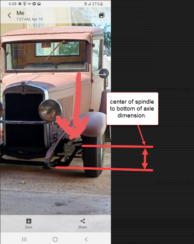

    Someone a few pages back mentioned a caster wheel hanging down just below the axle, is that really a terrible idea? I suggested a skid plate at a 45 deg angle in front of the ubolts, so it would skid more smoothly and not dig into the road. Maybe a little less sketchy than it is now? Sure would hate to see that truck lose its look the stance makes it.

    That is very nice of you. I live be the Fullerton Airport. I could use help with Sid's dimensions he's requesting.

    I think if you measure from the outside of one spring to the inside of the other spring, this will give you the center to center pad mount that Sid needs to figure out what axle you have/need.

    14s front with 695-14 bias ply which I gained turning radius because the bias plys are narrow than the previous radials. Rears AR L78-15s. When I bought tires a couple weeks ago, was going to buy 15s but wouldn't have made a difference. Even 16s wouldn't fix the scrubline problem because the tire is fairly close to the fender inside.

    Maintaining the ability to steer the car if a tire blows is what scrub line is all about.

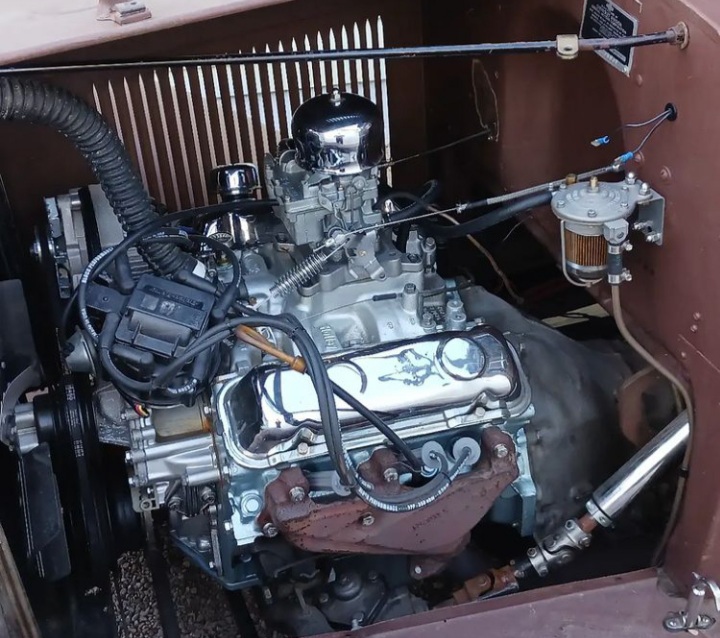

    A 1986 Buick V6 automatic transmission

  20. Budget36
    Joined: Nov 29, 2014
    Posts: 15,444
    Budget36
    Wouldn’t be too bad of a looking engine if a smaller distributor/cap was available for it.
    Beanscoot and Stogy like this.

  22. SS327
    Joined: Sep 11, 2017
    Posts: 4,190
    SS327
    That engine should not be off topic considering Buick and even American Motors has been using that engine since about 1962. That’s how old the odd fire v6 Buick is.

  23. Stogy
    Joined: Feb 10, 2007
    Posts: 27,368
    Stogy
    I didn't know that...so are you saying this block shares a visual likeness much like the Chev V8s to their vintage counterparts...regardless it belongs in the Hokey Forum as it's inspired...to it's vintage counterpart...
    Can you run a vintage distributor in that engine to lose that modern thing?
    SS327 likes this.
  24. SS327
    Posts: 4,190
    SS327
    Boy your asking me to remember almost 40 years back when I worked for Buick. If that truly is an 86 engine it would have had an ot ignition in it. The odd fire and even fire engine look pretty much the same. Odd fire engines from 62-77 distributors interchange. Even fire is different 78-85 after 85 it was all crank sensors and coil packs. Difference between odd fire and even fire: crank, camshaft, valve covers and firing order. There may be more but can’t remember, I tried my best to forget those things but still have nightmares. In 1988 when they redesigned it again it went from my most hated to most loved engine. A 45-65 thousand mile motor to a 200,000 mi engine. Would go even more if at 180,000 mi you just replaced the timing chain. That’s when the plastic started falling off the cam gear.

  27. Dick Stevens
    Joined: Aug 7, 2012
    Posts: 4,167
    Dick Stevens
    You definitely don't want anything skidding as that would make steering with one tire still up not likely to work well!
    SS327 likes this.
  28. twenty8
    Joined: Apr 8, 2021
    Posts: 3,873
    twenty8
    The whole idea of 'scrub line' is that if you blow a tire, or even if the tire comes completely off the rim, you would still have both wheels contacting the road before anything else. This will give you the best chance of still being able to steer the vehicle to a certain degree. If the axle (or any other part of the undercarriage) hits the road surface, and keeps one or both wheels in the air, your chances of pointing it anywhere sensible are going to be slim. Think hockey puck, at speed .....:eek:

    @armymike
    I am building a 31 Chevy 2 Door Sedan and am planning to add a dropped axle. Can you measure from the center of spindle to bottom of axle? If it works with the wheels I'm running (16") and you are interested in selling the axle, I would be interested in taking it off your hands.
