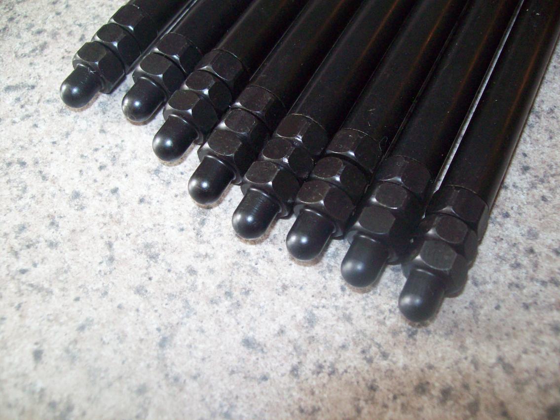

    I also picked up a set of fully adjustable push rods. I needed these because of the cam I'm running. Stock pushrods wont be long enough..

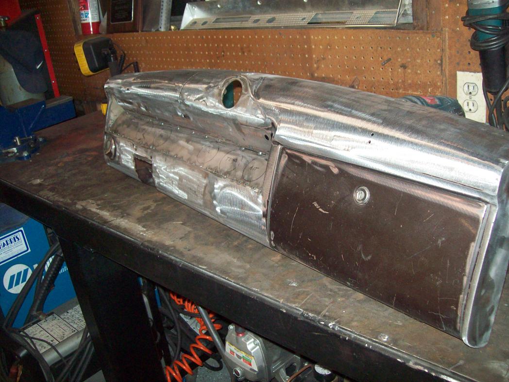

    Got a good days work in the shop

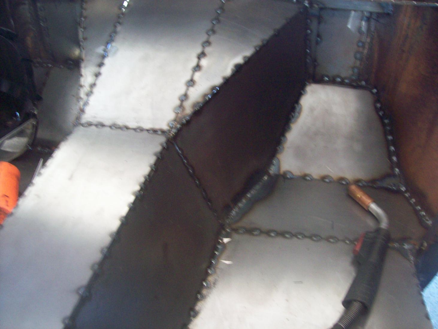

    completed the front half of the floor pan, started on the dash and valve covers.

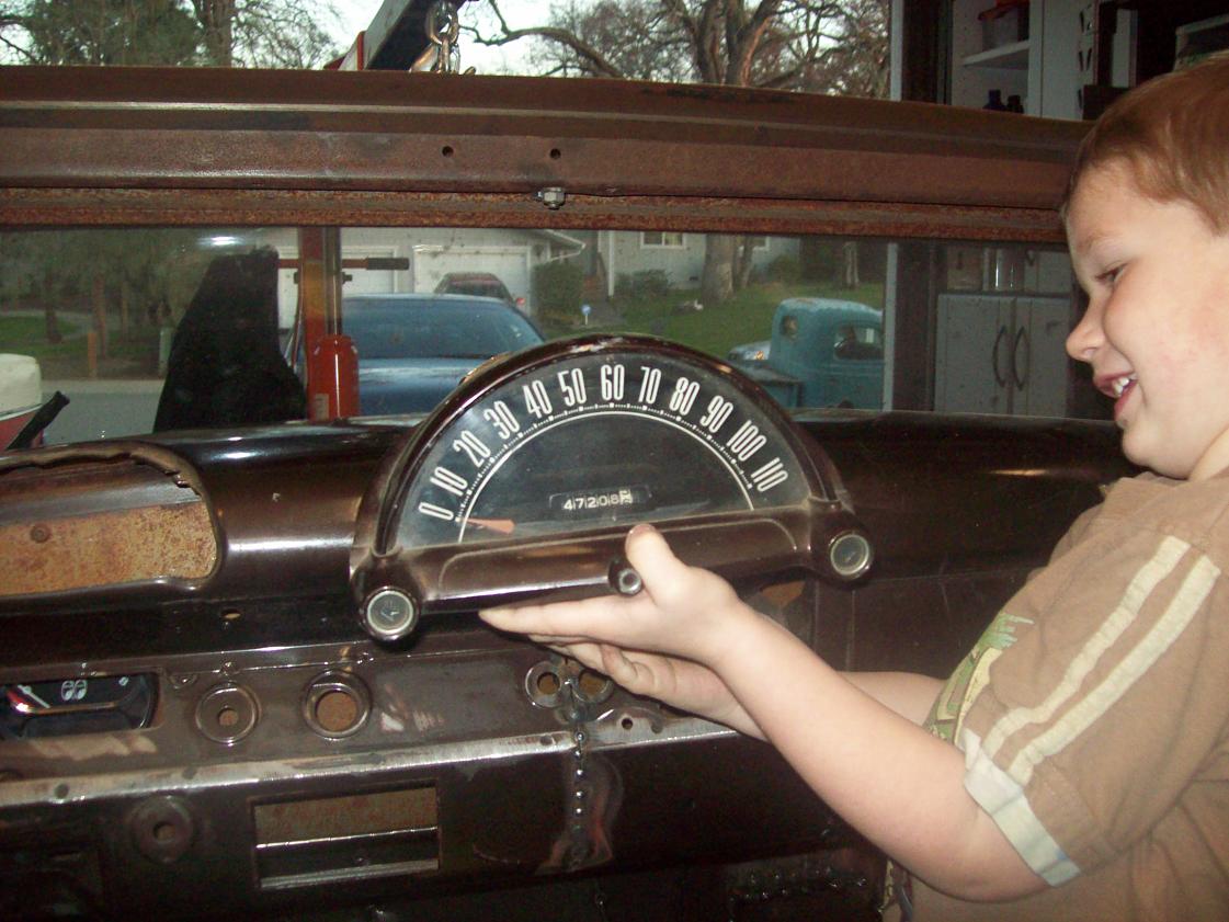

    I soon realized that the 54 ford DASH IS HUGE.. Even cut down and with the *** chopped off, its HUGE. I really wanted to center the speedo, but it wont work as it's designed to be offset. In order to get the dash low and far enough back, I would need to lose the speedo soooo I'm kinda of up in the air with it..
    Floor turned out good though..

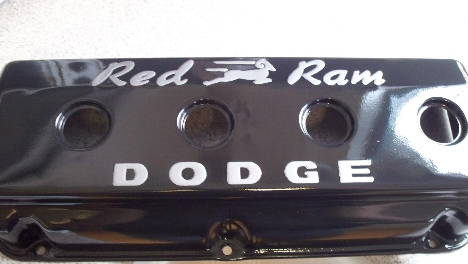

    The covers turned out like ***.
    I used rustoleum "HAMMERED" paint which is REALLY thick and when i peeled the tape off, it tore the **** out of the paint.
    I'm going to blast them again and use silver paint for the letters and black for the covers. Should work good... Your method is for sure the way to go....:D Just need to take your time.. There is NO WAY THE DA method would work on these. The letters aren't raised enough
    Thanks again MANG

    don't get frustrated i had to redo mine also the paint had a weird reaction and started to crinkle the first time ! i let them dry for a day before removing the tape seemed to peel away nice , try to pull the tape straight with the edge so it comes up without pulling on the paint edge !

    worked on the VC's and dash a bit
    Not sure if i will be able to fit the monster speedo now and this will need to be a weld in dash.. I really like the way it's taking shape now.. Lower and pushed back

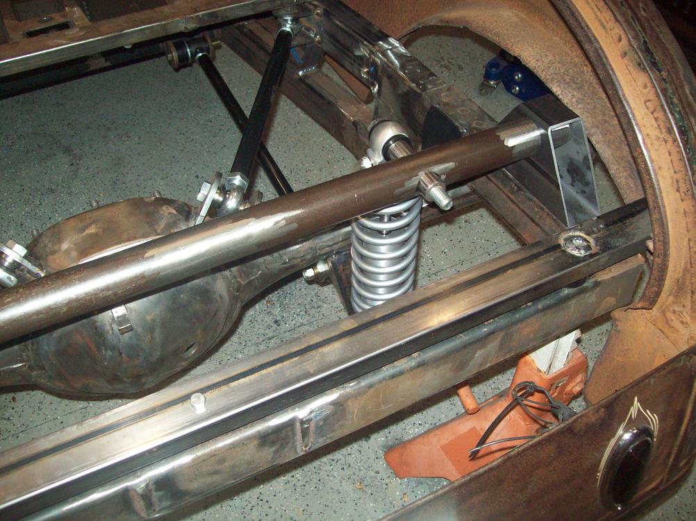

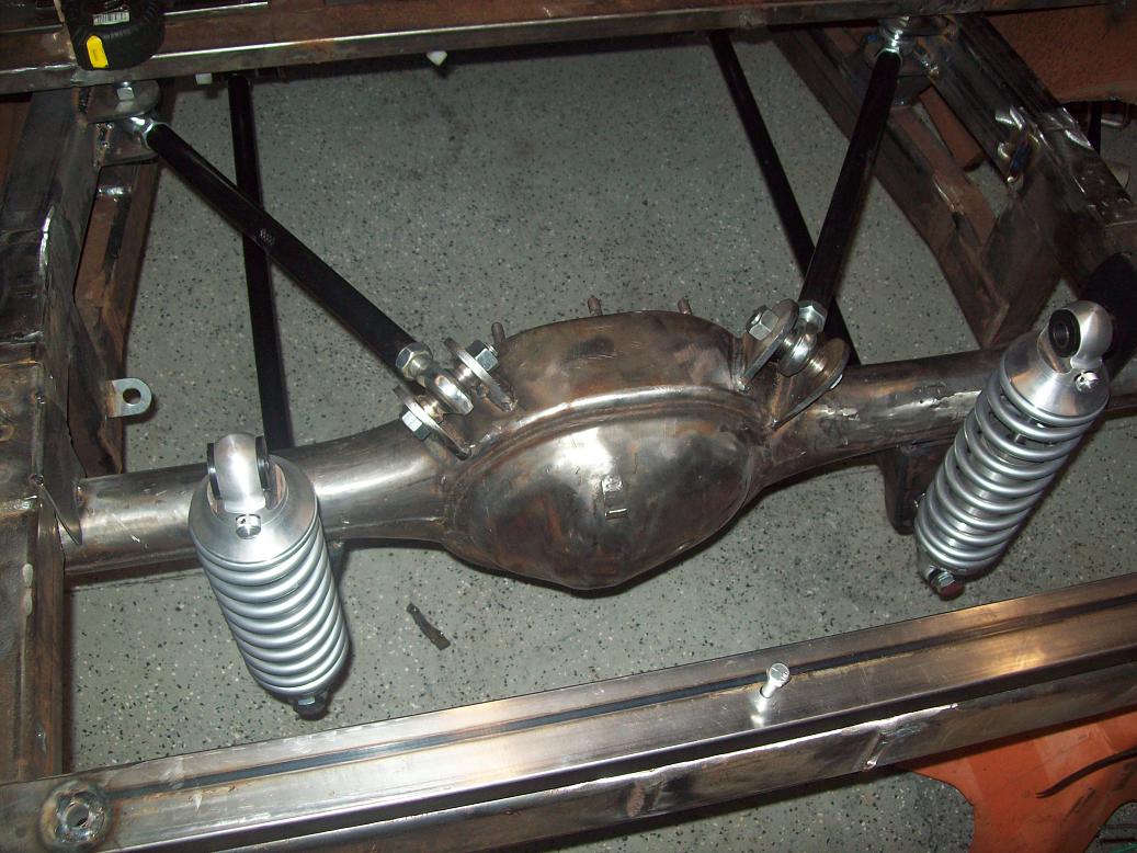

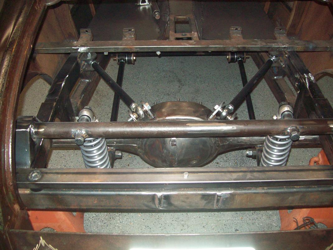

    rear coilover mount mocked up..
    Tomorrow nights agenda
    - Plate frame mounts
    - Weld and attach coilover mount
    - Cycle Suspension
    - Pull housing and weld lowers up
    - Start pulling 4.11 diff out of my 55' swap with the 3.56 posi I have

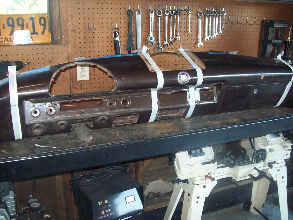

    got back on the dash tonight
    Also decided on my paint scheme.. (for the time being)
