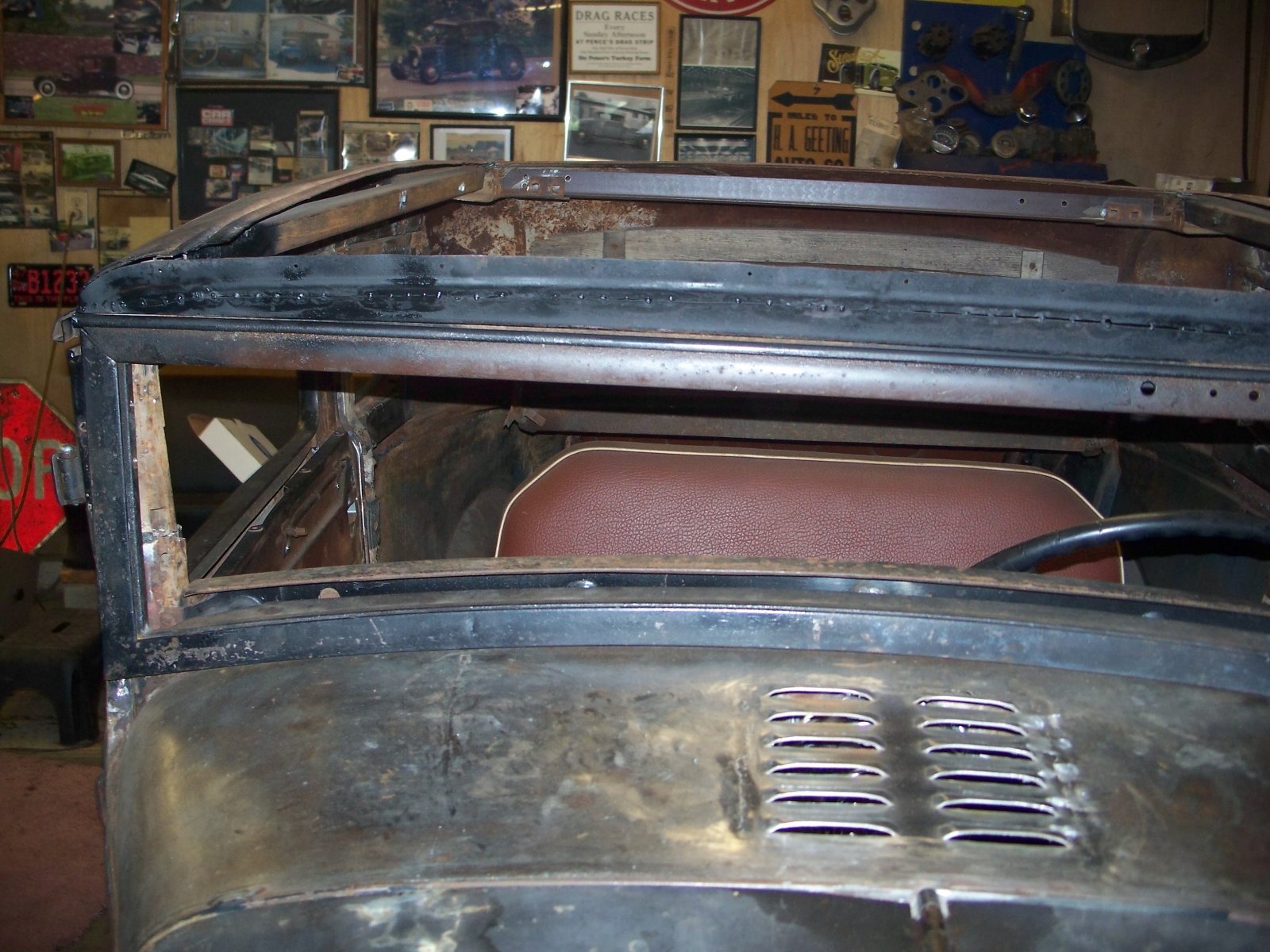

    Very nice
    I'd like to see how you went about raising the header, I'll bet it would help quite a bit. Really like the chop.

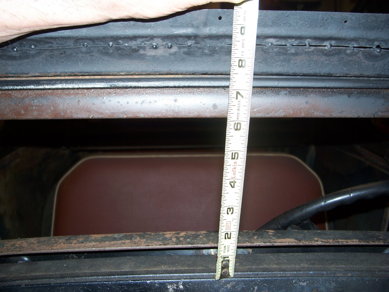

  27. Can I ask what the windscreen measurement is from the top to the bottom or vice visa across the narrowest opening please as we have a limit here in New Zealand we can chop our roofs but I do like yours extremely well.

  29. scrap metal 48
    Joined: Sep 6, 2009
    Posts: 6,128
    scrap metal 48
    header 001.JPG header 002.JPG With a 6 1/4" chop the windshield height is 6".. I am not finished with the header yet, but basically got rid of the header wood and laid 1" angle about 1" above the A post and drilled holes in it to mount windshield to, giving me the 6" windshield height...

  30. Rehpotsirhcj
    Joined: May 7, 2006
    Posts: 1,541
    Rehpotsirhcj
    I like it. Thanks for the photos.
