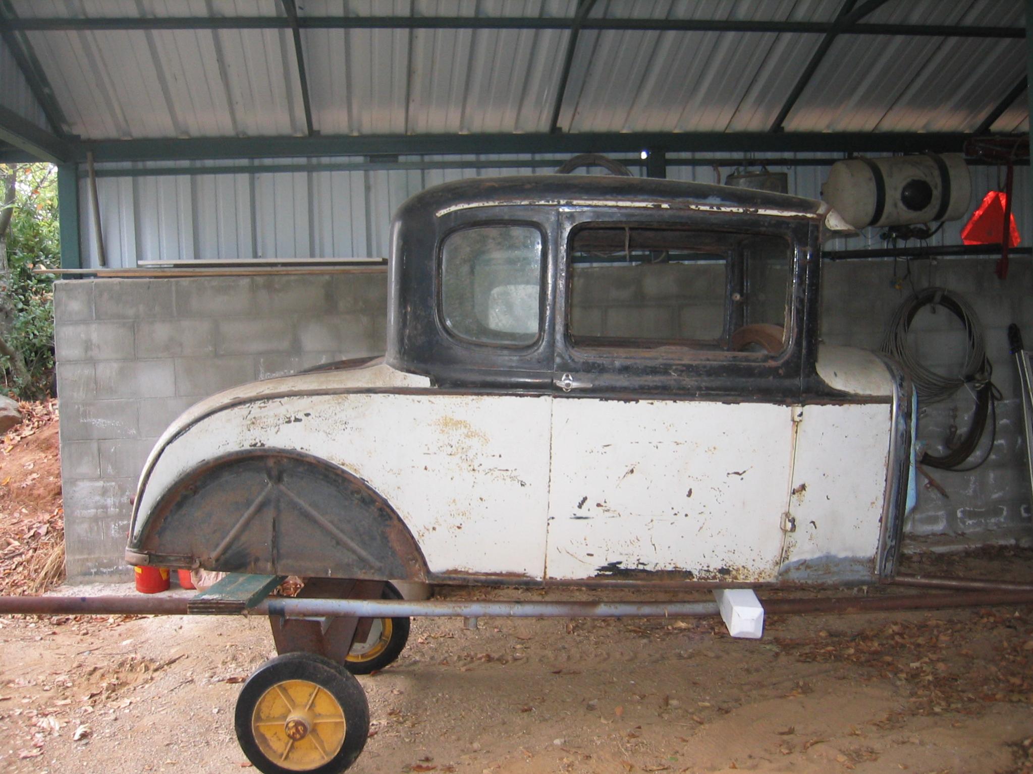

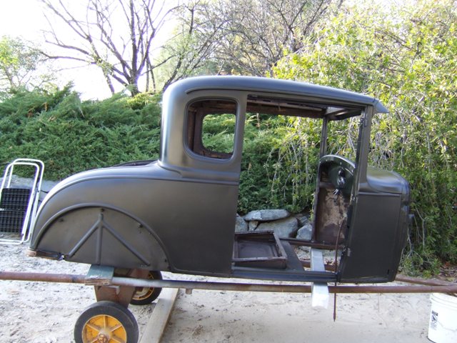

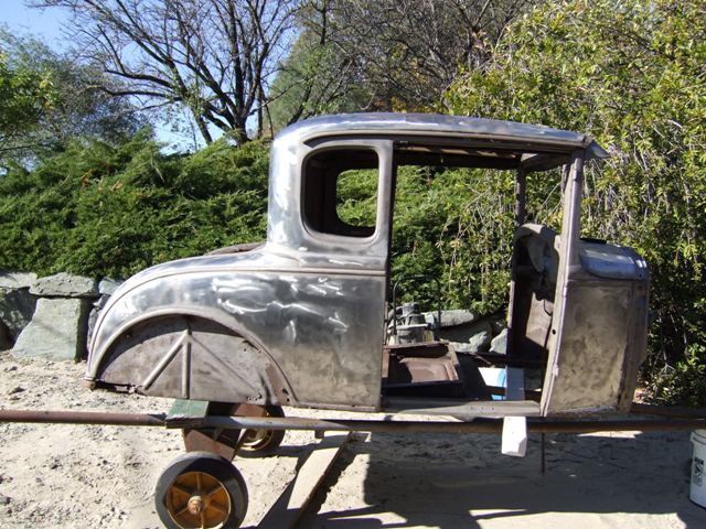

    Used a few paint stripping pads and a pile o' sand to clean the two-tone house paint off (as cool as it was!)
    Then hit it with some DP90 (I guess I subconciously knew this project was going to take a while....)

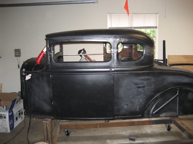

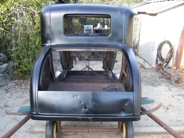

    Step 1: Chop 5.5" out of that top!
    It came out pretty good for a first chop, if I do say so myself! Theres still to this day some welds, hammer and dolly work, and leading to be done.....

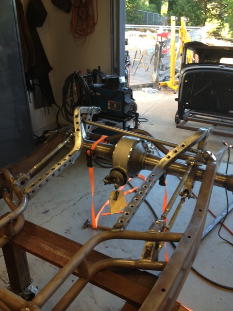

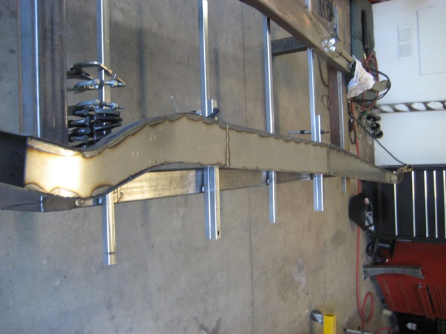

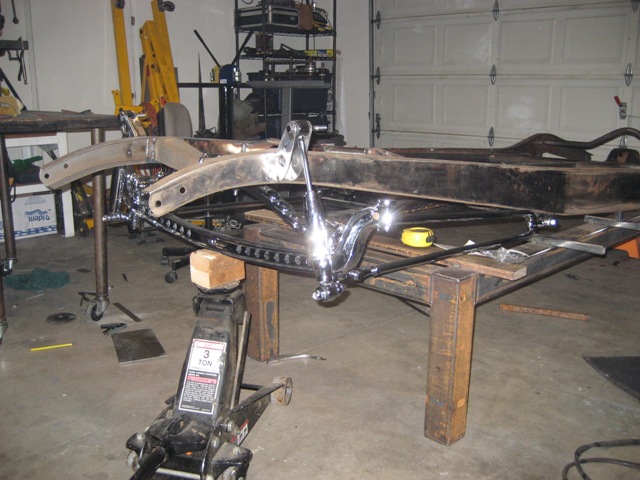

    I got some '32 rails from Turlock, boxed 'em, pinched 'em, and started on the cross members.

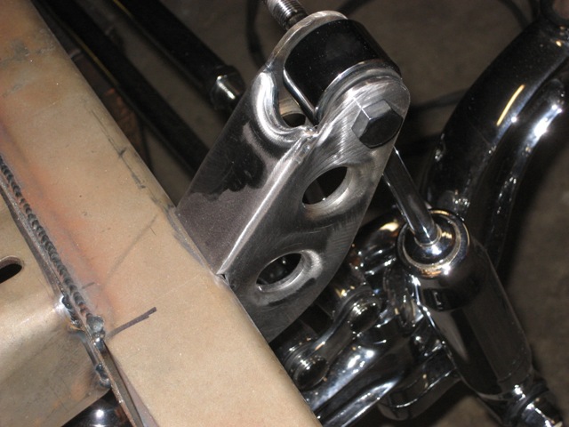

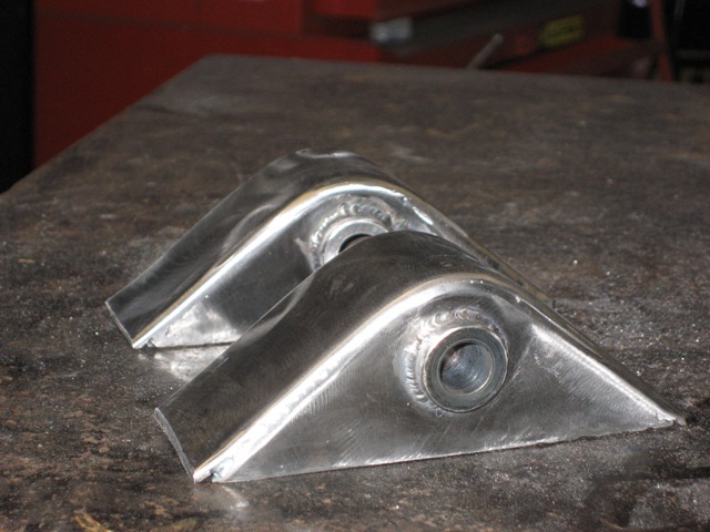

    Then made some shock and hairpins mounts, and test fit the front suspension.

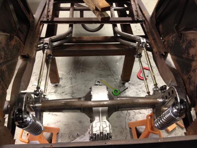

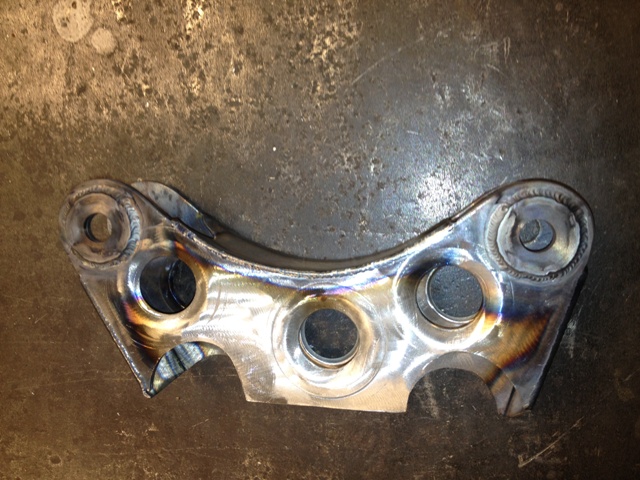

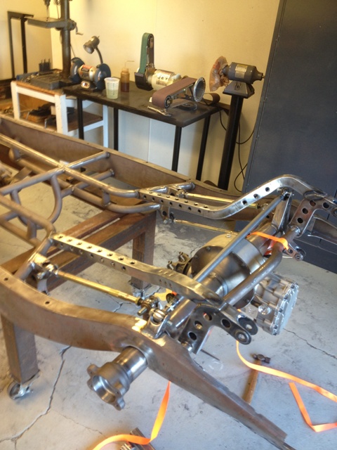

    I got one of those winters quickchanges with 9 inch guts, and spent way too much time making a bunch of brackets.
    Then I decided the shock mounts needed bracing.
    The braces still need some support between them at the lower bend. I'm going to mount an old keg on top of them as my gas tank.

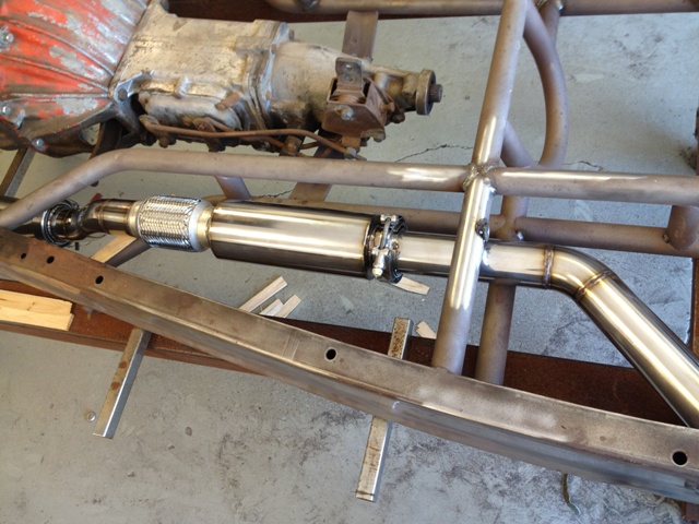

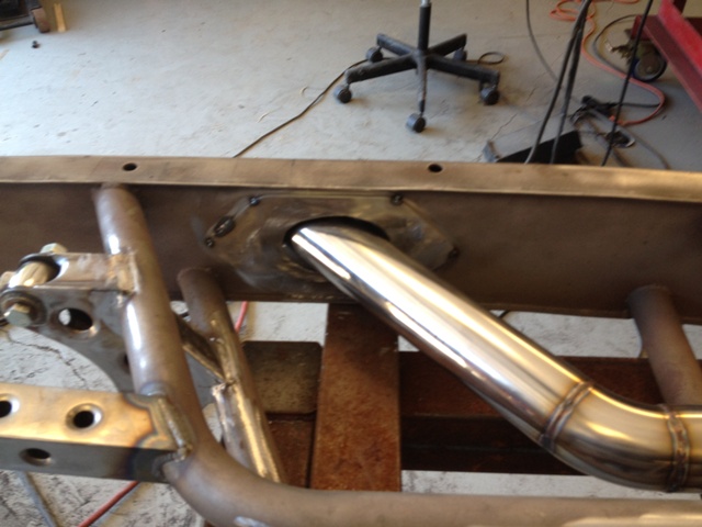

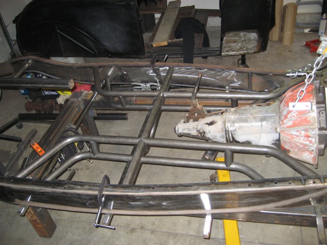

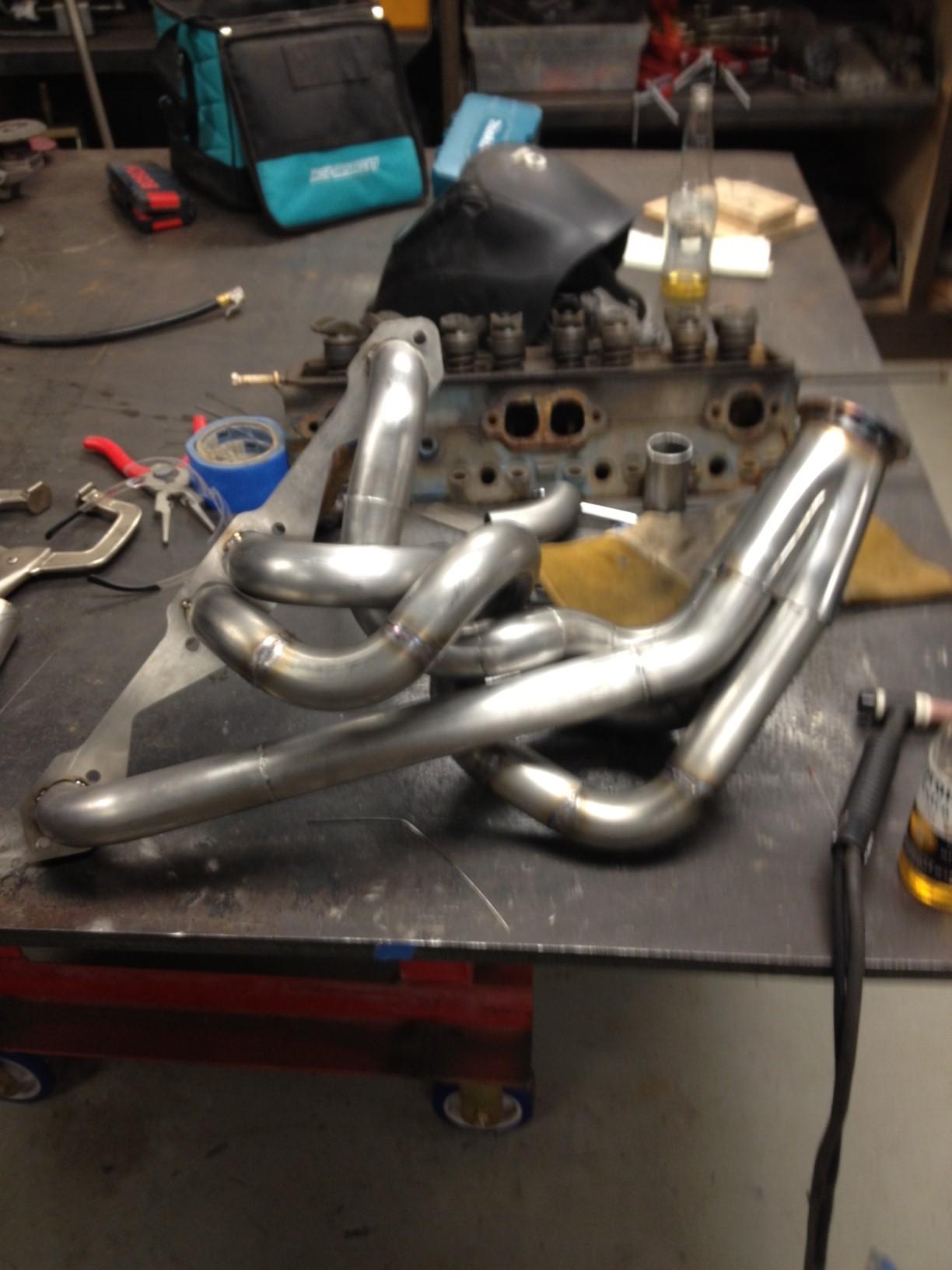

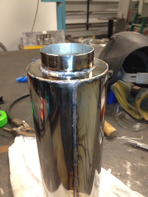

    Here's where I start to get a little ridiculous: I decided on a full stainless steel exhaust, and I am going to make all of it, including the mufflers
    and headers :eek:
    That's about how she sits today, the next few weekend will be camping weekends, so probably not much progress...
    Oh, by the way, the "plan" is what you've seen here with a quad Weber topped SBC and Muncie 4-speed. Black car with an ivory white '32 grill and matching steel wheels. I already have the dirt track style front and rear tires, and I'll do some dirt track style nerf bars, and rear bumper. I also plan on making a bomber style bench seat with ivory leather padding. I'd love to make a removable top insert, but the "how" is still eluding me..

    I made up one side of the headers, still have a little bit of welding to do.
