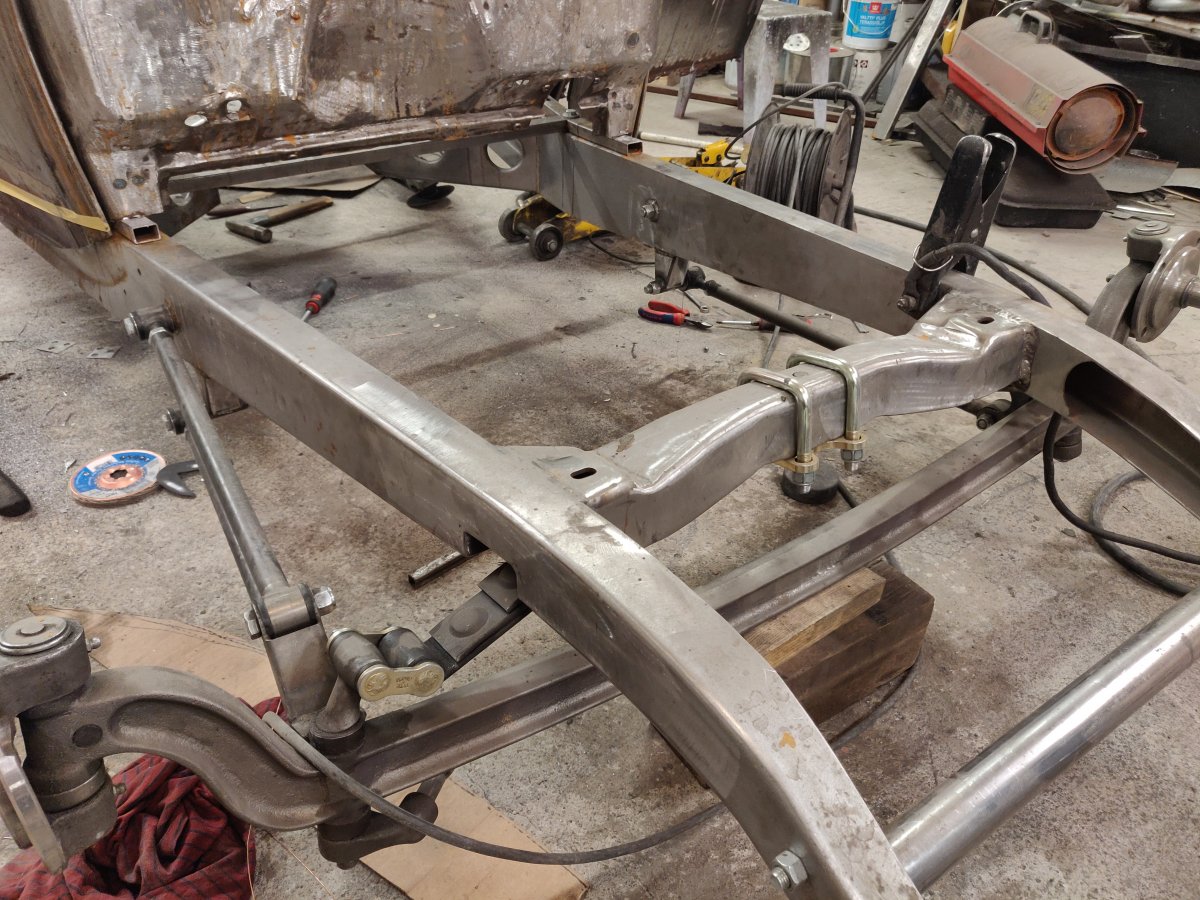

    I have to use fourbars front and back due to Finnish laws, but will be upgrading to front split wishbones once the time is right.
    Frame was sitting too high with 4inch drop axle, so i dropped the front crossmember and C-notch rear. Also did 2 inch bleedsweep.
    I wasnt't sure about welding cast iron housing on that gm 7,5" rear axle, so welded up tubing to it.
    IMG_20191229_210556.jpg IMG_20190927_224803.jpg IMG_20190927_224739.jpg IMG_20190929_214846.jpg IMG_20191001_230514.jpg IMG_20191014_190859.jpg

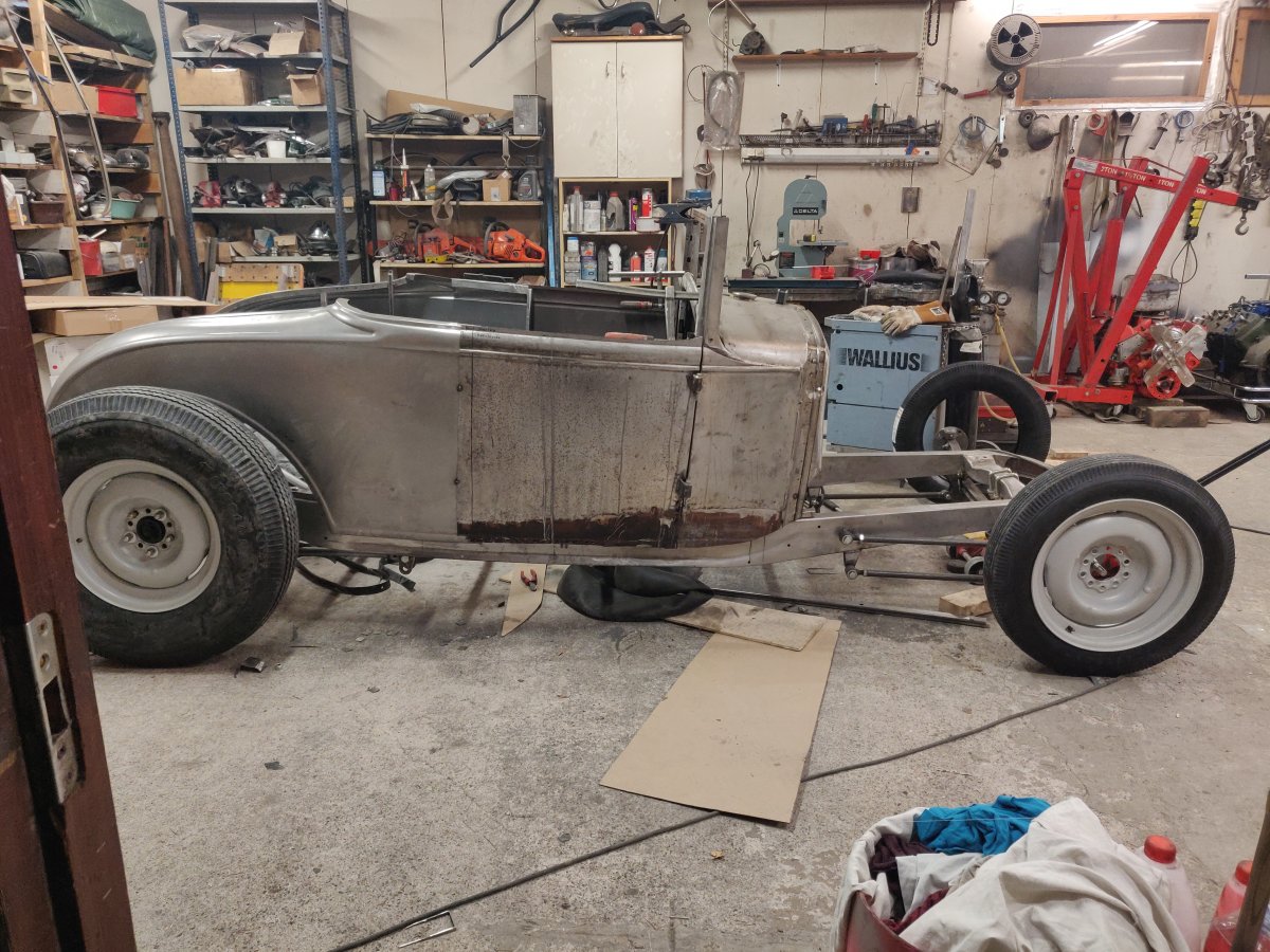

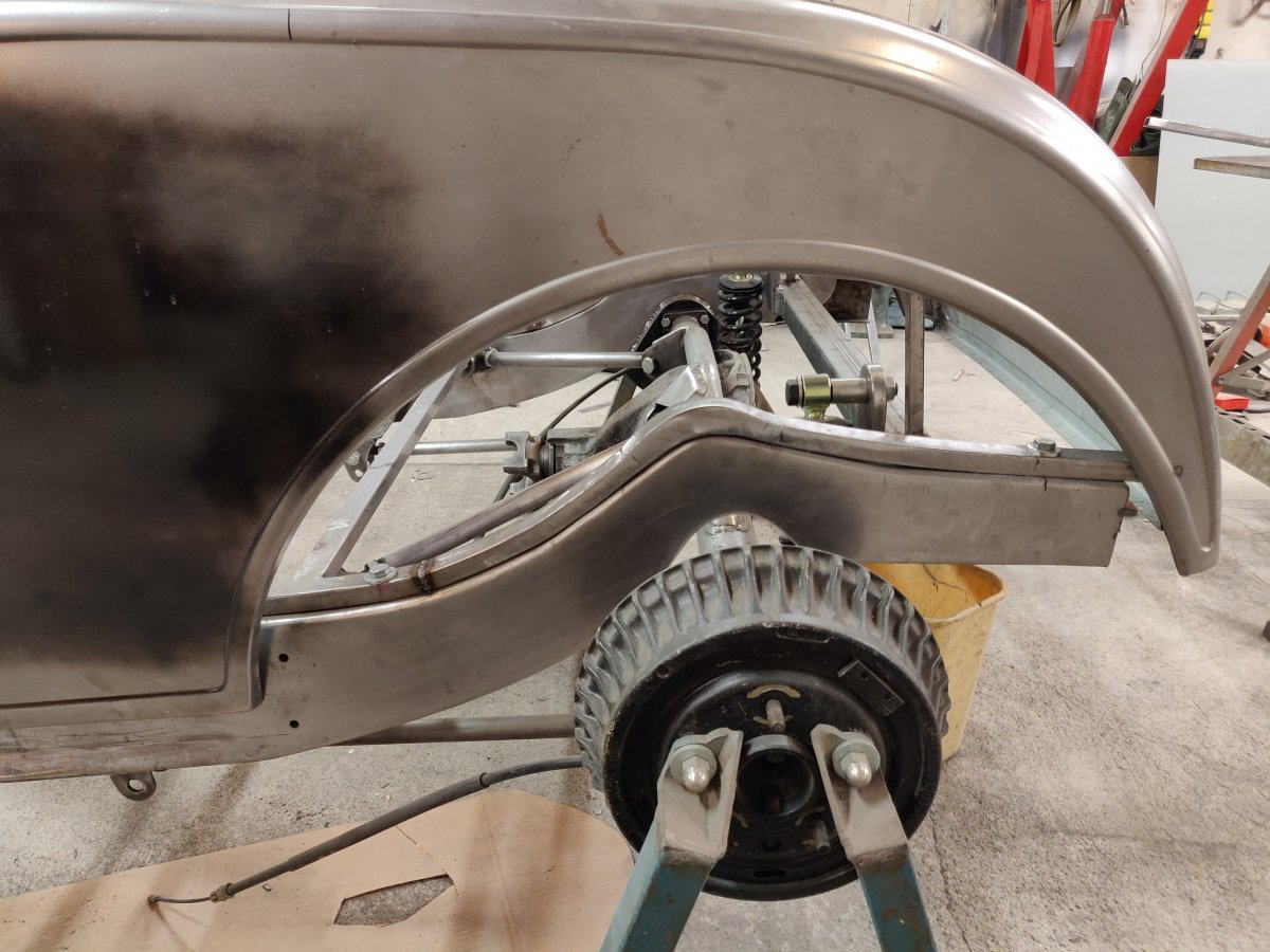

    After the cowl i moved to rear of the body.
    Got quarter panels lined up. The brookville panels needed quite a lot of work, all shapes wore different between those two panels.
    Made below and above deckpanels. IMG_20200212_201005.jpg IMG_20200212_201237.jpg IMG_20200212_201409.jpg IMG_20200212_201530.jpg

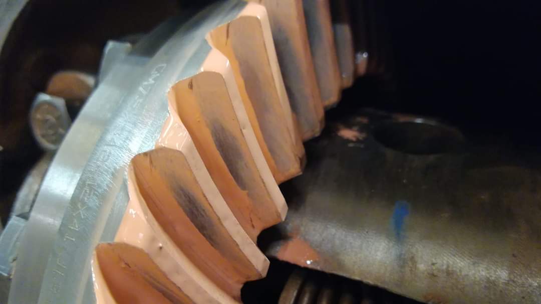

    Also had to work on the rear axle. Eaton locker with 3.73:1 ratio. First one for me, but think it came out okey, with help from the internet ? FB_IMG_1580764004090.jpg FB_IMG_1580763991141.jpg FB_IMG_1580763995096.jpg
    Thats where im at now. Next on to do list is decklick and inner structure to body

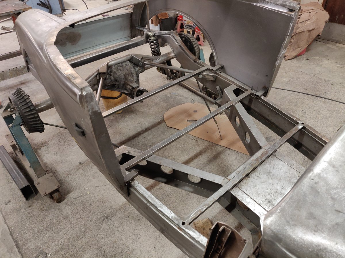

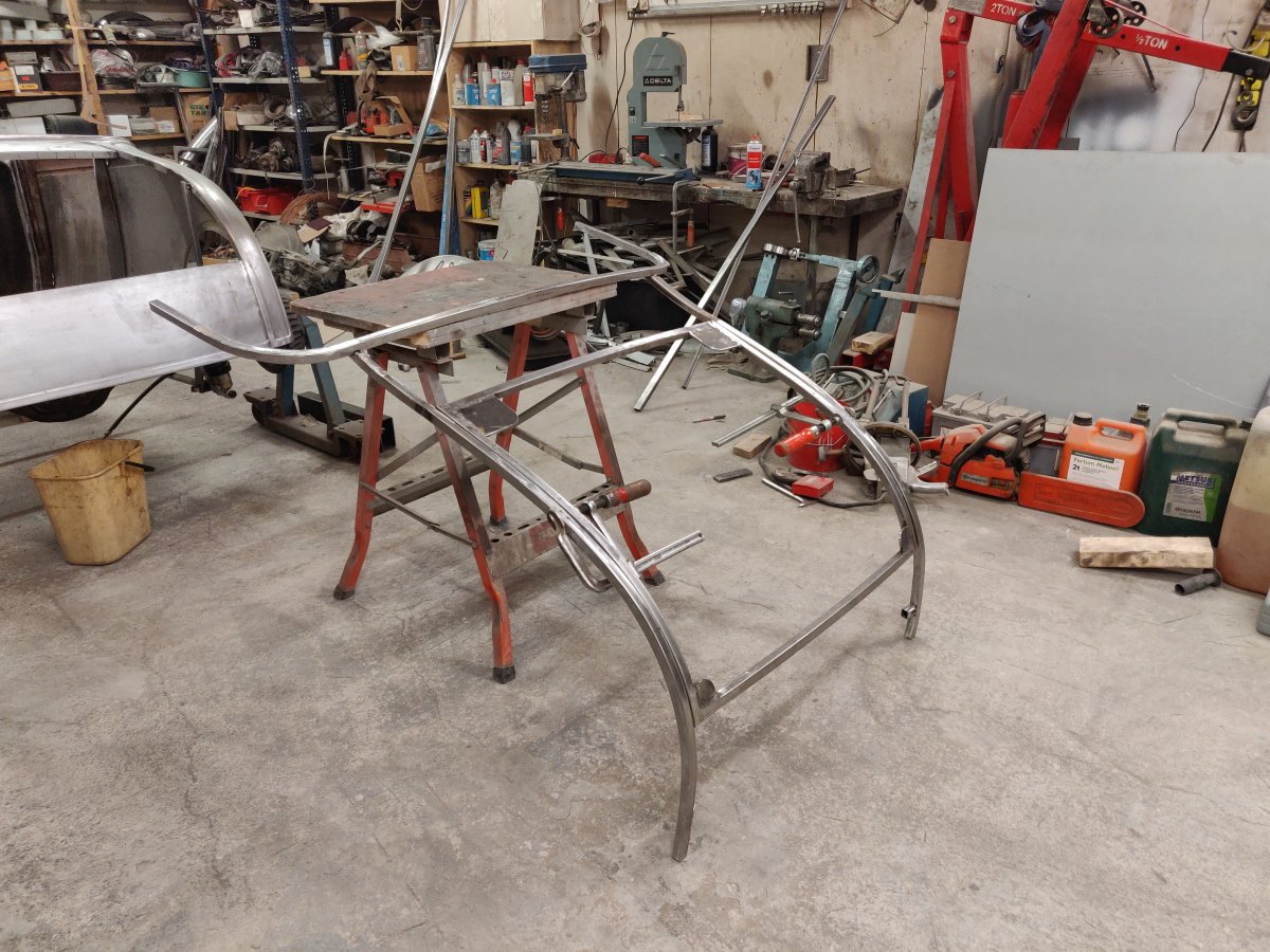

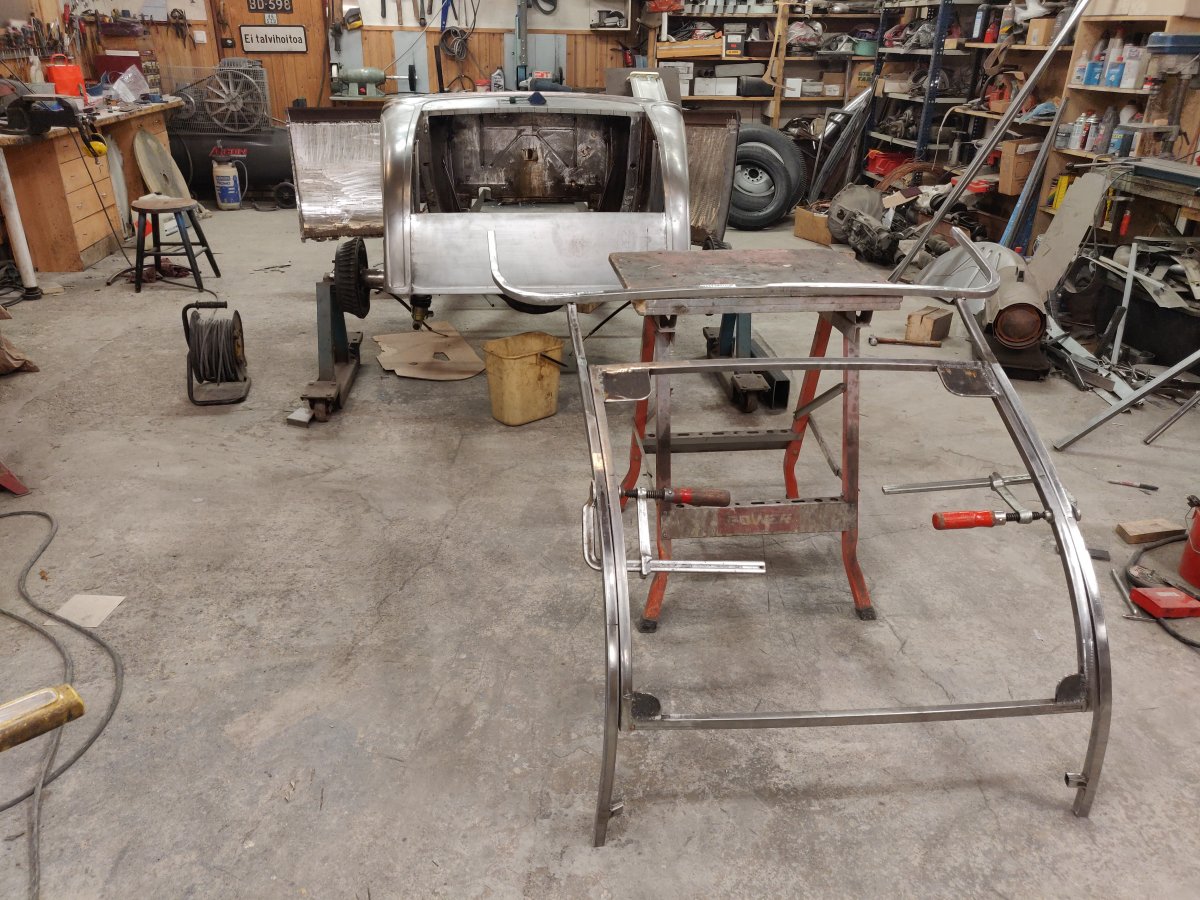

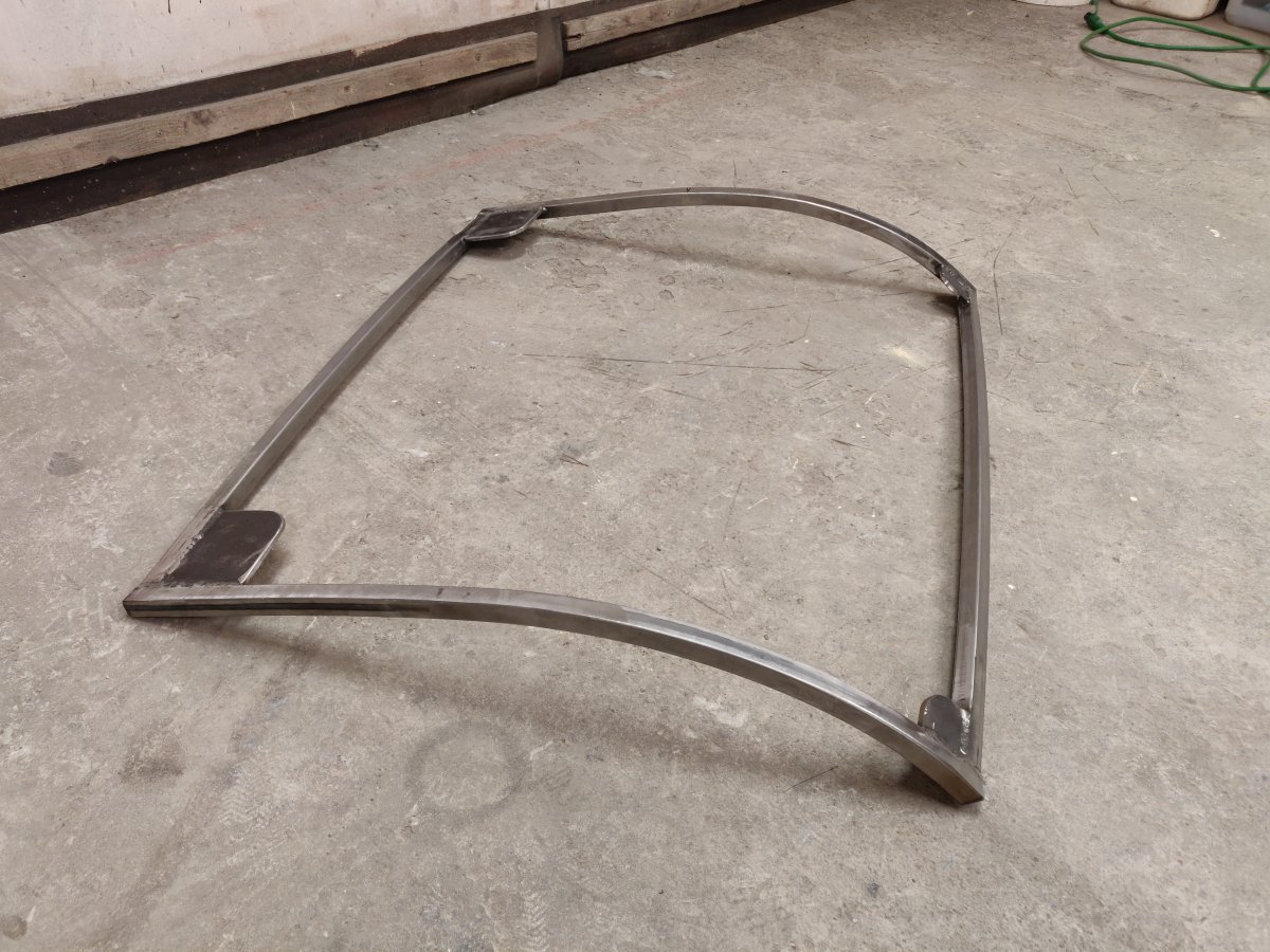

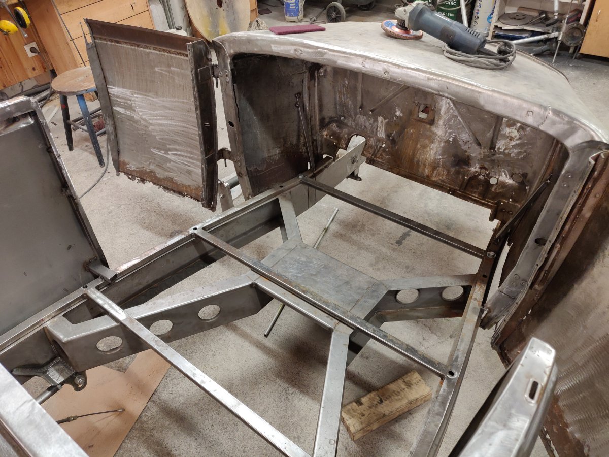

    Inner structures slowly coming together, also made decklid frame.
    IMG_20200225_214252.jpg IMG_20200225_214151.jpg IMG_20200225_214048.jpg IMG_20200225_213935.jpg IMG_20200225_214453.jpg IMG_20200215_215712.jpg

    That half-hoop thing you made to bridge the axle tubes so you could weld the upper 4 link brackets is brilliant. Thanks for sharing that. Does it adds and extra inch of height to the third member housing which will make your floor recess have to be bigger? Or is it forward enough on the housing that it is the same height as the upper part of the housing? But I like how you did it, and will keep it in mind.

    Dirk, the half hoop adds up one inch. Trunk is going to be quite small. Fuel tank will be placed there, and with the frame kickup and 2 inch channeling there will be room for a six pack and few tools.

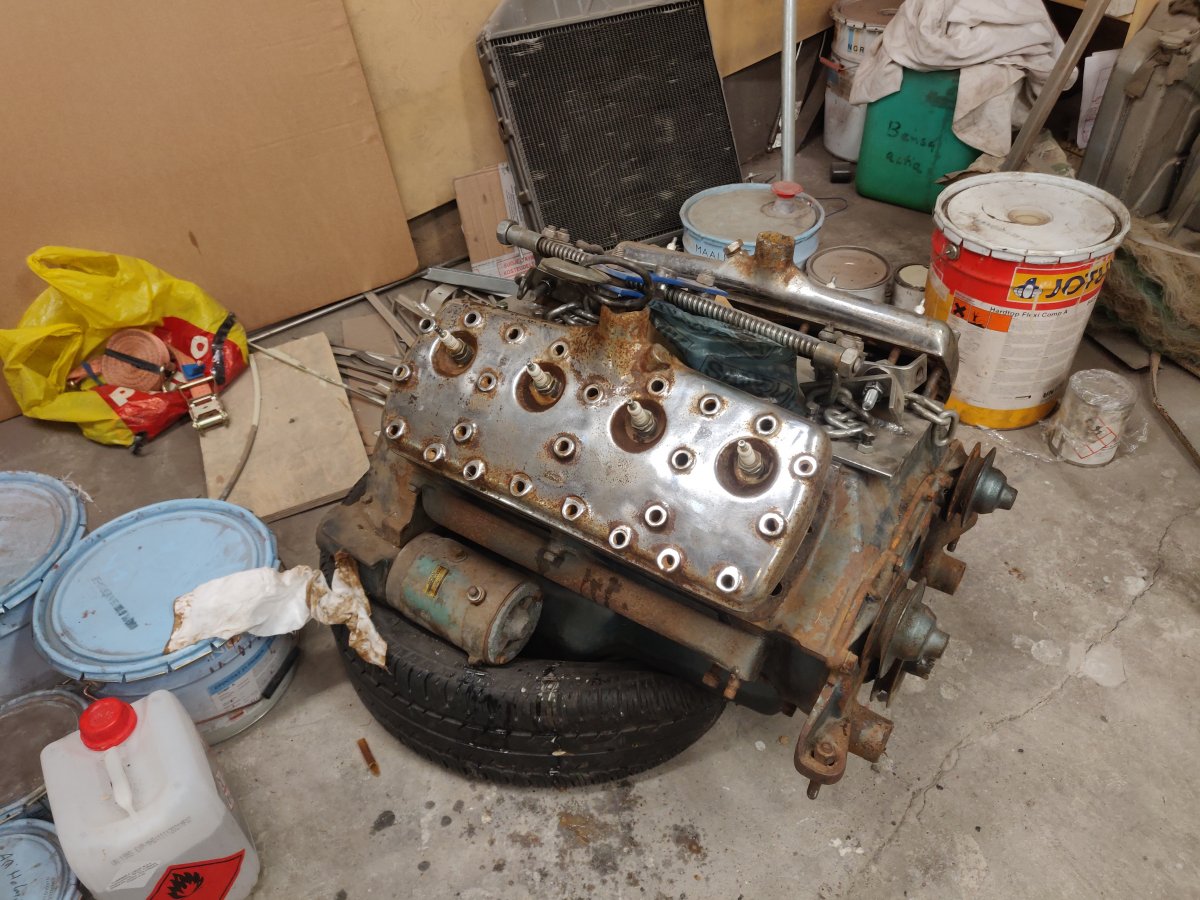

    Fun score today. 81A flathead with chromed heads ! For Ol' mans 39 coupe project.
    -Markus

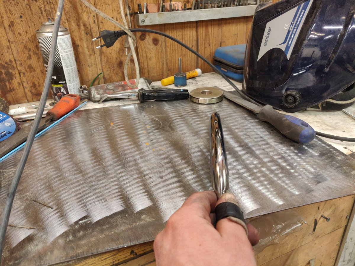

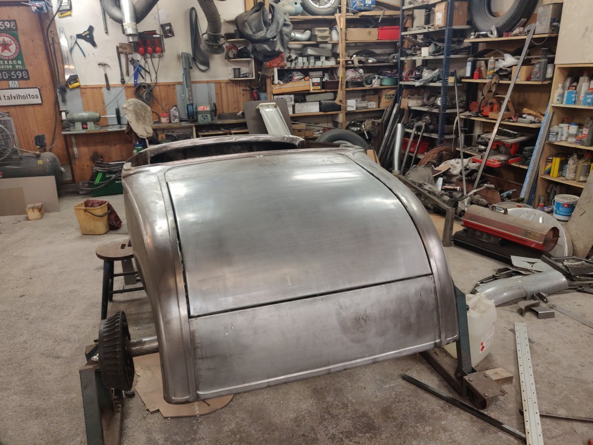

    Been working on trunk lid.

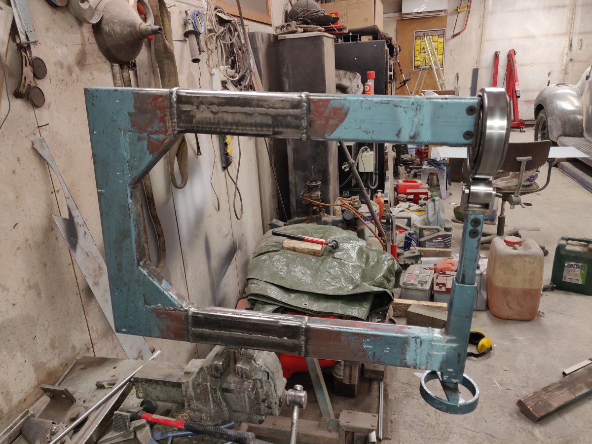

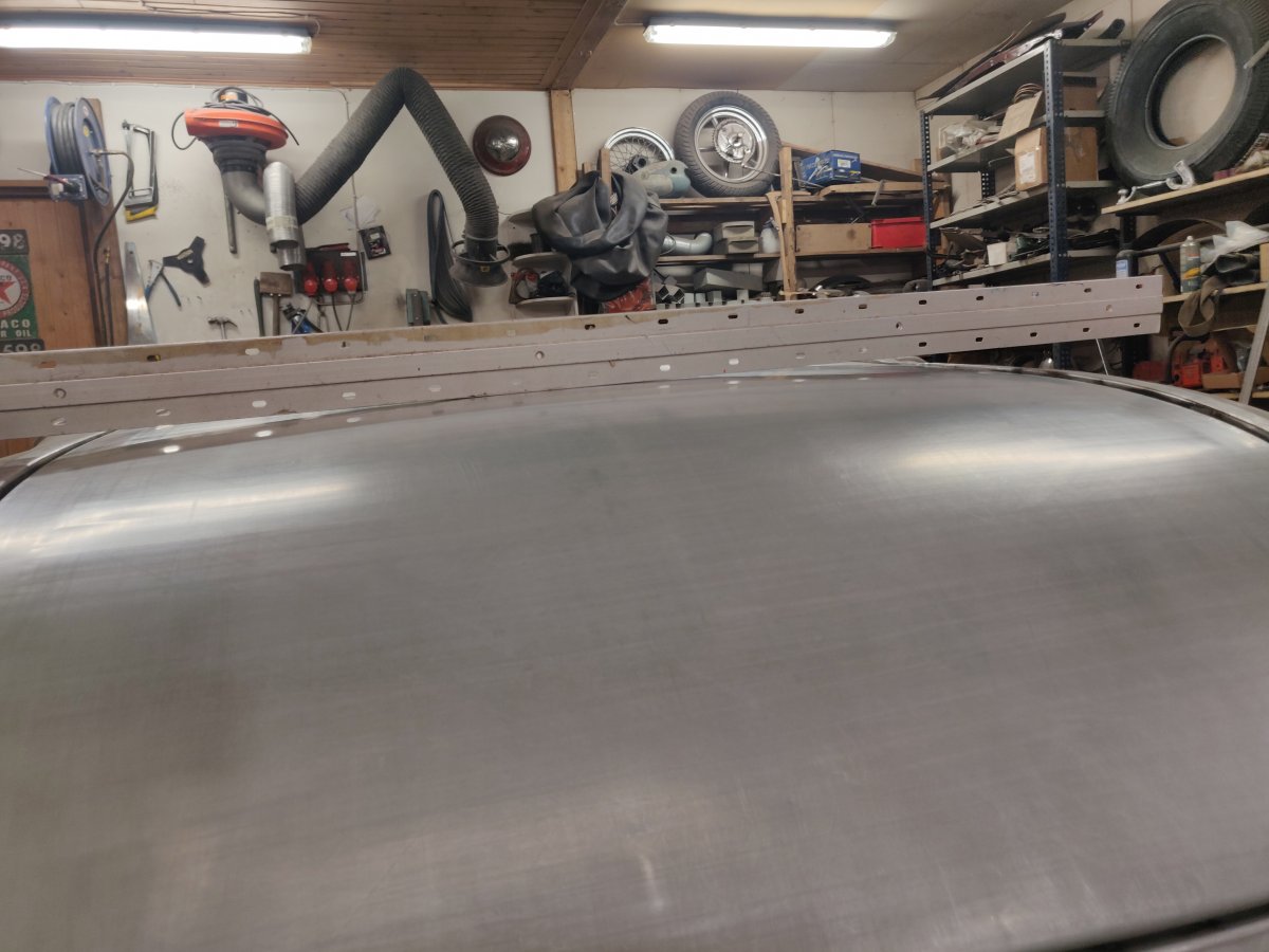

    First time english wheeling one piece panel this big. Came out fine. Room for filler, but happy with the shape. IMG_20200312_222450.jpg IMG_20200312_222421.jpg IMG_20200312_222546.jpg Made trunk lid bead and handle, to fit V shape on the above trunk panel. Still need to do mechanism for latch/handle and trunk lid hinges. IMG_20200322_210308.jpg IMG_20200322_210318.jpg IMG_20200317_211858.jpg IMG_20200320_232235.jpg IMG_20200320_232259.jpg IMG_20200322_210103.jpg IMG_20200322_210149.jpg

    Bonehead II
    How do you bend that square tubing like that, super job.
    Chevy28 likes this.

  23. HelminenHotrods
    Joined: Jun 8, 2018
    Posts: 118
    HelminenHotrods
    from Finland

    I see the square tube inner structure in your pic...
    I build with panels from different cars so a cage like your's would really help...
    I recently drew up a little print of the about same idea... drew it about 1" lower with [4] 1"x3" tabs on each side welded along the top of a 1/2" conduit frame work...then drill through the trunk gutter and into them... I could then use clekos to align and hold the panels while I build the subfloors...

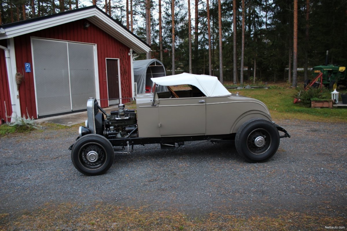

  27. HelminenHotrods
    Joined: Jun 8, 2018
    Posts: 118
    HelminenHotrods
    from Finland
    Thank you ! I had fun with that little chevy, but fourbanger and short gear ratio killed the buzz for me. Overdrive would make huge difference ! 33663506_1441458145959257_5272775746929033216_o.jpg IMG_5398.JPG IMG_5191.JPG IMG_5184.JPG

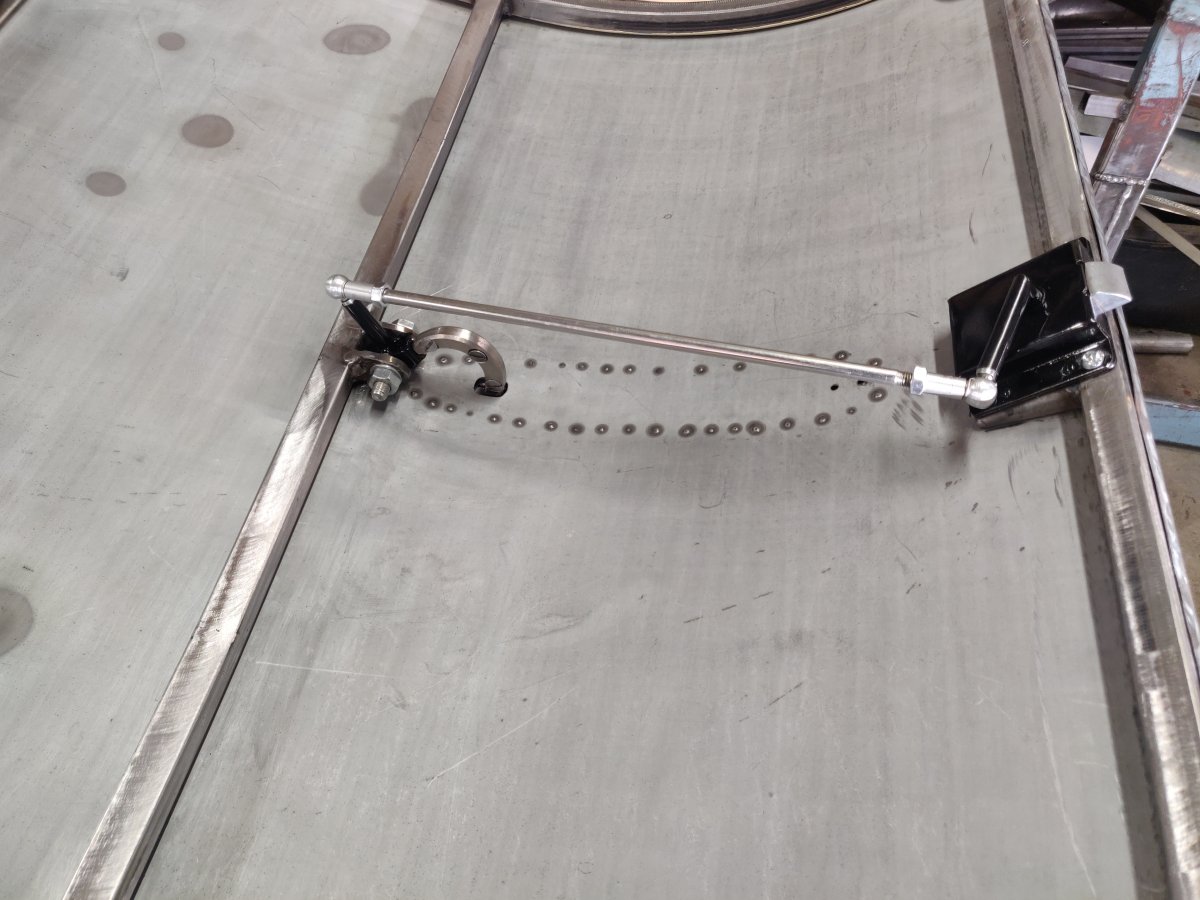

    Decklid handle and lock is about done. IMG_20200425_130458.jpg IMG_20200425_191511.jpg IMG_20200425_200517.jpg IMG_20200425_200546.jpg
  30. HelminenHotrods
    Joined: Jun 8, 2018
    Posts: 118
    HelminenHotrods
    from Finland
    Small update on ford. Handle working and popping !
    Hinges made out of 39 ford hinges IMG_20200503_191642__01.jpg IMG_20200503_191710.jpg IMG_20200503_200056.jpg
