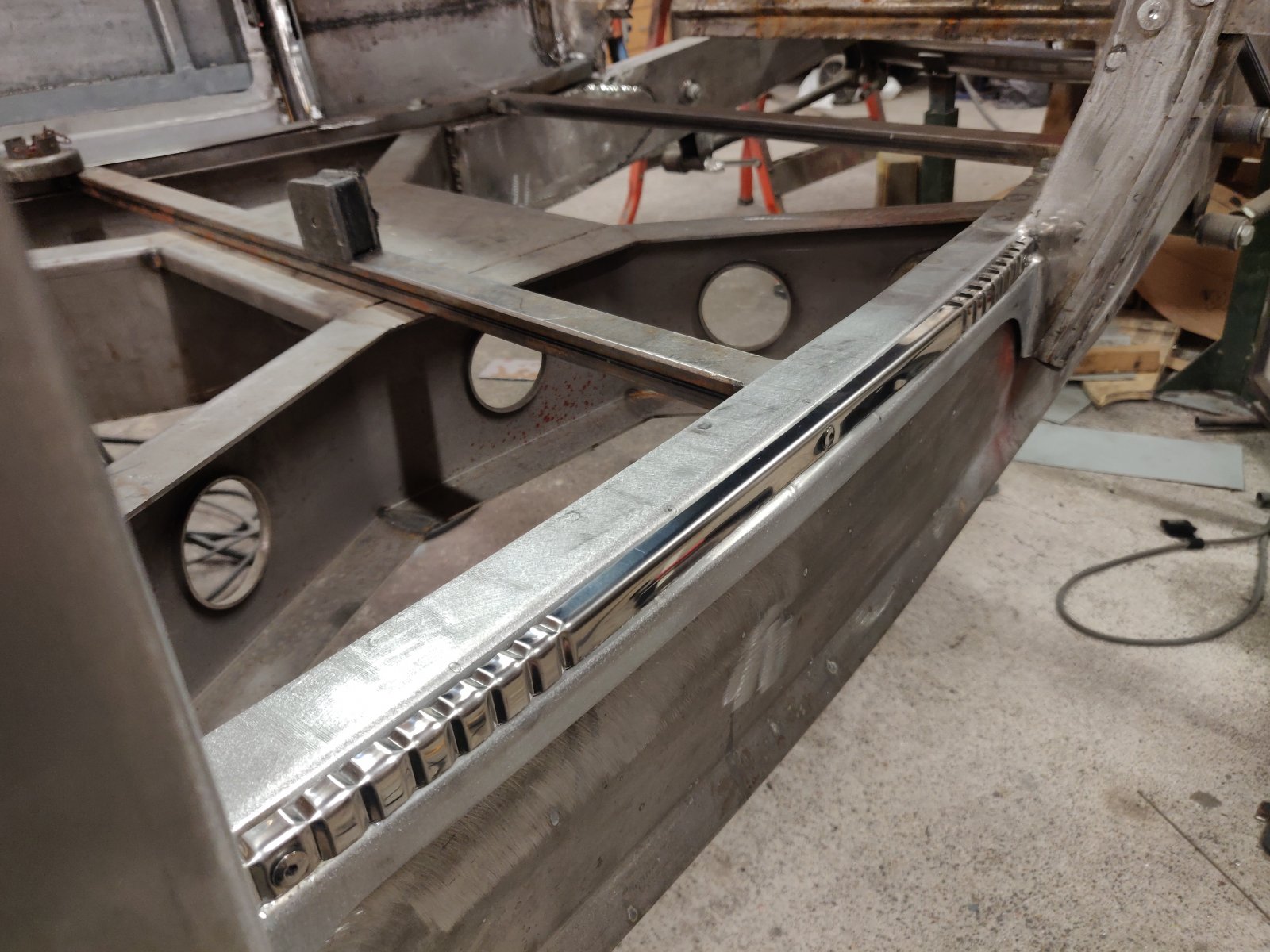

    The fun stuff again. Started building kustom rocker panels. I went little overboard with these.
    Got the passenger side done :
    Rocker panel :
    Trim :
    Welded and cleaned up:
    With the trim:
    -Markus
    Deutscher, dwollam, leadsled and 21 others like this.

  20. Nice detail in and on that rocker panel!
    Chevy28 likes this.

  22. Atwater Mike
    Joined: May 31, 2002
    Posts: 11,618
    Atwater Mike
    The lower rockers AND the shapely inner fender: Now, that's a flare with FLAIR!
    BUT, the rocker panel finish panels? Just 'ducky', as my daughter sued to say.
    (they say those things in California, or they 'did'...)
    Beauty is in the profile of this beautiful roadster. Went one up on the '32 Highboys!
    Chevy28 likes this.

  27. nrgwizard
    Joined: Aug 18, 2006
    Posts: 3,011
    nrgwizard
    from Minn. uSA
    Very nice trim piece. What was it from? Or did you fabricate it?
    TIA.
    Marcus...
    Chevy28 likes this.

  30. HelminenHotrods
    Joined: Jun 8, 2018
    Posts: 144
    HelminenHotrods
    from Finland
    I made these trim pieces from stainless steel with a bead roller. It took a while to figure out how to get the right look, but fearly simple to make once i knew what to do
    -Markus
