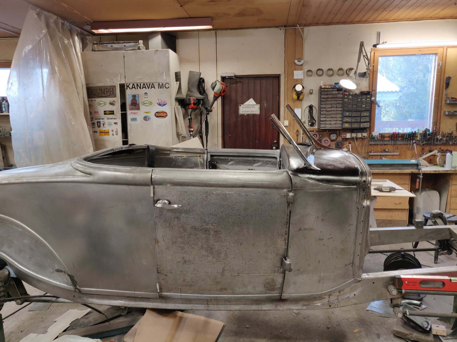

    Few more pictures of the windshield.
    The final fitment and glass will be done once all the bodywork is done. IMG_20230401_184806.jpg IMG_20230401_185110.jpg IMG_20230401_185505.jpg IMG_20230401_184923.jpg IMG_20230401_184959.jpg IMG_20230401_184833.jpg IMG_20230401_184946.jpg IMG_20230401_184714.jpg IMG_20230401_185051.jpg IMG_20230401_185205.jpg IMG_20230401_184752.jpg IMG_20230401_184742.jpg

    Oh. My. God. That's an incredible piece of work. Not just the w/s frame, which is jewelry, the entire project. I admit I winced at the title at first. ;)

    The windshield frame turned out great, a real piece of craftsmanship.

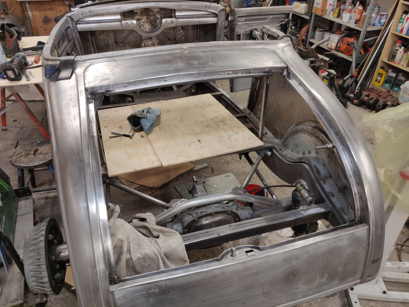

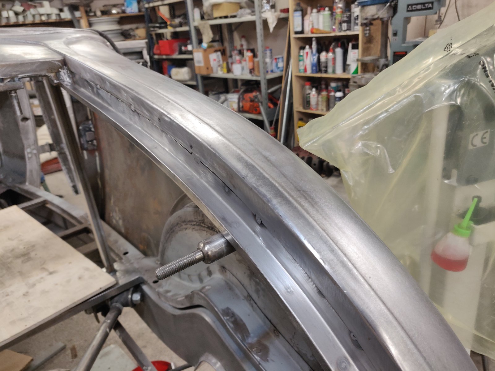

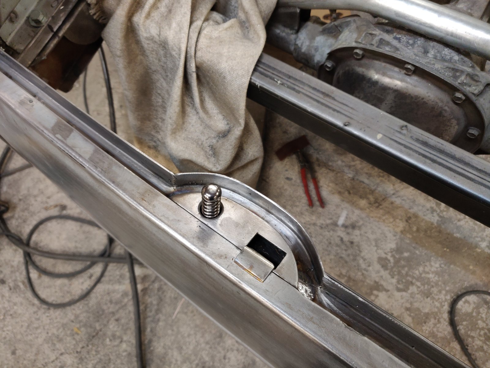

    Time for some updates :

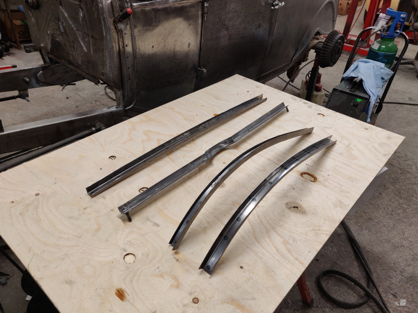

    Let's start with the rain gutters in trunk.
    IMG_20230403_212419.jpg IMG_20230401_190713.jpg IMG_20230403_212440.jpg IMG_20230403_205110.jpg IMG_20230403_205256.jpg IMG_20230404_153940.jpg IMG_20230403_212546.jpg

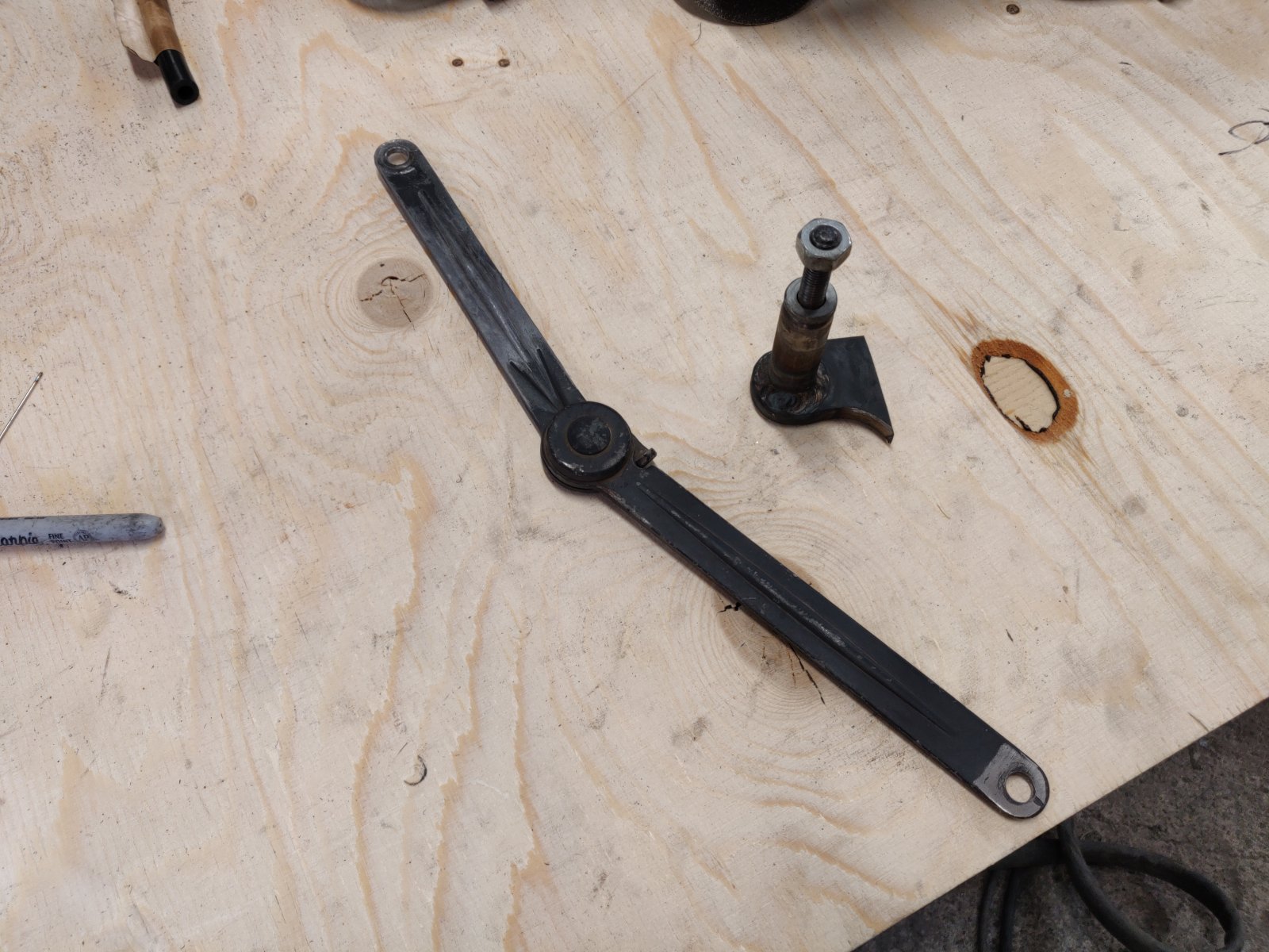

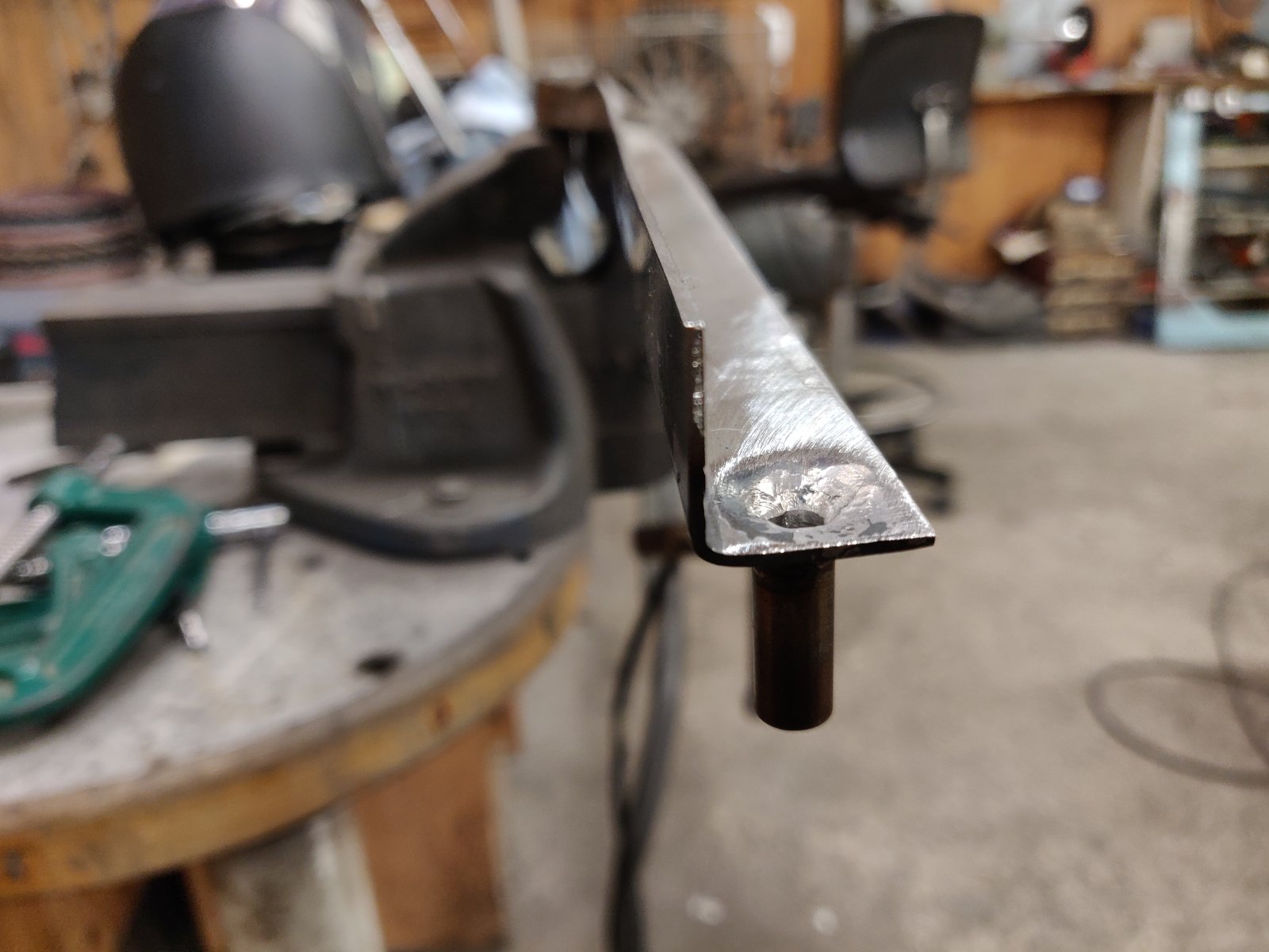

    Also did the trunklid holder, using 39 ford part: IMG_20230404_172854.jpg IMG_20230404_172906.jpg

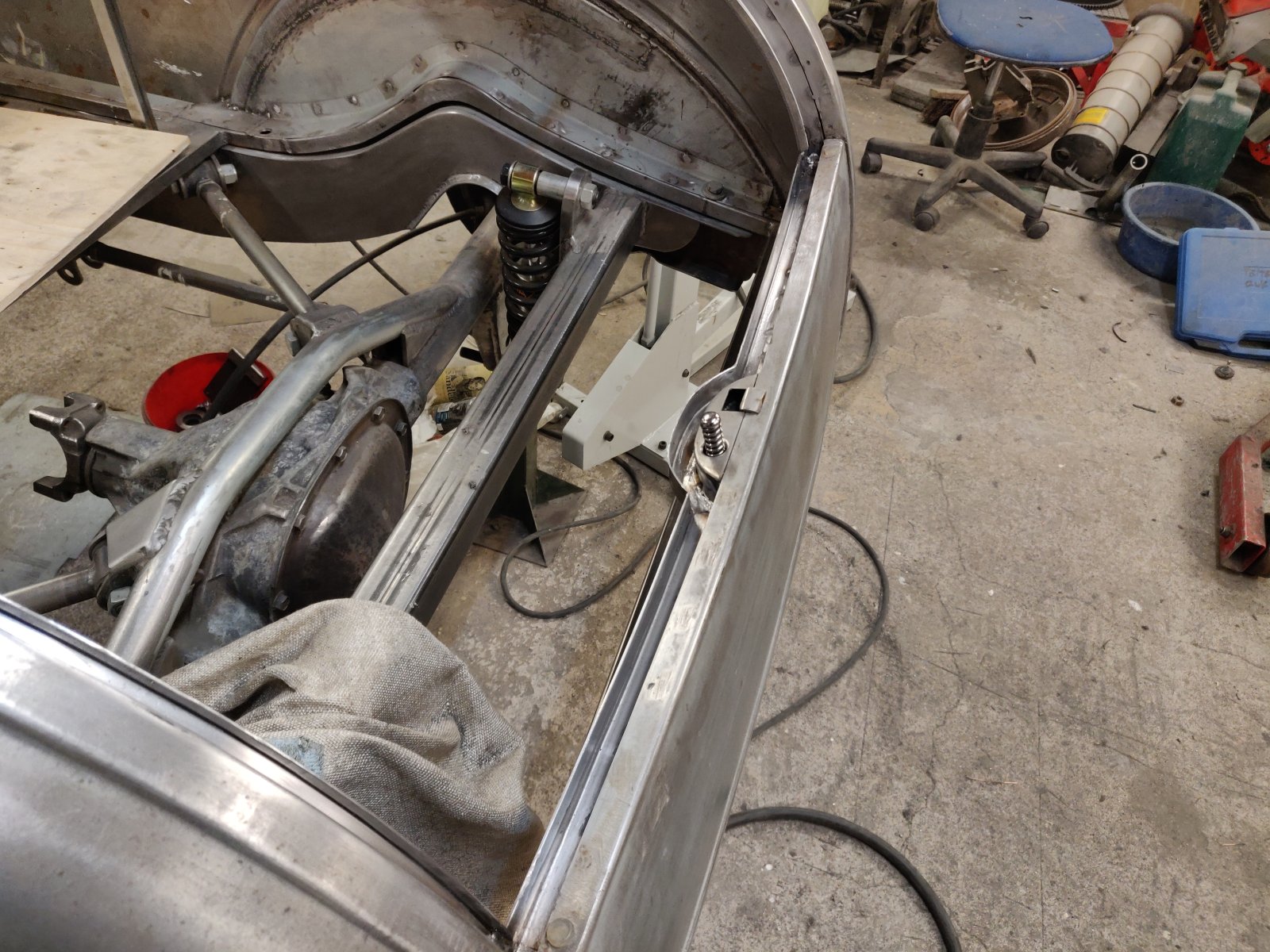

    Gutters is place :
    IMG_20230404_212739.jpg IMG_20230404_212727.jpg IMG_20230404_212659.jpg IMG_20230404_212620.jpg IMG_20230404_212555.jpg
    -Markus

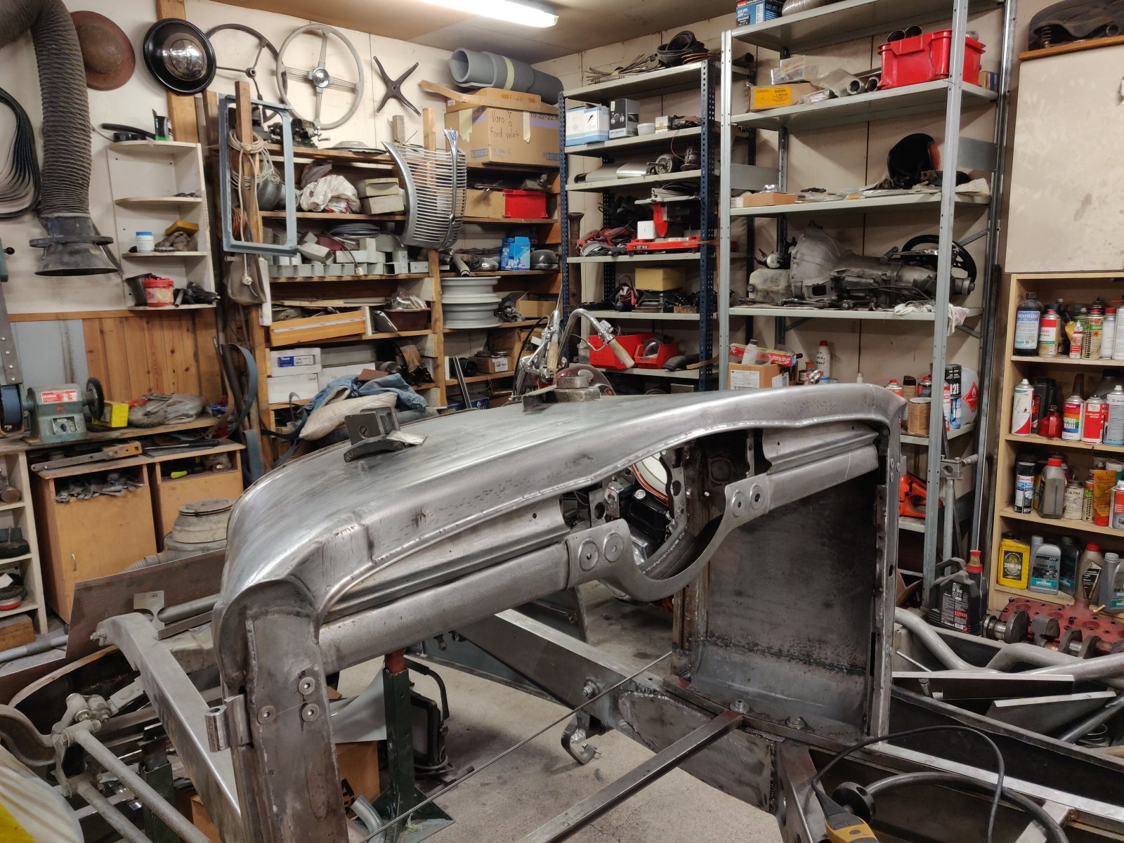

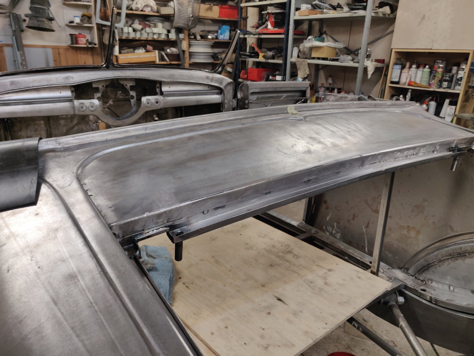

    Continuing on dashboard :
    Adding an bead or "eye brow" IMG_20221026_213037.jpg IMG_20221027_203219.jpg
    Finished,smoothed. Gives more deepness to it: IMG_20221027_213713.jpg
    -Markus

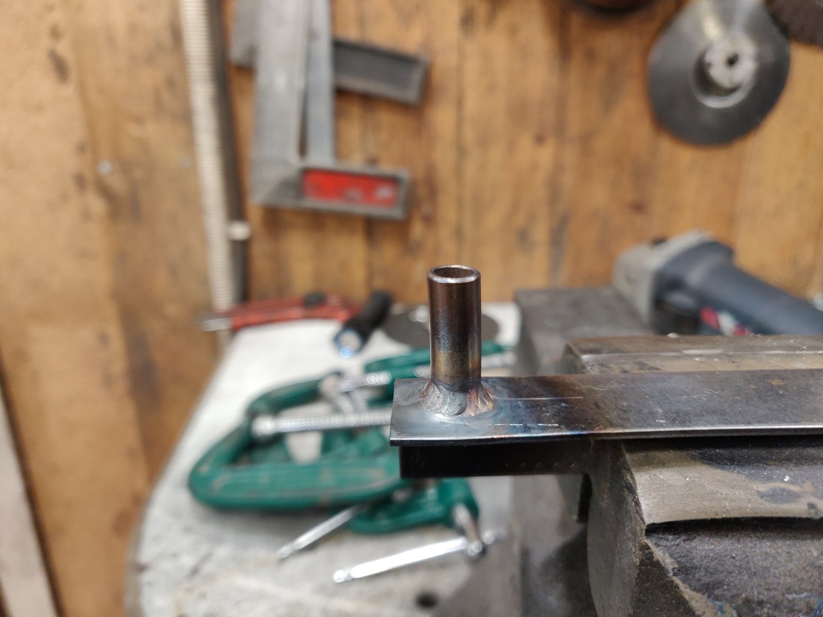

  22. Did you get much warpage when you welded that 'bead' above the dash? Looks like it required a lot of weld to fill that in. Just curious . . .
    Stogy and Chevy28 like this.
  23. Wow! Now you're not building a Hotrod anymore. Nothing less than a piece of art.
    Spooky, Stogy and HelminenHotrods like this.
  24. HelminenHotrods
    Joined: Jun 8, 2018
    Posts: 144
    HelminenHotrods
    from Finland
    At first i was worried about that, but tig welded and cooled step by step it didnt warp at all. Also the "dash rail panel" on cowl is very thick U-shape panel.
