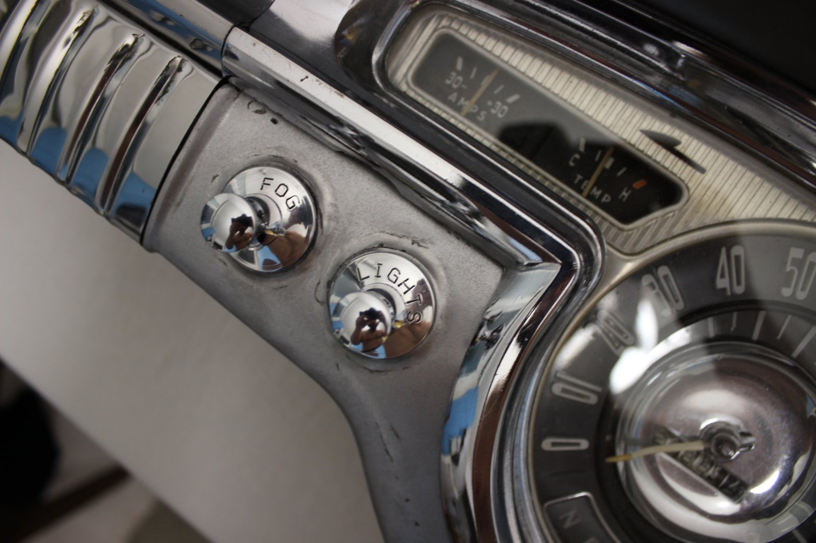

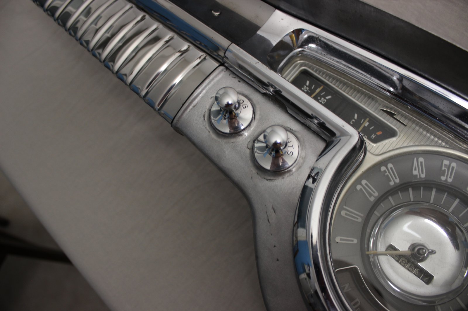

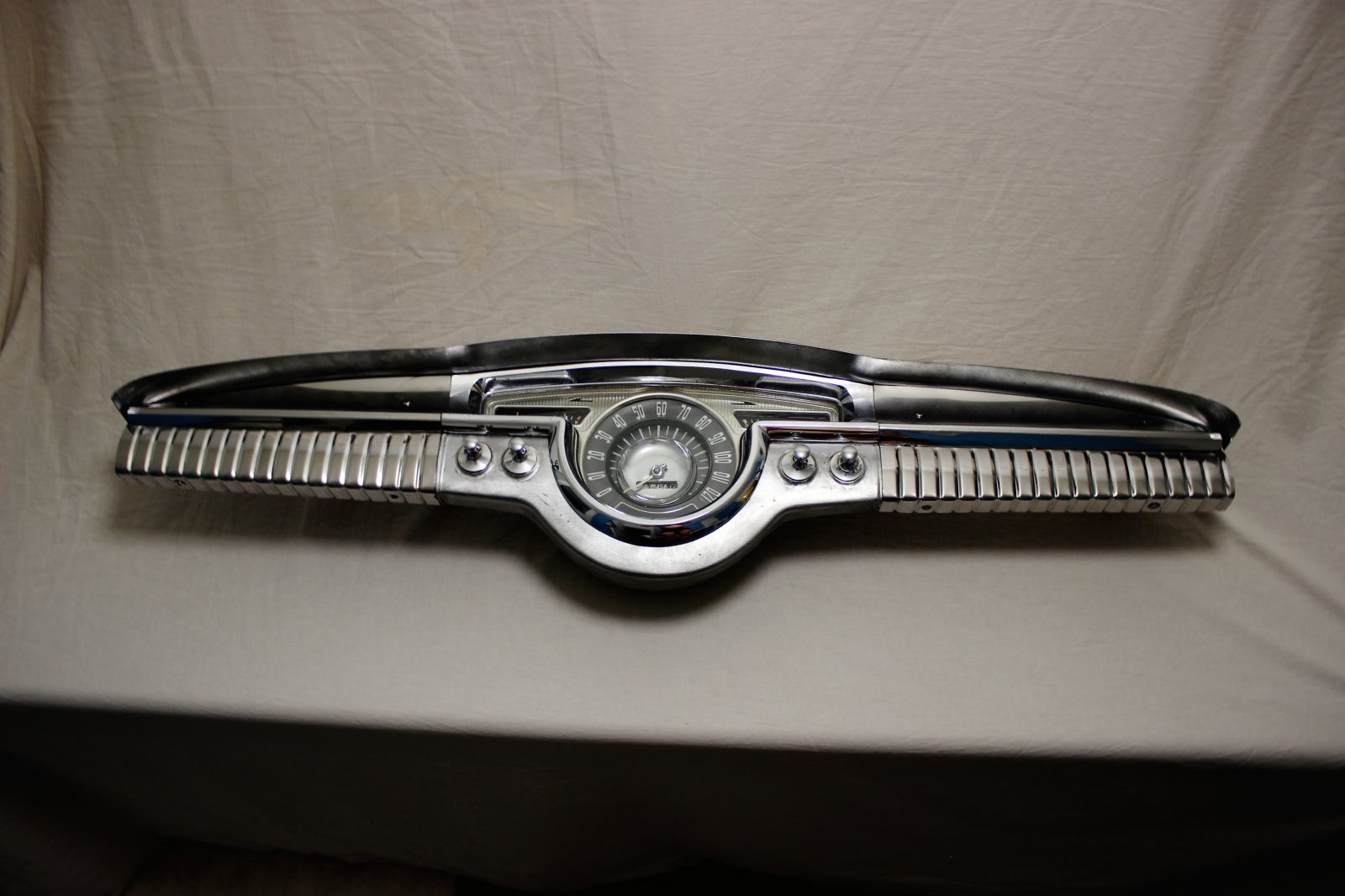

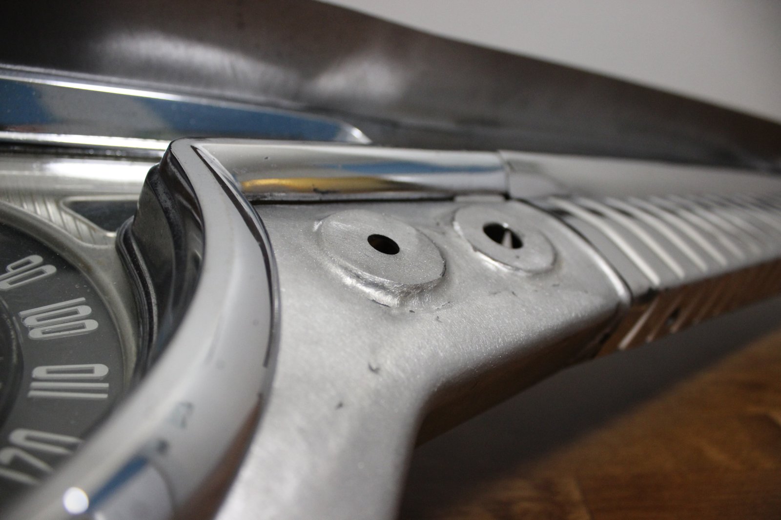

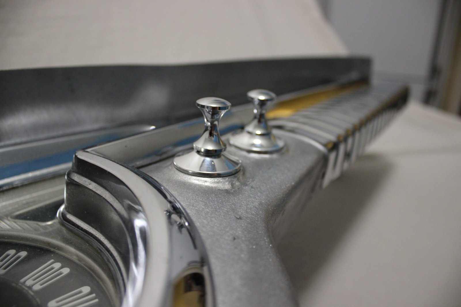

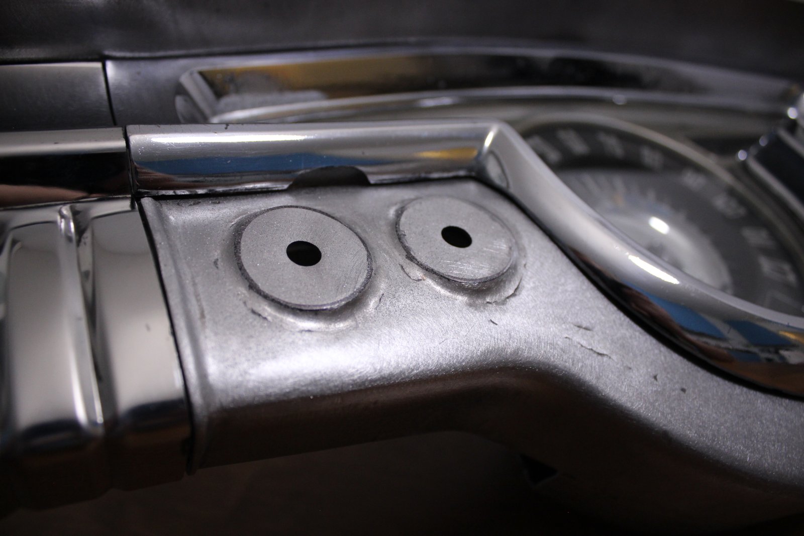

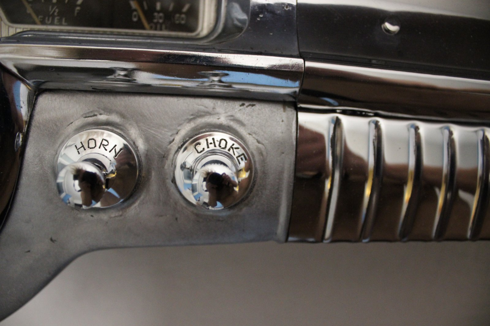

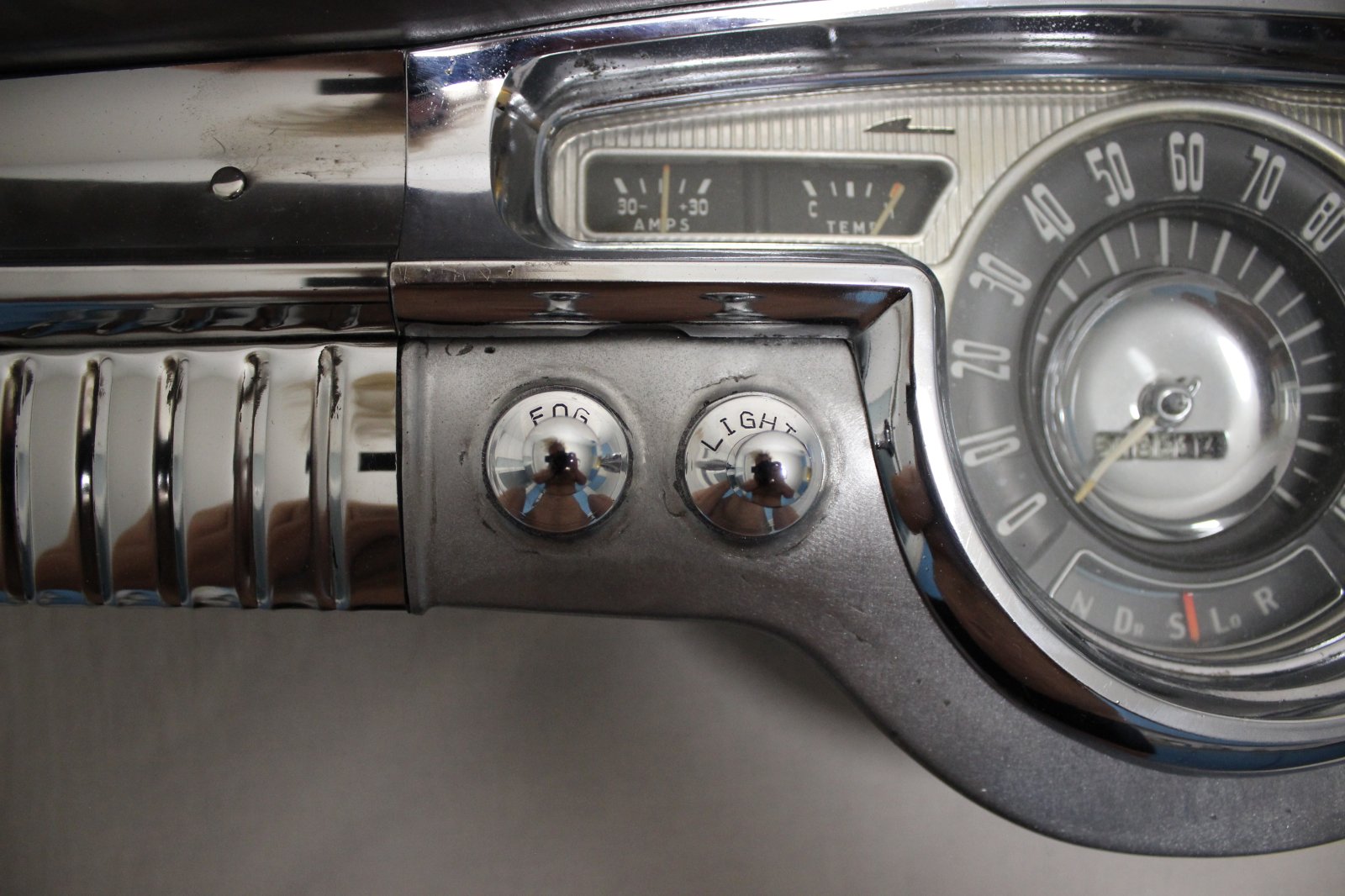

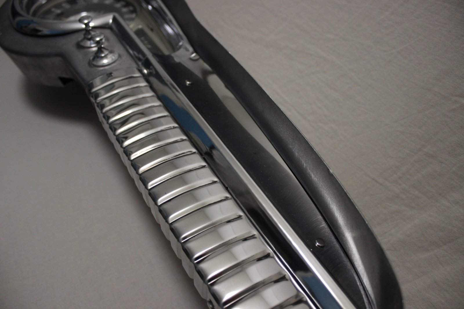

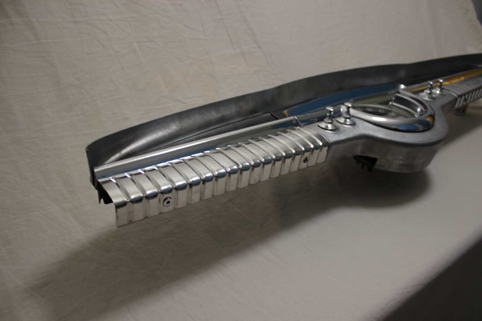

    The dash has an slightly round shape to follow the shape of the gauge, so i had made that little step for switches/knobs. It also gives more 3d factory kind-of look IMG_5899.JPG
    The switches are also DIY. Using different parts to make it work and look good. The scripts are lazer marked to aluminium and pressed to shape.
    The horn switch i had to do fully from ground up, becauce i didnt find any pull-opereted horn switch. IMG_5964.JPG

    The custom made stainless dash end trims are incredible, I would not have believed those weren't a factory stamped part if I hadn't seen it here. Extremely nice work.

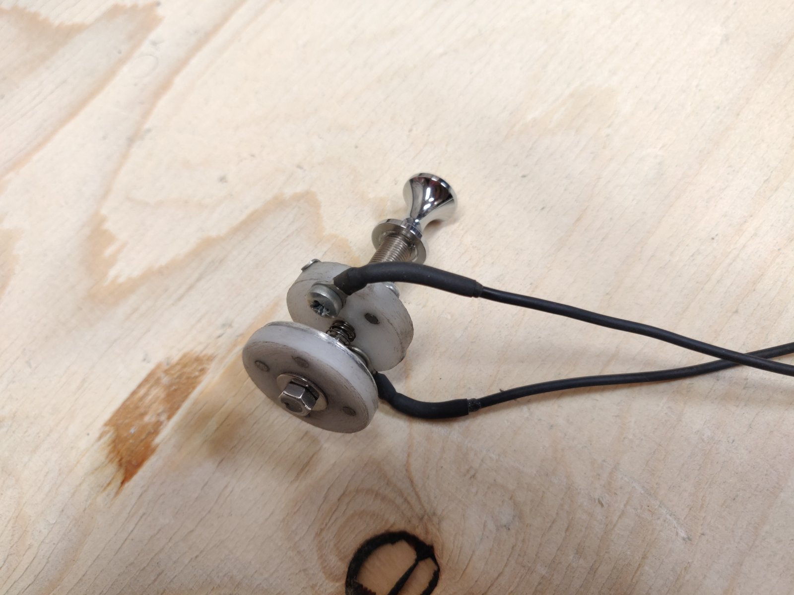

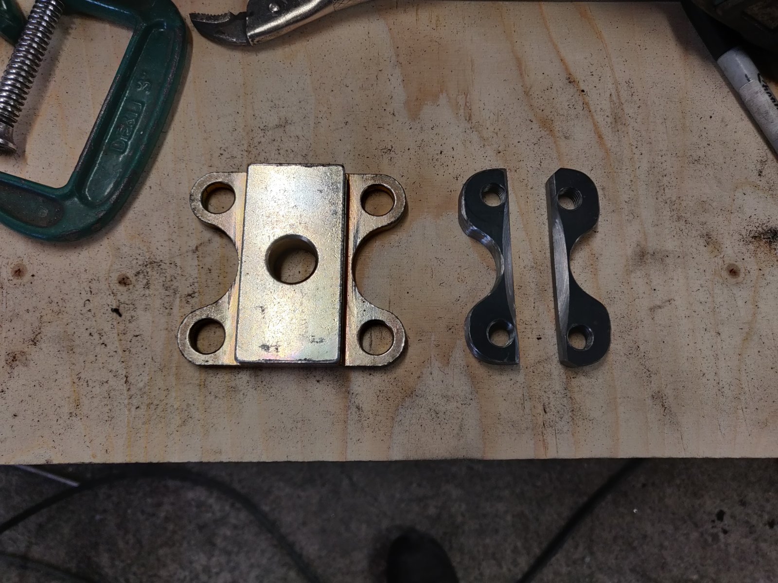

    Heres the diy pull-operated horn-switch
    Simplified : the nylon-plastic insulates from the switch frame. And the screws where wires mounts, connects together when pulled and touching the metal circular part. IMG_20230815_212039.jpg IMG_20230815_212132.jpg IMG_20230815_212055.jpg IMG_20230815_212222.jpg IMG_20230815_212141.jpg IMG_20230815_212240.jpg IMG_20230815_212313.jpg

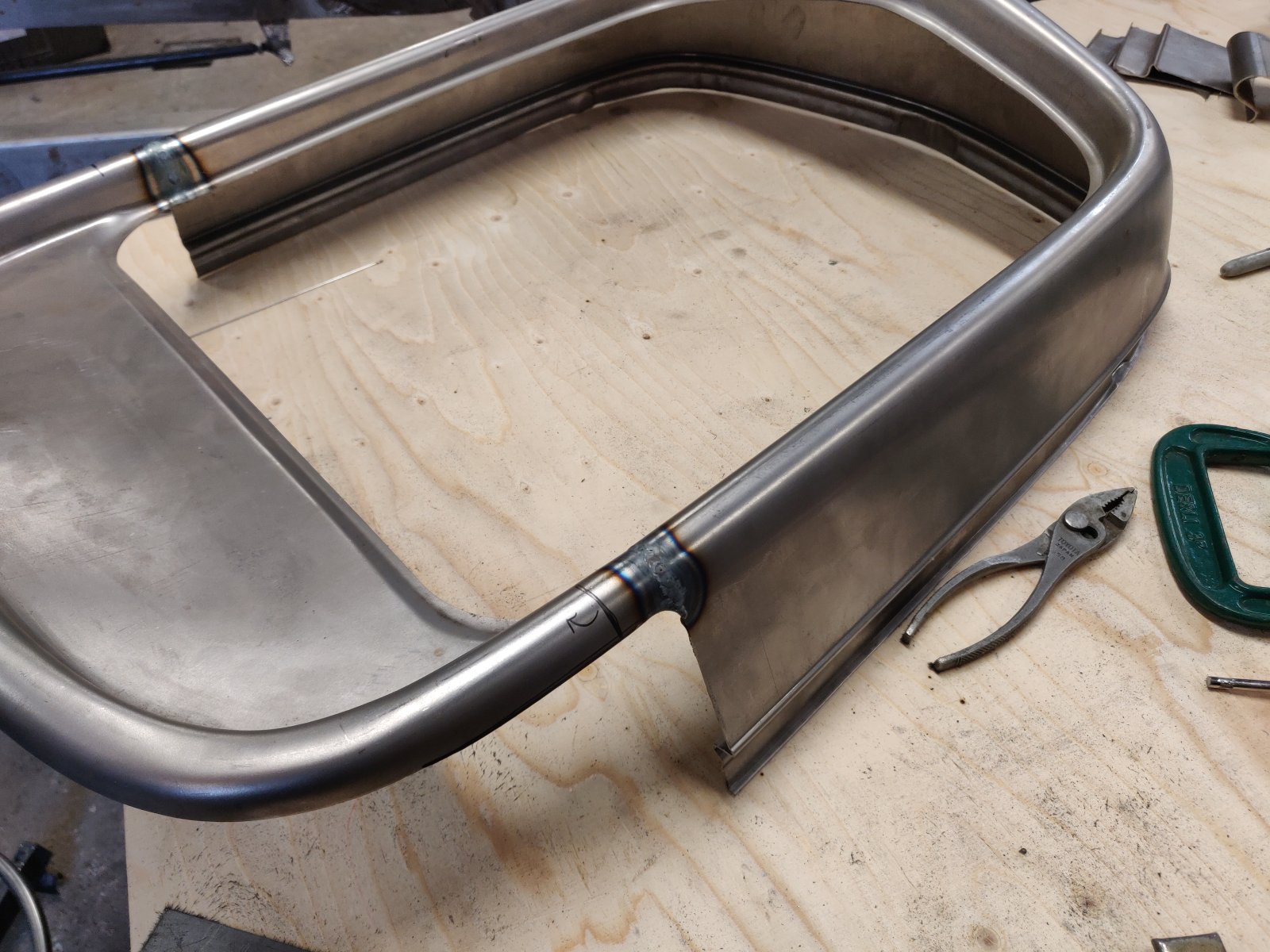

    Windshieldframe process thrown together

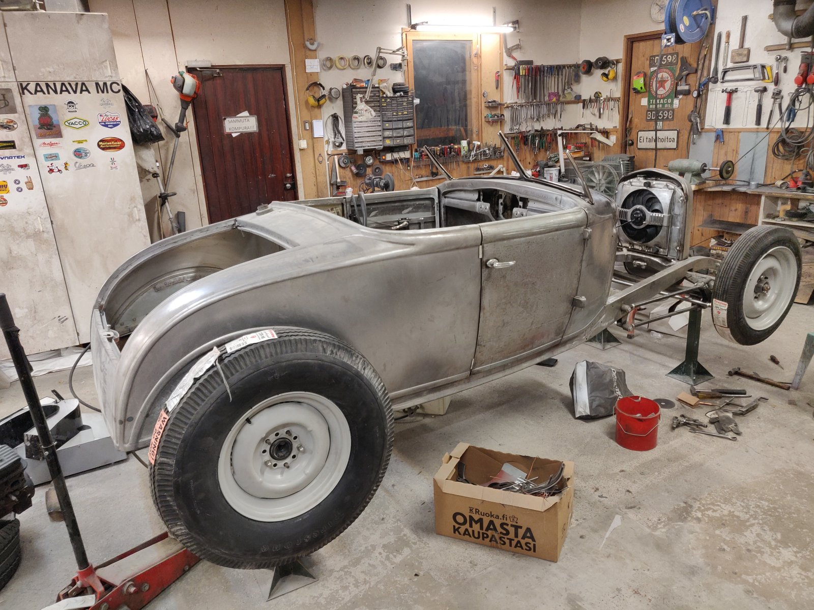

    The roadster was outside of the garage first time since being pushed in as an tudor.
    Good thing is it looked bad ass, and proportion looks good.
    Bad thing is i have to re-do rear c-notch etc. The stance was too much ass up. This build has chanced so much from the start as an rolling bones styled tudor, to an Helminen style roadster so more work a head. IMG_20231013_184545.jpg IMG_20231013_184638.jpg
    Heres the problem, at ride hight : IMG_20231020_221235.jpg
    And here's the solution, work in process : IMG_20231020_185432.jpg IMG_20231023_184643.jpg IMG_20231025_192944.jpg IMG_20231026_202826.jpg IMG_20231026_202759.jpg IMG_20231029_194714.jpg IMG_20231029_194530.jpg IMG_20231029_205846.jpg IMG_20231029_204615.jpg IMG_20231029_204709.jpg IMG_20231029_204653.jpg IMG_20231029_204639.jpg
