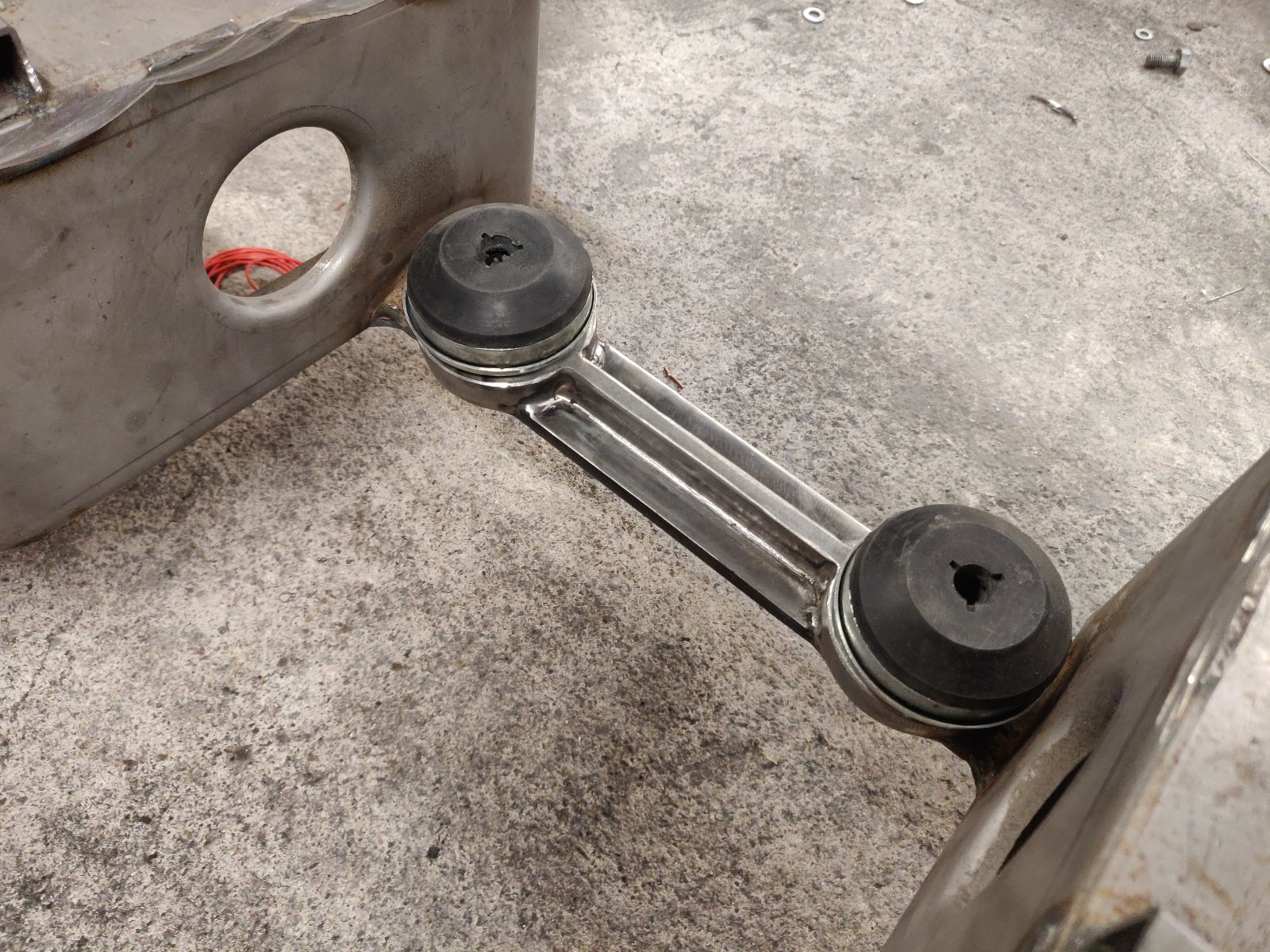

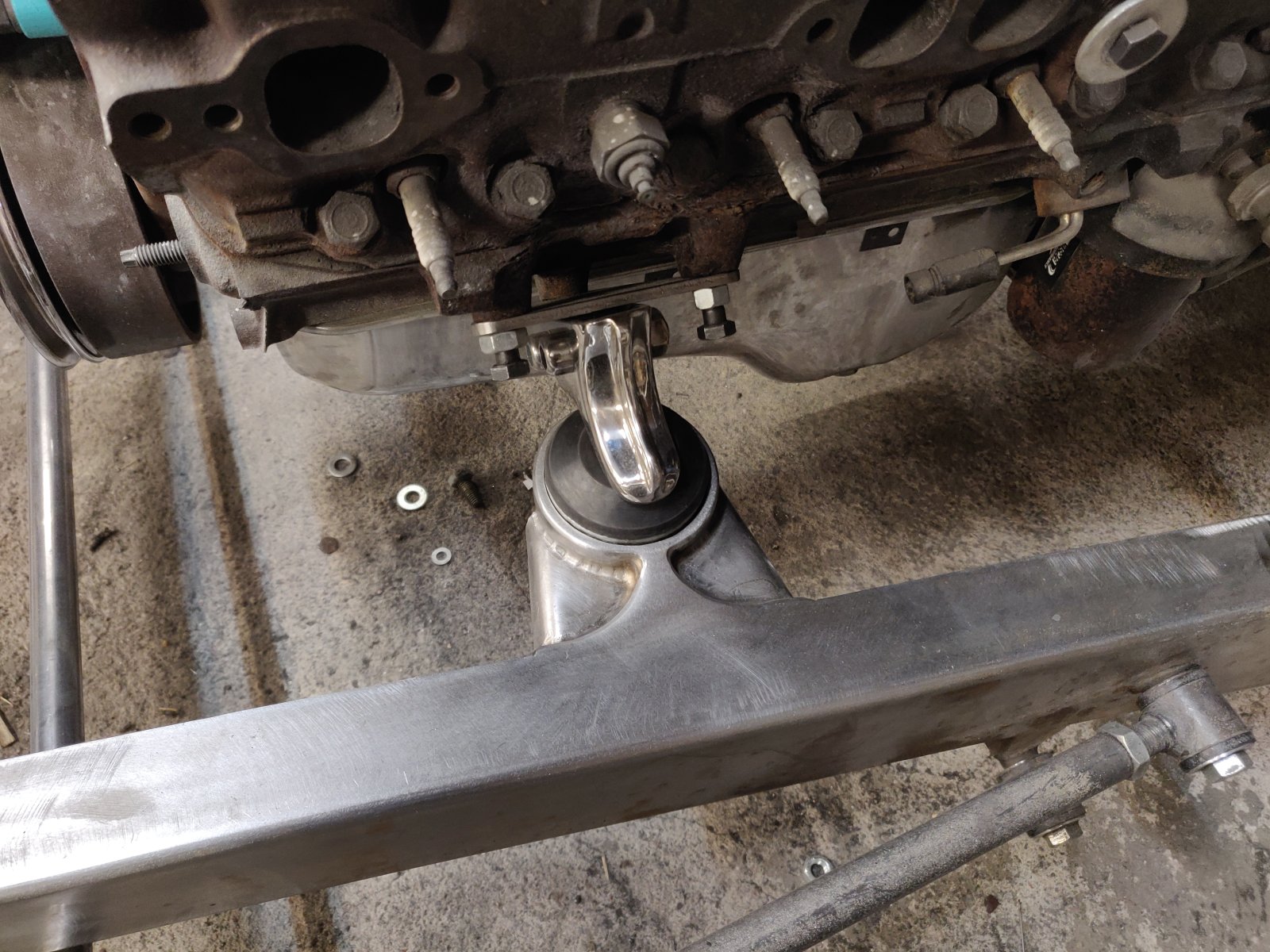

    The motor and transmission is in place.
    Made some styling to the lower mount, nothing crazy but something to give it some soul and more 3D style :D
    Forgot to the pictures of the transmission mount before welding. That is also pretty simple with styling to match the flathead style motormount rubbers
    IMG_20240202_230931.jpg IMG_20240203_162256.jpg IMG_20240203_162429.jpg IMG_20240204_203010.jpg IMG_20240204_203033.jpg IMG_20240204_214101.jpg
    And the transmission mount:
    IMG_20240209_234043.jpg IMG_20240209_231346.jpg IMG_20240209_234358.jpg IMG_20240209_231436.jpg IMG_20240209_234428.jpg

    Couple more pics of the transmission mount:

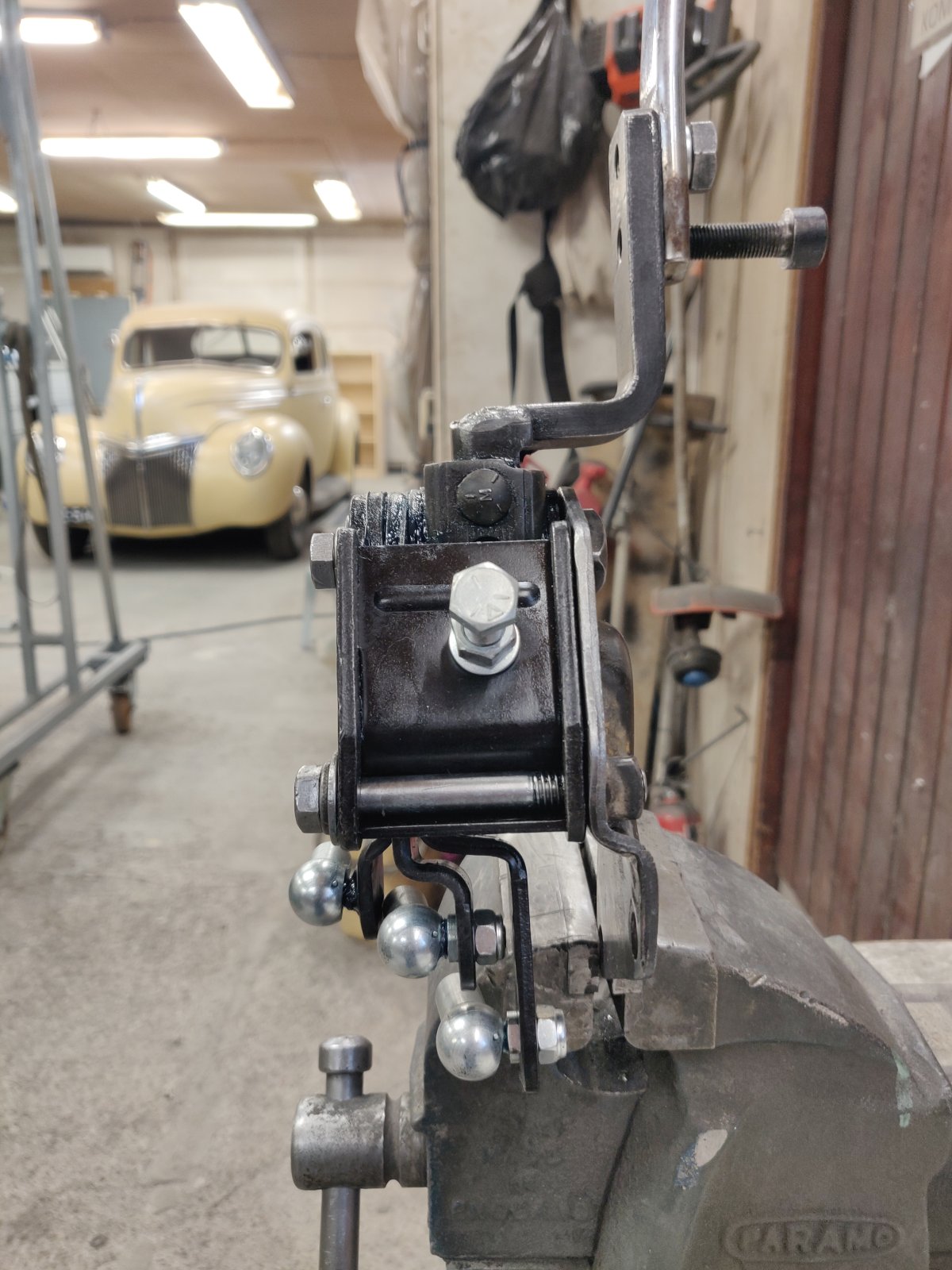

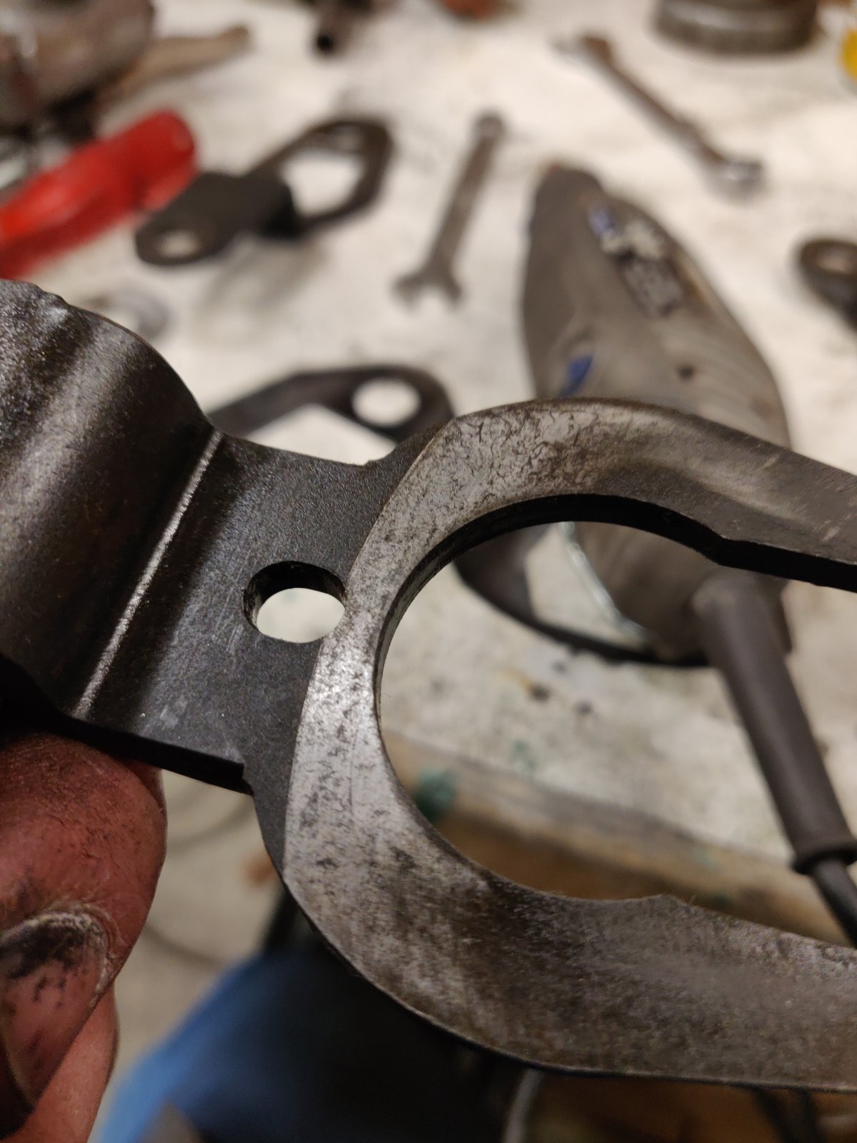

    I also did an service to the hurst competiton plus shifter, and modified it to ball-joint linkage+ new slimmer linkage
    Starting point.
    The linkage taking quite a space from drivers side. Not too much that can be done without major modifications, but i decided to try something. Also the linkage was all worn-out. IMG_20240205_193601.jpg
    Rusty and dirty inside. It was in decent working condition but not smooth operating :
    Taking apart and cleended: IMG_20240216_230449.jpg
    Smoothing the edged for better operation : IMG_20240216_223924.jpg IMG_20240216_224144.jpg
    Cut and add an 0.30mm shim plate :
    Modified the linkage to ball-joints. Could of used the original style bushings, but as i intended to build new linkage so i decided to go with ball-joints:
    Clean, new grease. Was a real bitch of an work to get the springs back in :D
    And the finished product :
    And the new linkage build, and in place :
    IMG_20240224_192115.jpg IMG_20240224_192146.jpg IMG_20240224_213514.jpg IMG_20240224_213539.jpg IMG_20240224_213527.jpg

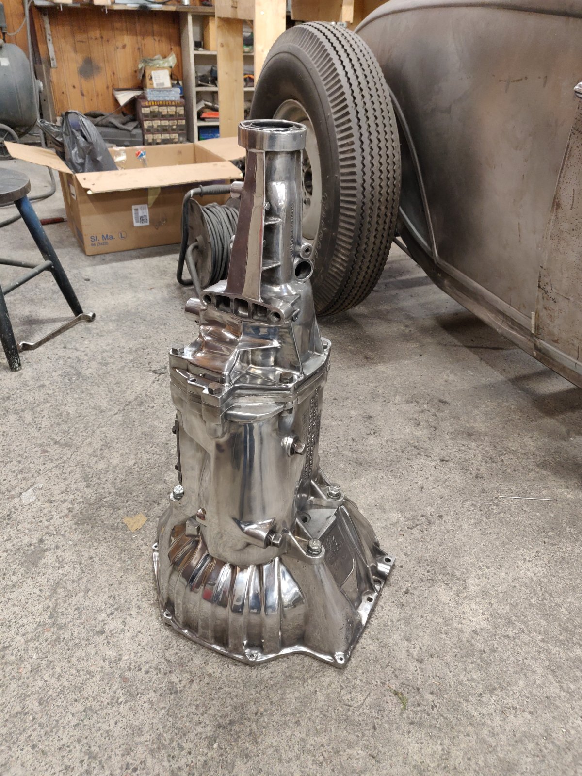

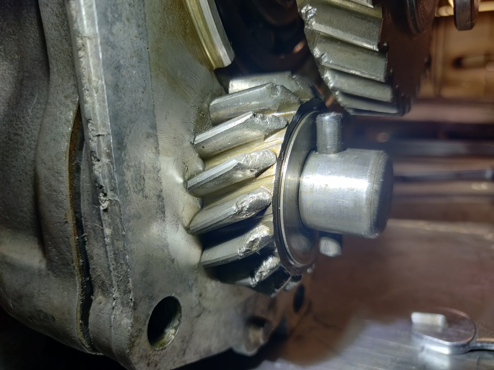

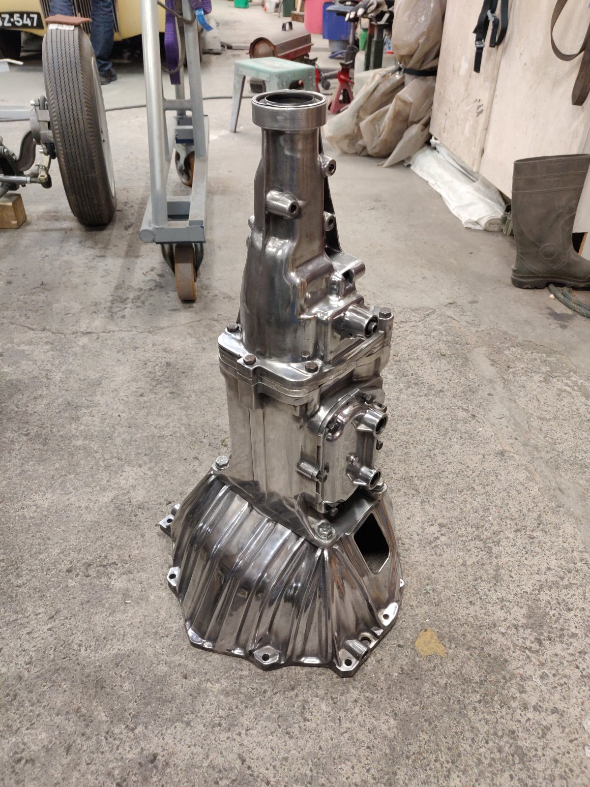

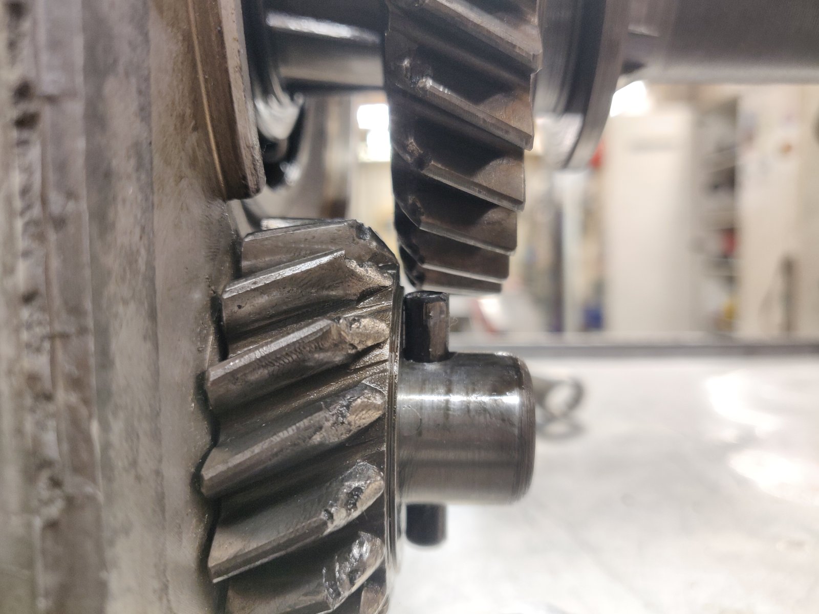

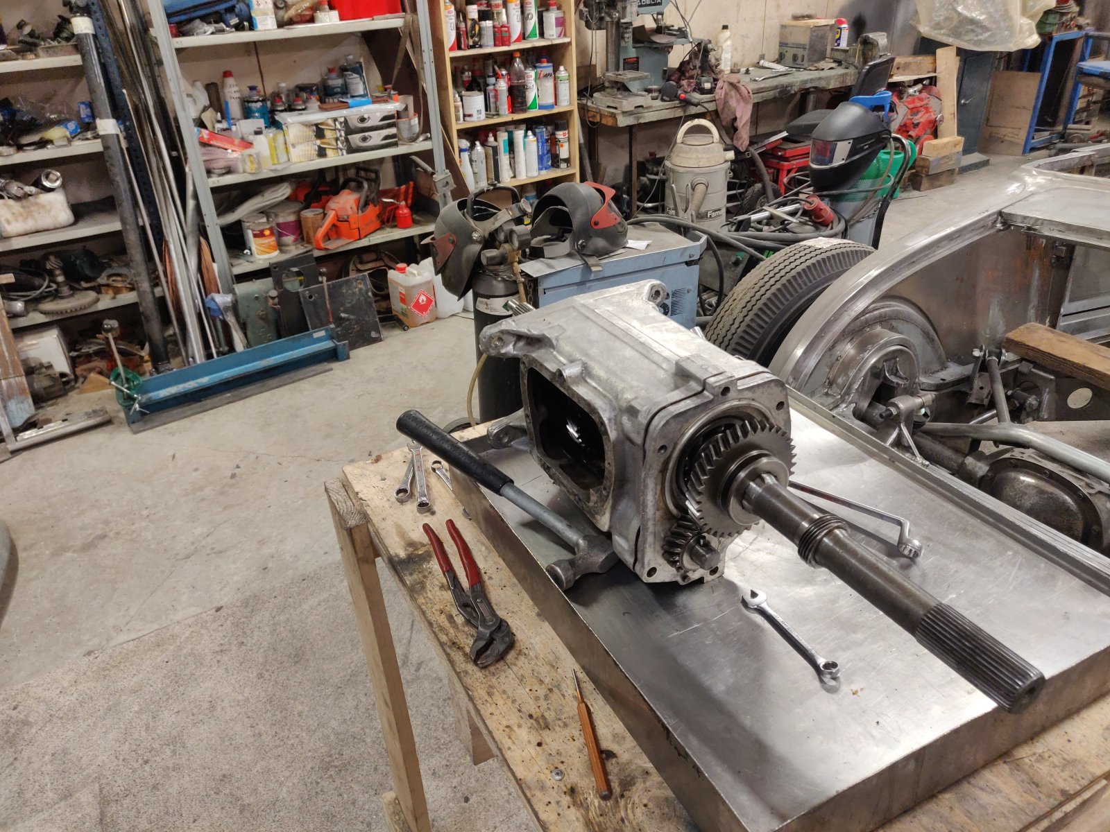

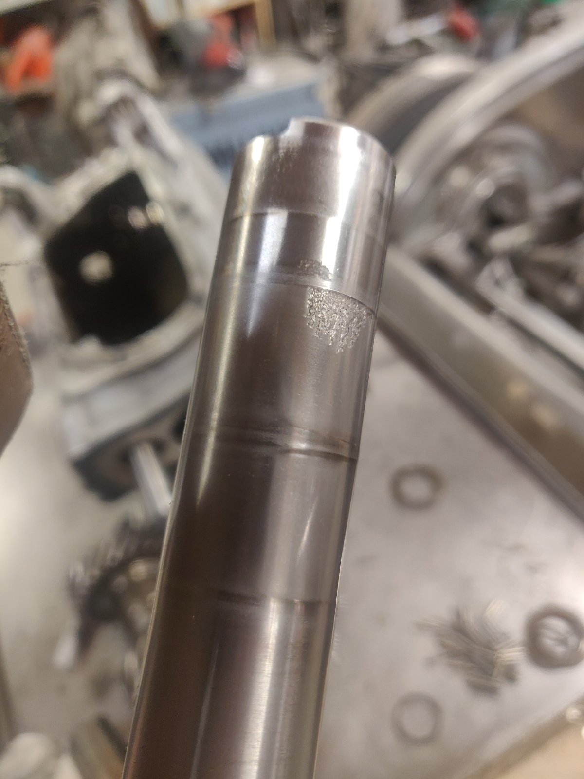

    Plan was to do basic main bearing and seal service for the muncie m21, but there was more to it. The reverse gears and the countershaft pin were toasted, so now it's parts wating from the us. The syncro rings were also quite worn out also, so i ordered them too.

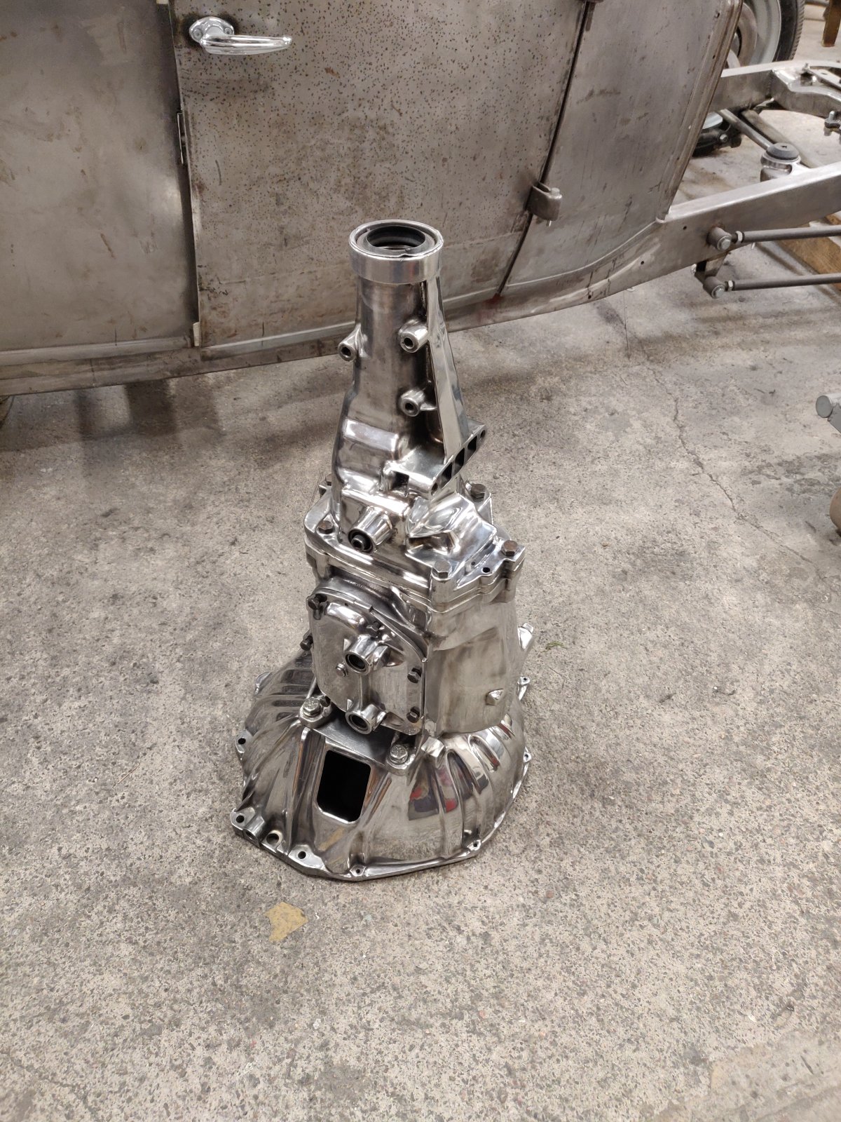

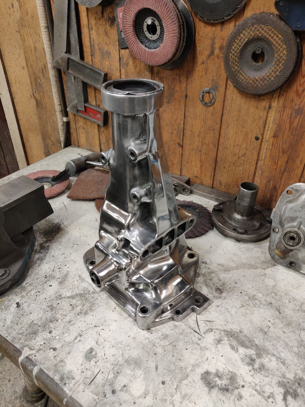

    Decided to polish the cases and bellhousing while wating for the parts. Its nowhere near perfect, but to be thrown to bottom of a car, it will do for now.

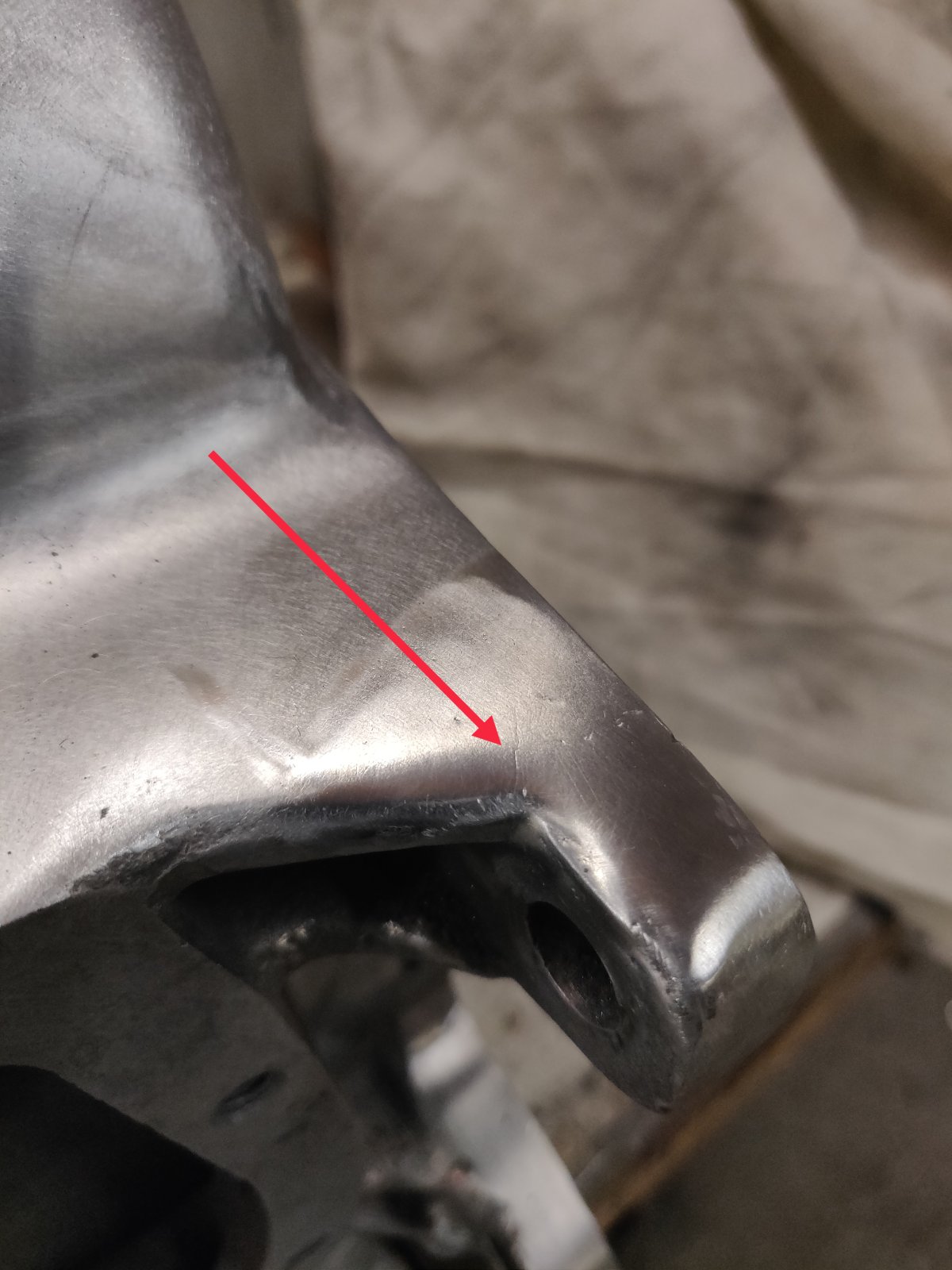

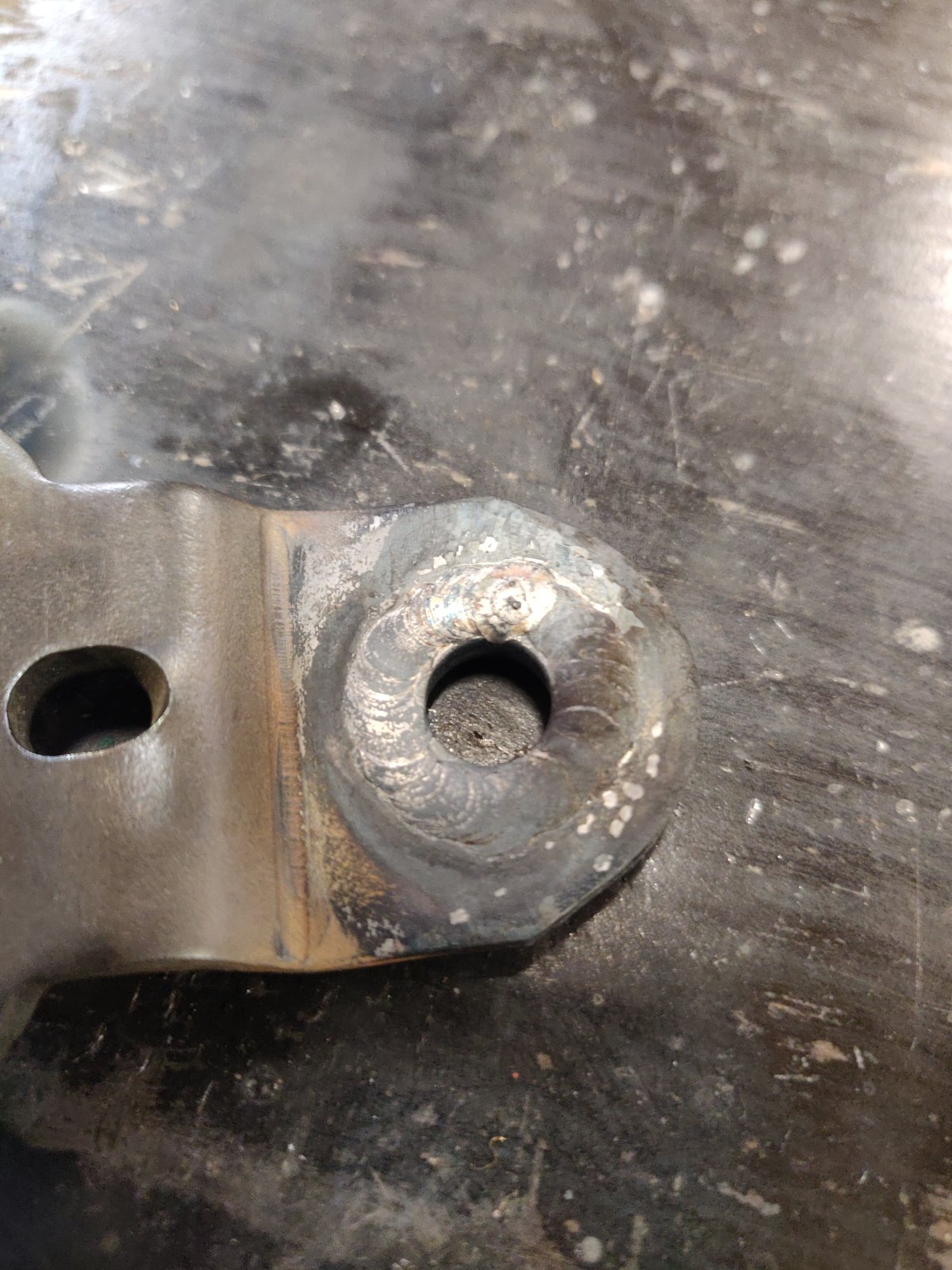

    Also find crack in the transimission mounting ear while polishing, and had friend welded it. Almost not visible crack, but when opened up and welded, it was almost cracked all the way trought
    The crack. There was also one other ear welded earlier : IMG_20240305_213539__01.jpg
    Polished cases : IMG_20240227_214845.jpg IMG_20240310_193653.jpg IMG_20240310_193701.jpg IMG_20240310_193711.jpg
    The parts havent arrived yet, its about 3-4 weeks always to get them from us to finland. Hoping they dont get stuck in the transportation, because there is a big walk-out/strike going on in finland docs

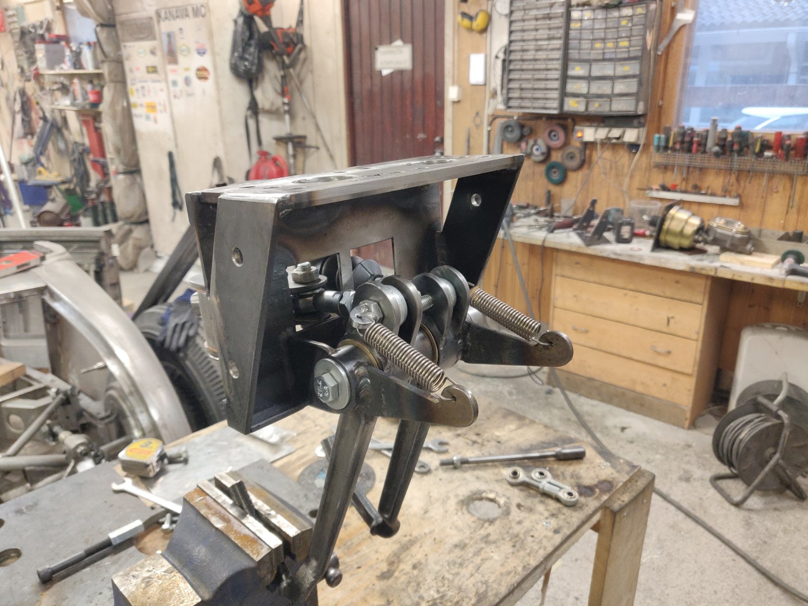

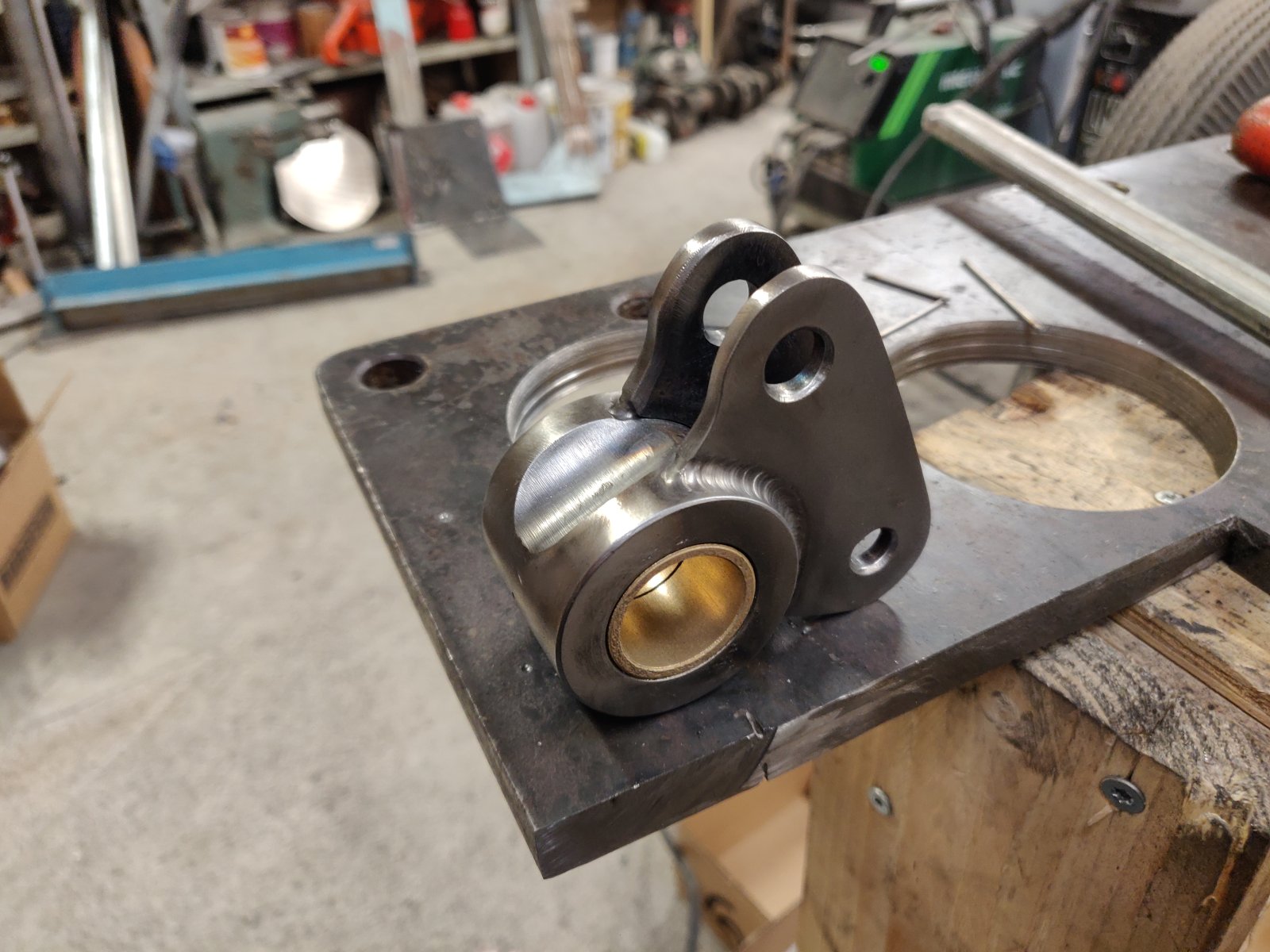

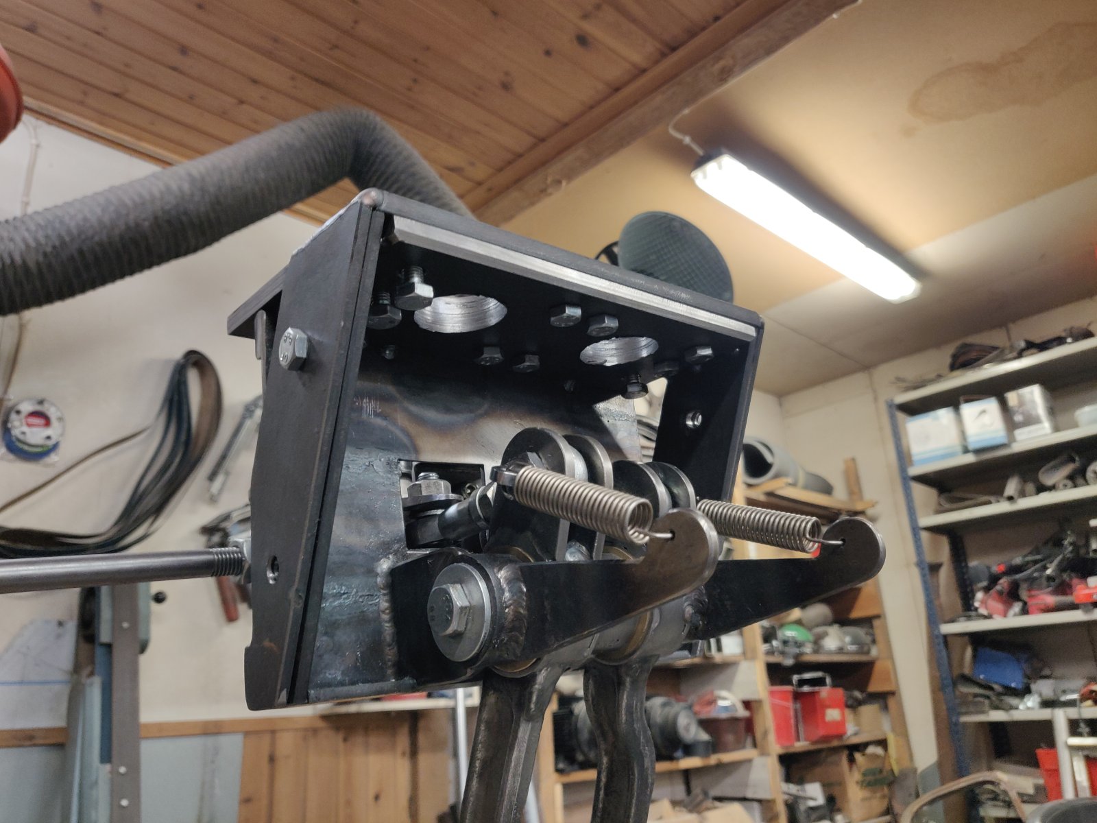

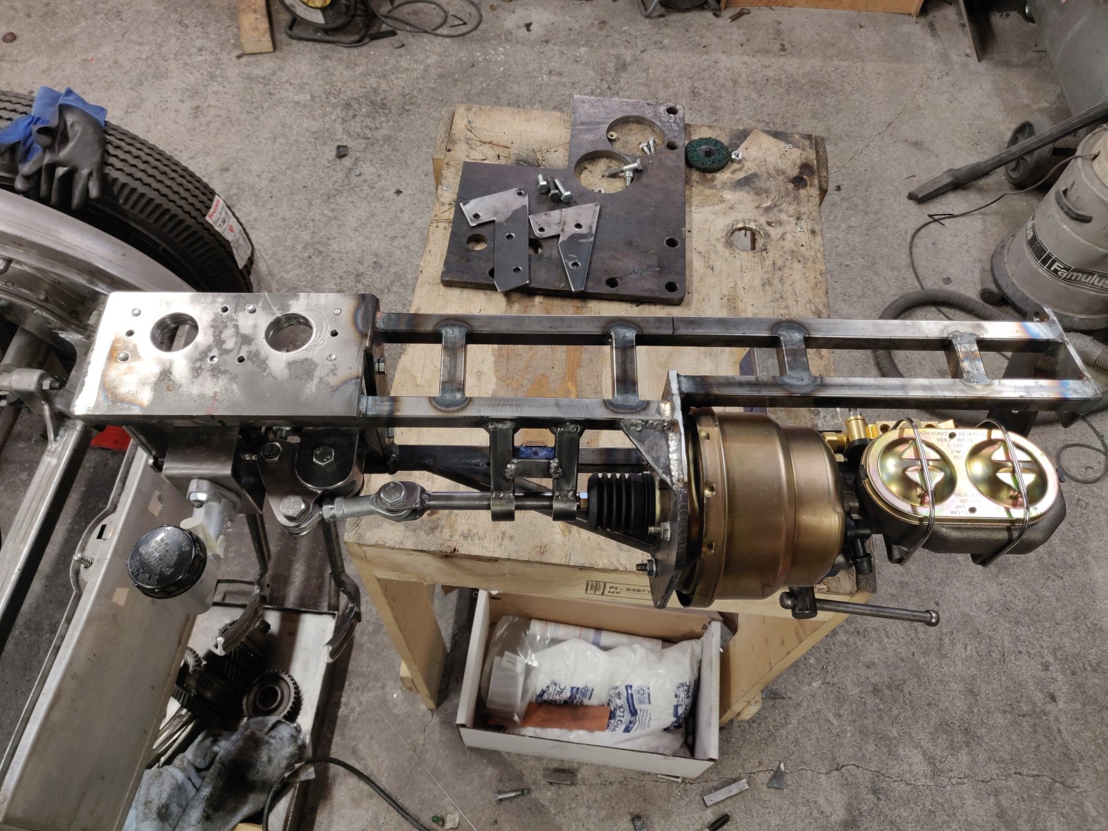

    In the meanwhile started building an 90 degree pedal assembly.
    I was planning on building traditional setup with floor pedals, using the early ford pedals, but the space is so limited with the X-member and i'm planning on building the exhaust all the way back, so change of plans !
    So building early style under dash pedals. These i-beam pedals are maybe f1 ford ?
    Pedals and the 90 degree linkage has oilite brass bushings, with brass (and copper) sliders on sides.
    Brake pedal is 5:1 pedal ratio, booster setup. And the clutch is 6:1 ratio. IMG_20240311_195047.jpg IMG_20240311_202041.jpg IMG_20240311_210126.jpg IMG_20240311_210133.jpg
    Didnt take too many pictures of the process but heres some IMG_20240325_191348.jpg IMG_20240325_191426.jpg
    The 90 degree link: IMG_20240325_191114.jpg IMG_20240325_191133.jpg IMG_20240325_194816.jpg IMG_20240326_164347.jpg IMG_20240326_164416.jpg IMG_20240326_164331.jpg IMG_20240325_205744.jpg
    And this is the pretty much finished product, for so far
    IMG_20240402_190950.jpg IMG_20240402_190936.jpg IMG_20240402_191018.jpg IMG_20240402_190908.jpg IMG_20240402_185834.jpg IMG_20240402_191038.jpg IMG_20240402_191004.jpg
    Heres with the mounting frame bolted on. The support tubing is going to welded to that, and the brake booster/mastercylinder is going to mounted on that.

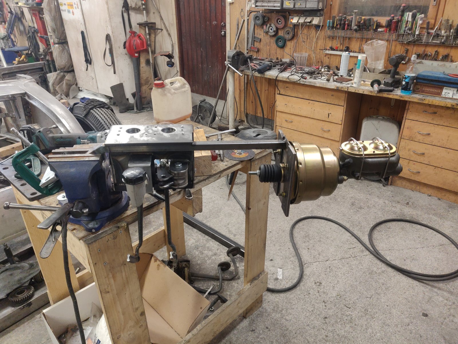

    Mock up. The reason why booster/mc is separated from the pedal box is because it needs to clear the gauges. The usual store setups would be hitting the gauge.
    One thing is sure, this thing is heavy as hell. And other one is it's going to be pain in the ass to fill the reservoir tanks. But hoping the pedal position and exhaust routing makes it worth the effort !

    So the booster is going to be mounted at a 90 degree angle, and under the dash? That's the wildest master cylinder layout I've ever seen. I really want to see what this looks like in the car.
    The polish job on the transmission is beautiful, very nice work.
    rod1, brEad, winduptoy and 1 other person like this.
  12. HelminenHotrods
    Joined: Jun 8, 2018
    Posts: 144
    HelminenHotrods
    from Finland
    Yes sir it's going to be under the dash. You can buy these sort of setups from Kugel Komponents and even from ebay the chinese crappy ones :D
    The Kugel one looks like this :
    I dont think i'm able to hide it all the way inside the dash. But trying best to make it not stick out
    Deutscher, Okie Pete, brEad and 3 others like this.

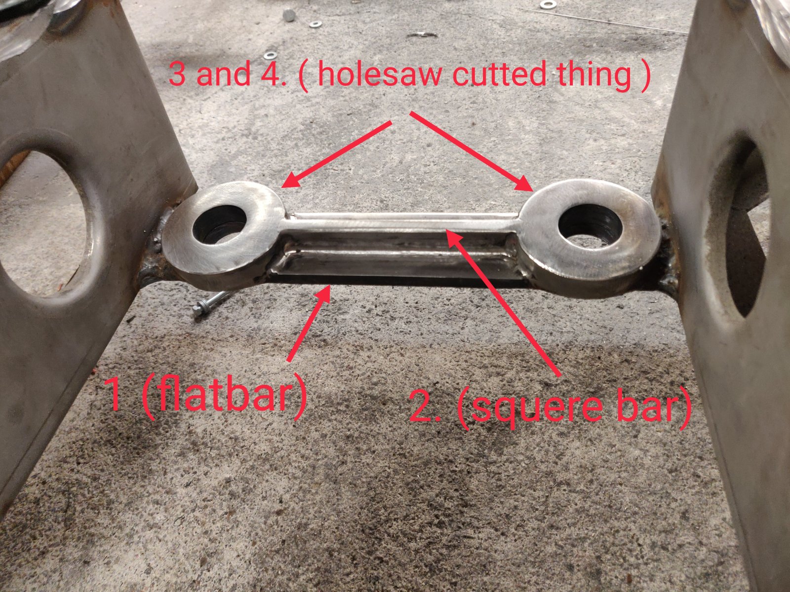

  23. AmishMike
    Joined: Mar 27, 2014
    Posts: 1,314
    AmishMike
    Looking at fantastic engine & tranny mounts again. How many pieces did u weld up for that tranny mount? A quick drawing off all the pieces would be amazing. Tks
    Tow Truck Tom likes this.

    from Finland
    Hey Mike !
    The transmission mount is pretty much Flat bar with flavour. Major elements are made of 4 pieces. The bottomside small edges were added for better looks, those were 4, kind of half moon shaped.
    The upper one, that bolt on to the transmission is made of flatbar.
    Heres some pics
    Used some holeshawing leftover for the round parts. This motor mount holesaw cutted piece left the leftover round piece from the inside, to be used in the transmount

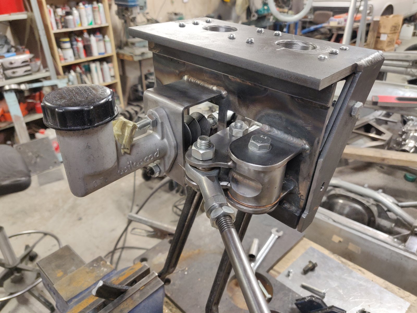

    The pedal/booster/mastercylinder assembly is done for now. Time to start thinking about mounting it to the body.
    Added couple slider bushings for the booster rod, to keep it perfectly straight throught the motion.
    Booster is set up further to the passenger side, because it needs to clear the oldsmobile gauge.
    Gas pedal i'm going to ad later on
    IMG_20240406_221400.jpg IMG_20240407_184950__01.jpg IMG_20240407_184955.jpg IMG_20240423_202049.jpg IMG_20240423_202207.jpg IMG_20240423_202330.jpg IMG_20240423_202223.jpg IMG_20240423_202249.jpg IMG_20240423_202346.jpg IMG_20240423_202317.jpg

    Where is your revised shift lever going to be in relation to your seat? Are you using bucket seats?
