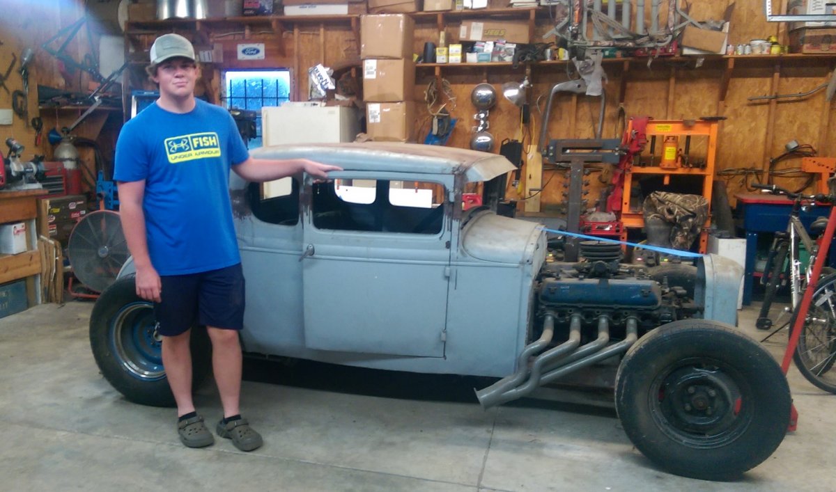

    That's like jumping ahead to the middle of the book! But here you go. three qtr.jpg

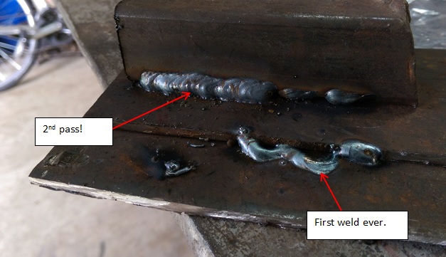

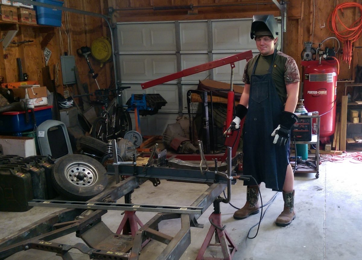

    Yep, it's all about getting the kids involved. My 18 yo ran his first weld bead Sunday. Luke First Weld.jpg
    He got the hang of it pretty quick so I let him weld up a motor mount jig.

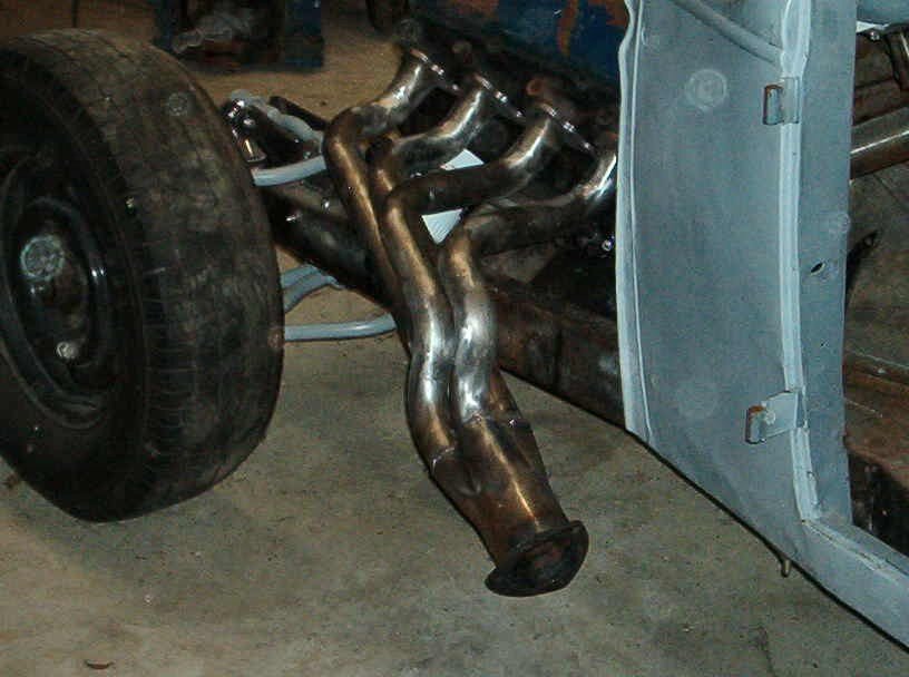

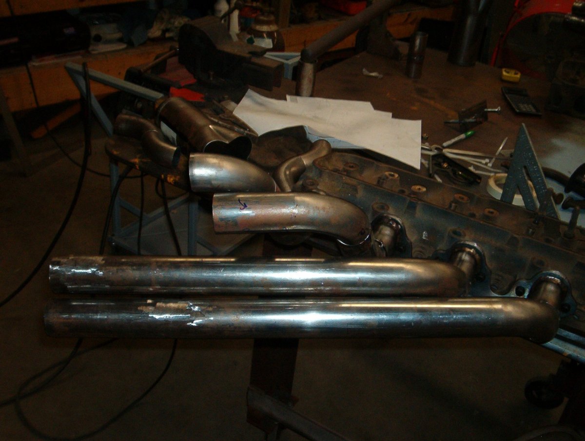

    One does not simply go to O’Reillys for 460 headers in a Model A so I ordered a ****** header flange kit and a bunch of U-bends and J-bends to build my own. That was a job. Next time, I’ll do it with a TIG instead of a MIG.
    Dad did make it back over to help around this time. He had previously chopped it 2 ½. I wanted a 4” chop so he came over to help me do the deed. The power went out while he was there, so we hooked up a Sawzall and worklight to the generator to make the cuts. Fun times.

    My youngest Luke, now 18, has always been a truck kinda guy. I offered to build an old Mustang with him for his first car but he wanted something that could sling mud and haul deer. I bought him a ’94 F150, simple enough for him to learn some wrenching skills.
    I noticed he had been watching a good bit of street racing on TV lately. All of a sudden, he mentioned he wanted to get into cars. Maybe the Run What Ya Brung Drags in Reynolds, GA back in 2005 finally stuck. Some kind fella let him sit in his FED.
    I think he actually only said “Dad, I’d like to build a fast old car” but what I heard was “let’s get back on the hot rod, do a ridiculous amount of work so you can teach me how to fab, weld, wire, build engines and make everything we can’t buy”. He’s never been overly interested in my Fairlane, so I decided to sell it to make room for and finance the coupe build. The Fairlane is sold and I’ve gotten him involved already.
    First thing we did was some ride height mock-up and then we stripped off the IFS.
    Now I realize he might not have gearhead disease as bad as I would like to imagine, but his interest thus far is enough. That mere suggestion was all it took to reignite the hot rodding flame in me. That and Dad’s health. I want to get my kids on this build while I still have them at home. I want Dad to be there when I fire it up and get it on the road again, with him behind the wheel. This time, we’ll make it to Fincher’s come hell or high water.

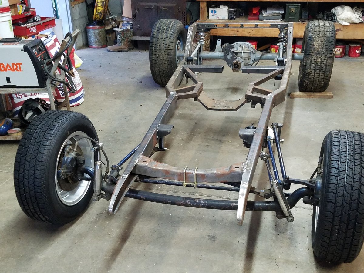

    First things first: getting rid of the IFS. I got a complete front end out from under HAMBer johnold1938's '32 roadster. It's an early Pete and Jake's tube axle and four-bar set-up from the early to mid 70s. That's traditional, right? It uses 1967 Volvo 122 discs, which is kinda weird but all they had back in the day.
    I mocked up the front end to evaluate ride height. It's sitting about 2" higher than I originally planned. I might have to consider dropped spindles, spring behind axle or whatever.

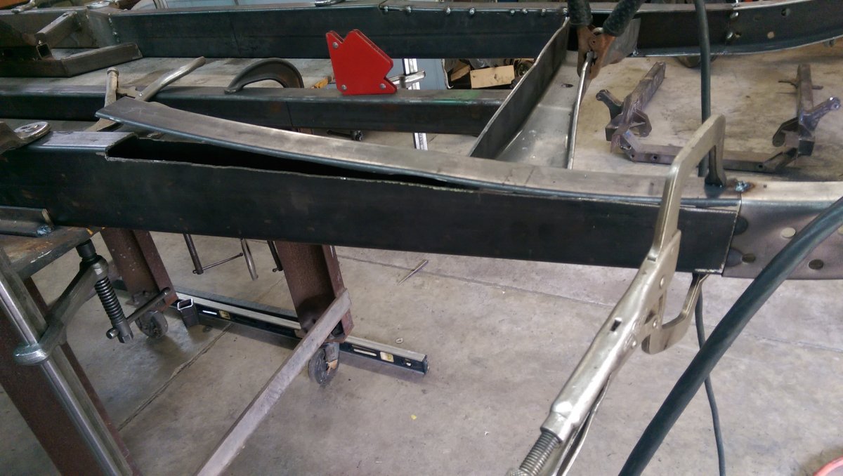

    the rails were straight (no inboard taper) with the IFS). I was going to pie cut and angle the rails in but there was still a lot of work to grind off all the old brackets. I decided to lop the whole front end off the frame off and fab new forward rails.

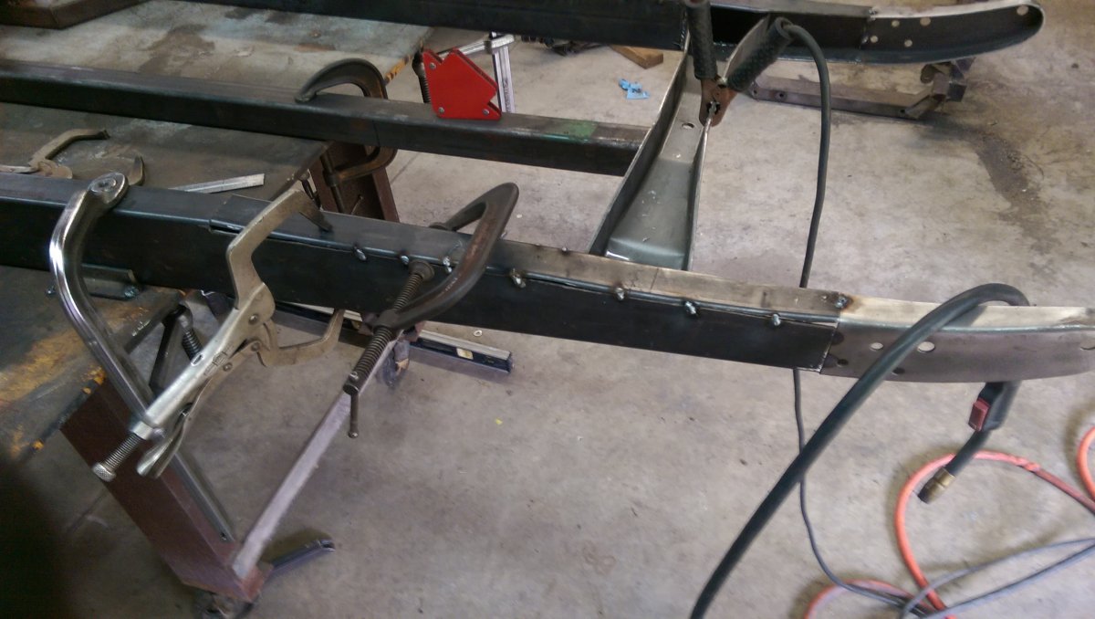

    I fabbed new rails with 2X4 X 11 ga tubing. Using repo Model A frame horns, I taper cut the rails with a cutoff wheel.
    I don't have a fancy ch***is jig but I do have a 4' X 4' wending table that's 5/8" thick. It's fairly flat if you ignore the 1/8" dip in the middle. It makes a good ch***is jig if you don't mid working in sections. In this case, I already had the whole back half of the frame.
    I started off by laying out the frame centerline and key dimensions taken from my CAD drawings. A sharpie marker works quite well. After that, I clamped 2 X 2 tubing to mark the centerline and then installed the rear frame on the table.
    I welded angle iron to the table, which served as front rail locators.
    Since my table isn't completely flat, I spanned the new front rail and old center rail with another piece of 2 X 4 tubing. This straightened the rails suitably for welding.
    I added the front crossmember at the 103" WB location.

    Capped the tapered front rails. Residual stresses in the tubing roll form-and-weld manufacturing process cause flanges to curl up when you cut them off. So you have to tack, clamp, tack to make them flat.
    Deutscher, Stash31 and els like this.

    The old Pete and Jakes front end is installed. It still sits a little higher than I want, even with a couple leaves removed. It's riding on Towel City front runners.
    I fabbed motor mounts form 7 ga sheet. Some of my favorite side tasks are drill jigs like this one for the motor mount bolts.
    The 351C and toploader were dropped in just as soon as I tacked the motor mounts in place.
    Deutscher, roddering, AHotRod and 3 others like this.
