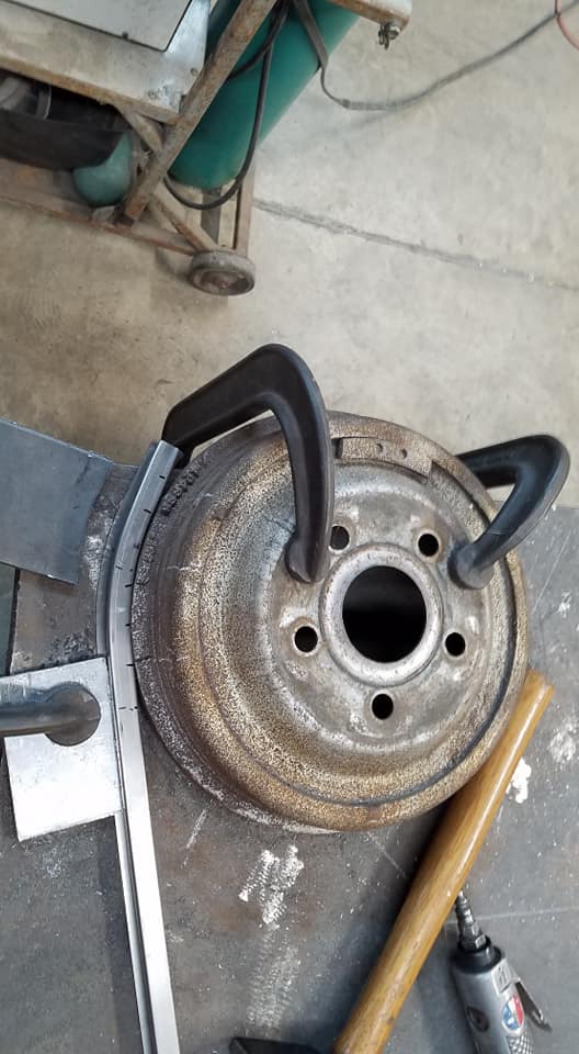

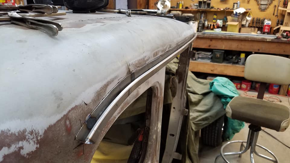

    I used a Ford 10" drum to bend the straight Bratton's drip molding. I made a hammer form dolly from 1/4 plate by cutting a radius to match the drum. A piece of 1/2 tubing was placed inside the molding to keep it from collapsing. The 3 lb hammer provided motivation.

    great idea for bending the drip rails, I will copy for my tudor!

    On the note of drip rails, how did you end up attaching them? I keep worrying about water getting between them and the body.
