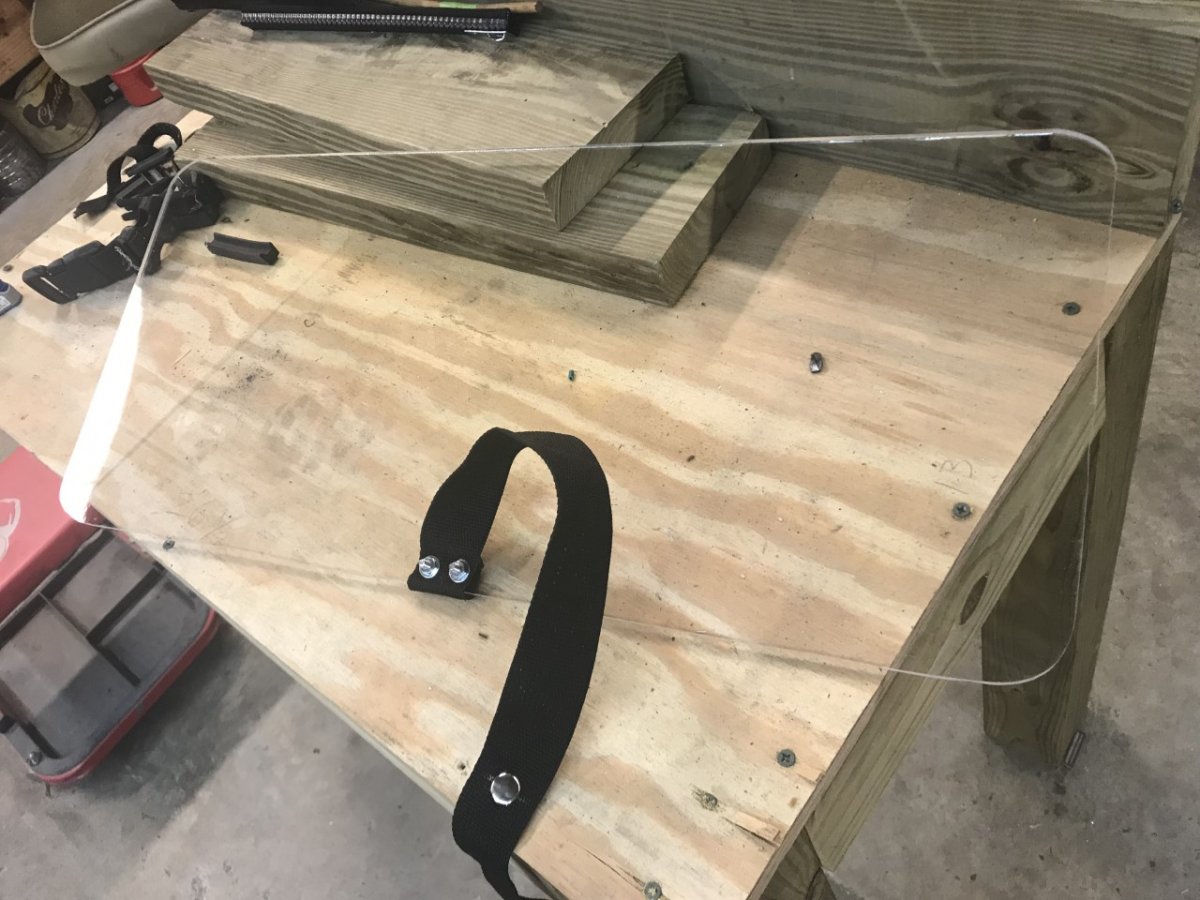

    60's drag car style Plexiglas windows with nylon webbing and snaps in lieu of regulators. Vintage seatbelt material would have been better than the generic nylon but, in true hot rodder fashion, I used what I had.
