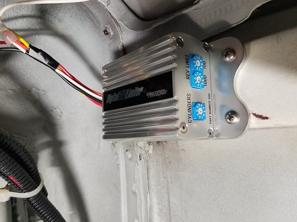

    I was already running a Pertronix distributor so I added their rev limiter. It's hidden out of sight under the cowl. It doesn't work like your typical rev limiter. When you hit the limit, it randomly steals spark until you back off the pedal. It's pretty slick.

    What rpm do you have that limiter set at? I'm running an MSD dist, box, and limiter in my Hiboy on the SBC.

    Dave, it's set on a fairly safe 6100 rpm. That ought to keep me out of trouble in the burnout box.

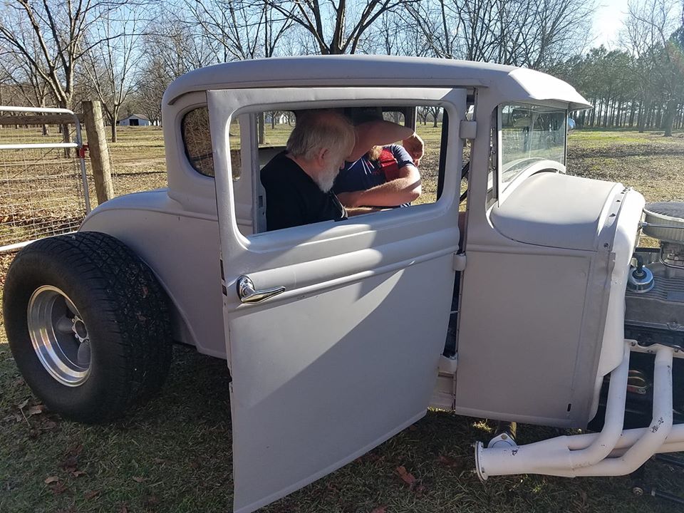

    Dad helped me thrash on the original build back in '99. He didn't get to ride in it then and I parked it in 2000. He moved a pretty good distance away before I got it running again last year.
    The stars finally aligned yesterday. Dad came by on a day of perfect weather. 24 years after he gave the body to me, he finally got to ride in the hot rod he started so long ago.
    Every builder imagines what it will be like the first time his car comes to life. It's the pot of gold at the end of the rainbow, the reward after countless hours of hard work. I hope yesterday's ride was every bit as cool as he always imagined it. I hope he knows how special that moment was to me.

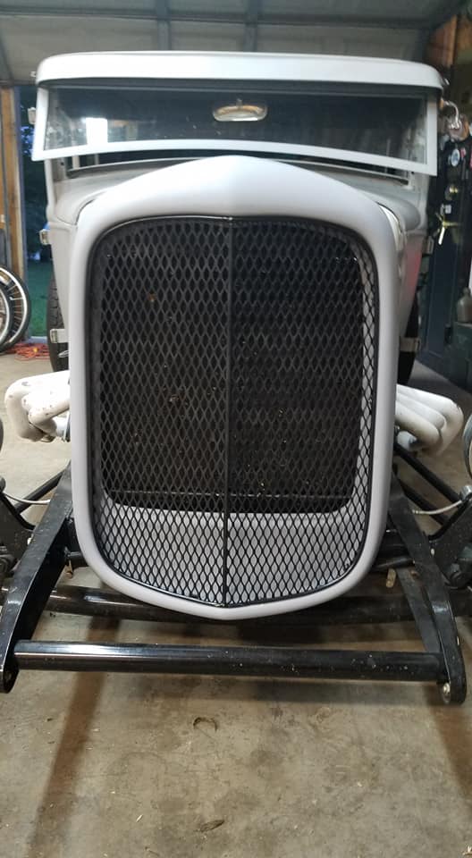

    I had a bird hit the radiator the other day. It didn't do any damage but I thought it might be time for a grille insert.
    I used 1/4" brake line for the perimeter. I started out using a tubing bender but found that it was easy enough to bend by hand. I welded a few 1/2" X 3/4" 16 gage tabs to fasten to the grille shell.
    The hardware store had some light gage expanded metal that looked like it would work so I picked it up. A buncha light welds holds it in place.
    All told, I had about $15 in it and it only adds 2 pounds of weight.

    Looks nice Brian, and it looks as if it will keep out the birds and the bugs, that is except those damn gnats:eek:

    Nice job. Ought to help considerably.
