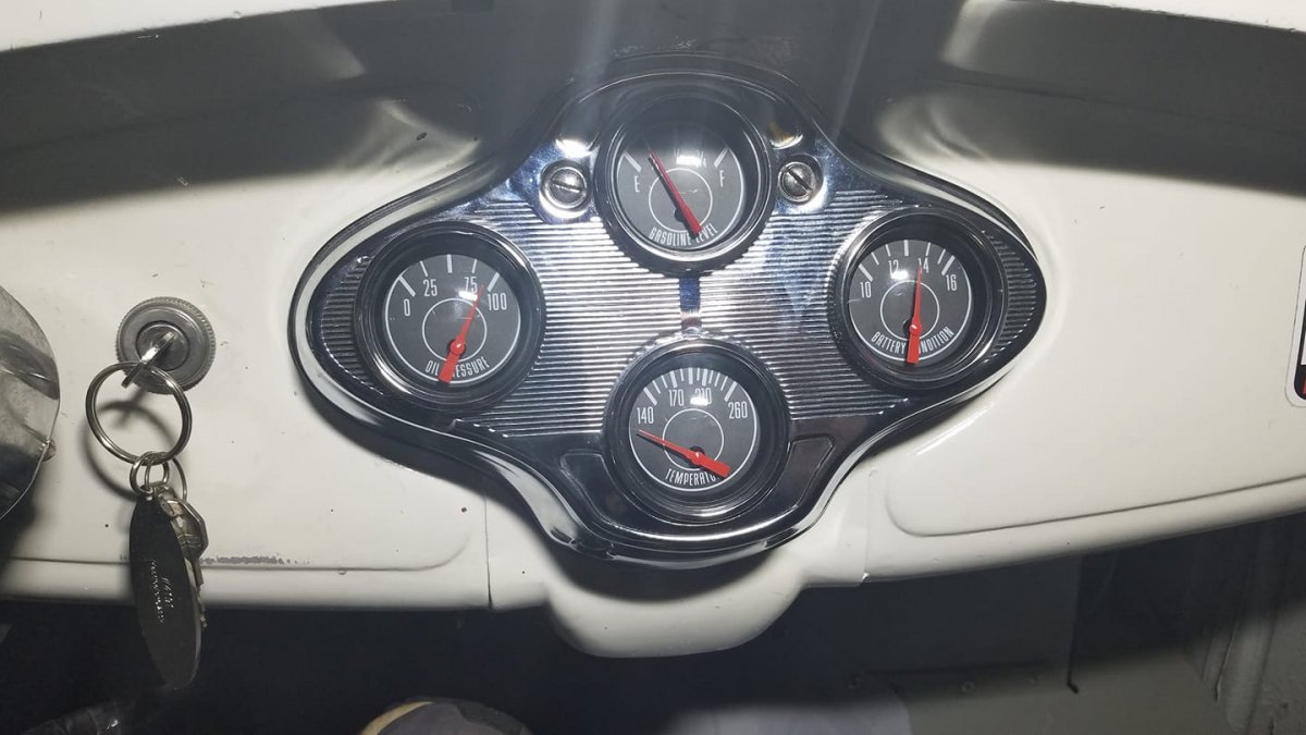

    I upgraded the gages to New Vintage USA 1967 series. I think they fit the build theme pretty well. gages.jpg
