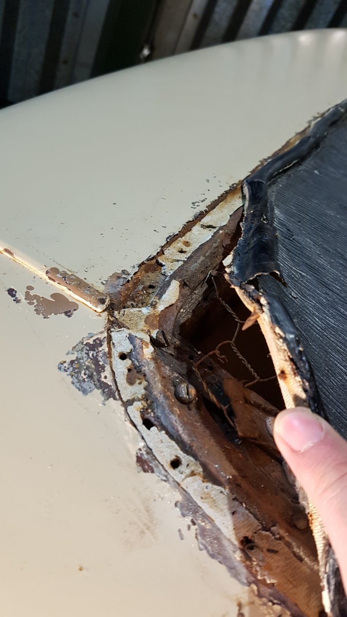

    Last problem for now which I hope someone here has some advice on, is the roof material. Heres the horror:
    The chicken wire fills me with confidence............ My understanding is that the material is secured to the wood underneath (hoping that it's not rotten) with nails that go through some sort of edging strip. Is this right? I'm hopeful that I can strip it all off, treat the rust and attach new material. Can anyone point me at any guidance for that?

    That car looks like an excellent place to start from. The top material can be obtained from various old Ford supply places and there are videos on youtube on how to do it by Classtique Upholstery.

    That car looks in pretty good shape. Yes, they make a welt material that hides the nails in the roof fabric attachment. Should be able to order the roof material and assorted hardware from places like Macs and others.

    Doesn't the chicken wire support the wadding for the vinyl insert over the wooden roof frame bows as per H Ford Esq intended?

    Thanks everyone for your comments and advice. I happened to put my post up and then start reading a book so I'd already sussed out that the chicken wire is indeed original, I guess the roof has never come off or, if it has, someone did a good stock resto on it. I like the idea of filling the roof panel but that's for some time down the line, for now I will replace the material and make repairs to the wood if necessary.
    I've read about that Classtique video before but damned if I can find it on their channel. Maybe it was hurting their business in replacing the roof and they took it down :p

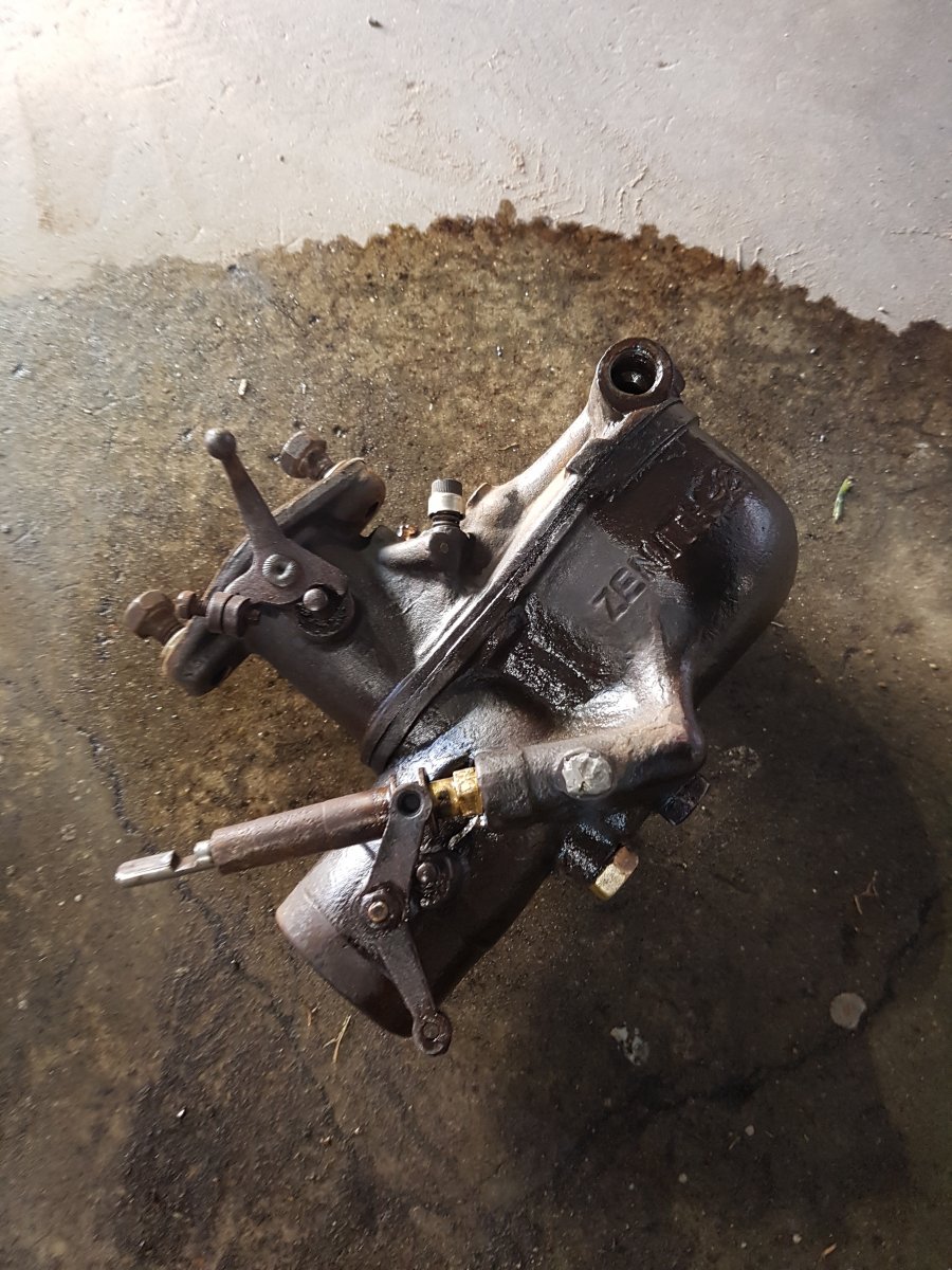

    My main problem is I still haven't driven it! First I ran it out of fuel and then today I put more in, turned the tap on and immediately petrol (sorry, gas) started pissing out of every part of the carb! This obviously wasn't a problem when I got the car because it ran and was driven onto the trailer. Judging by the crud in the filter bowl though my first guess is something has got stuck in the seat so it won't shut off. Does this sound likely? The fuel appears to be coming out of the bolt underneath which is the main jet by the looks of the diagram. Genuinely never seen a carb leak so much :(
    Guess I need to buy gaskets and then whip the carb off....

    You should check the gas tank for rust. It sounds like a bunch of rust has washed down and gotten into the carburetor. Common problem for these cars after sitting in storage for a long time especially in a humid atmosphere. Some tanks are repairable and some are not. Clean out the sediment bulb. Remove the gas line at the carb and see what comes out when you turn on the gas. There is also supposed to be a fine mesh screen in the fuel inlet on the carb that may be missing. Dismantle the carb to see what's in there and clean it out. There is a fine mesh screen available that fits up in the tank that will catch the big hunks. I have a tank on my '29 that has so much rust I can't use it. Even liquid tank liner won't fix mine.
    Put new gaskets on the carb drain and the bolt that holds the halves together.

    Yes, its a gravity feed fuel system, so if the float sticks or needle leaks fuel will flow nonstop. Always turn off the gas valve when parked. Its a very simple carby , just take the top off and blow it all clean. Make sure the float is free to travel and not sticky and try it again. perhaps but a new needle and seat with your next order of parts just to have in stock. I like to use an inline filter too as the sediment bowl will let some fine stuff get past.

    So I pulled the carb off, as soon as I touched it fuel was leaking out.... Here's the victim:
    It feels like someone dismantled it to clean crud out and then put it back together without new gaskets and without doing anything up more than finger tight. So I took it apart, checked everything and found that the brass float was full of fuel, that definitely isn't going to help things. I need to resolder that then I can put it all back together with new gaskets and a filter.

    Unless your dead-set on the original style soft top, this would be a good candidate for a steel insert.

    Your carb is fuel of fuel because your fuel shut off under the dash (maybe on the firewall on a '31) isn't closing completely. You'll need to address that as well. A rebuilt carb with a leaking shut off valve will still leak fuel...

    And soldering the float will be fun, ask me how I know.

    I wouldn't say I'm dead set on it but in the short term it's a quick, cheap and neat fix. I'll reconsider when I get itchy and take the car apart!
    Shut off works great, thing has been dismantled fora couple of weeks and not a drop of fuel has made it from the tank to the sediment bowl.

    Don't solder the float! Can you say, "BOOM!"? Just buy a replacement float. Cheap and easy.
