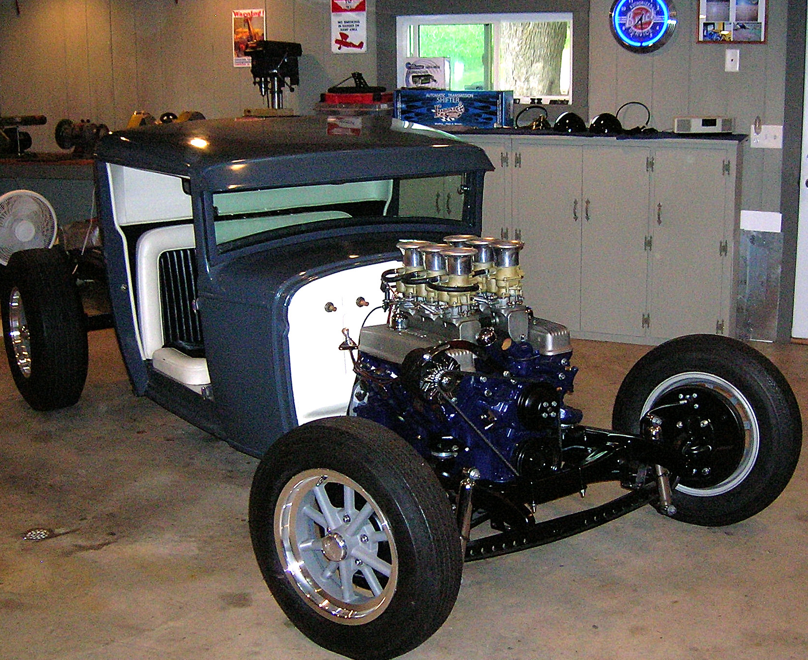

  7. El Hueso: The engine is a 54 Roadmaster 322, we went .030 over which puts it around 327 cu in, the cam is basically stock cam that was reground by Berry Cam Service, Minnesota. All internals are new, the heads are stock with all new stuff. I don't expect a lot of HP, but think it will be a great engine, given the low torque these put out. I changed the rear end from 3.70 to a 3.08, with the 350TH ****** it should cruise real nice. Should dyno the engine is a week or so, I'm finishing the wiring now.

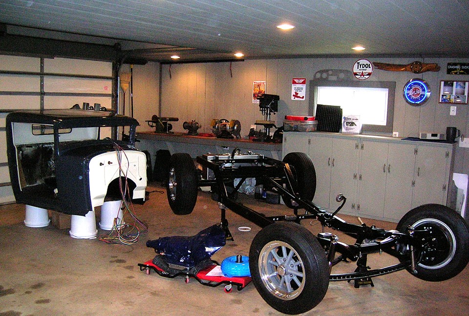

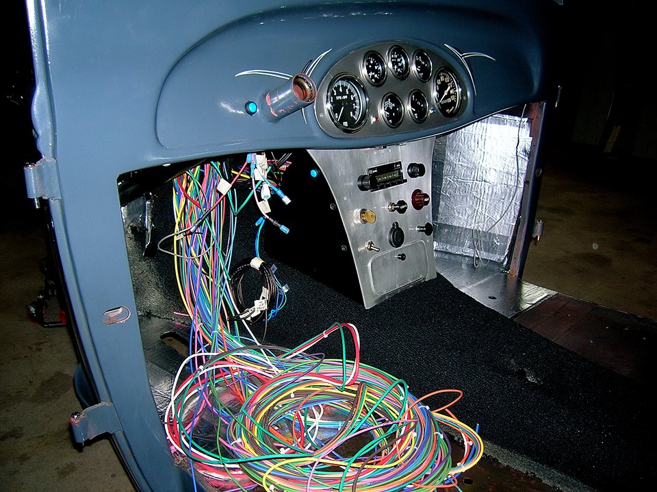

  8. 10170814_772784326087835_3914244836338962449_n.jpg 10298672_772784649421136_6771460285998932842_n.jpg 10298734_772785356087732_316982200631799260_n.jpg The wiring is coming along nicely, using Bob Miller's 9-3 set up from Rebel Wiring,. The ch***is is finished, bled the brakes last evening, everything is new or rebuilt. Still waiting on the engine to be dyno'ed, should be any time now. Got the new tires and wheels on.

  10. DSCN9352.JPG DSCN9345.JPG DSCN9345.JPG Just got home from Mankato, we ran my new (1954) Buick engine for the first time this evening, it was dyno tested by Steve Wenzel, it runs and sounds great, made my socks roll up and down. this engine will be at home in my 31 Model A. I'm as happy as a little girl!! DSCN9352.JPG

  13. DSCN9390.JPG DSCN9389.JPG Got the new motor and transmission in the ch***is yesterday, set the body on the frame today, I have over 1.000 hours in this build currently, it is progressing well.

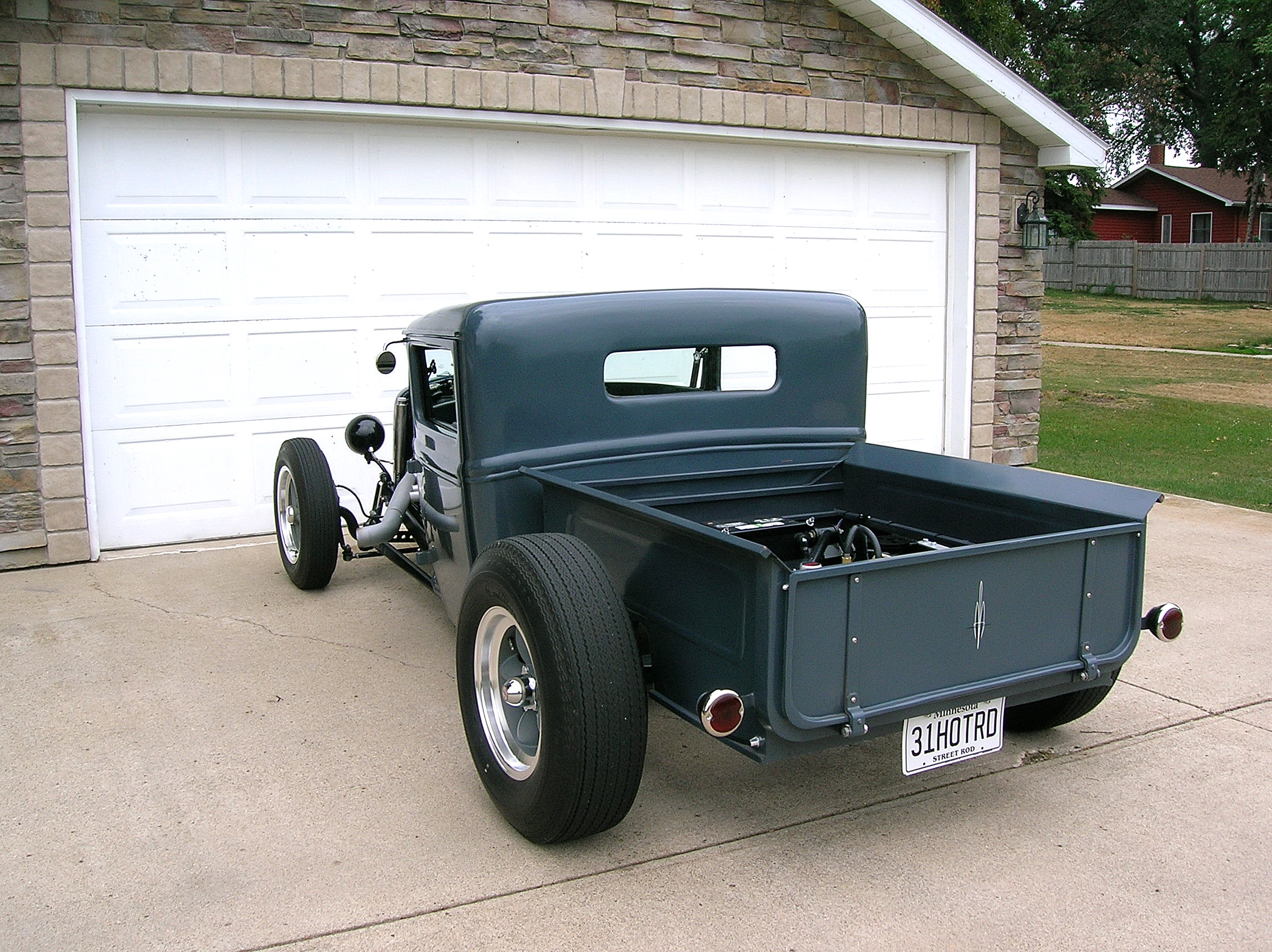

  21. Got the Model A on the road, 1400 hours of labor in 14 months. Running great, still has that Buick rear main oil leak, not too bad but annoying. I'm lov'in this motor, sounds great and DSCN9463.JPG DSCN9464.JPG lots of torque, changing to the 3.08 rear end makes this so much better on the highway, no strain at all. This is a HOOT to drive. Very happy with this build.

  25. I have been driving it most every day, 300 miles last week, still working the small things out. The Buick is performing well, very happy with that motor.
