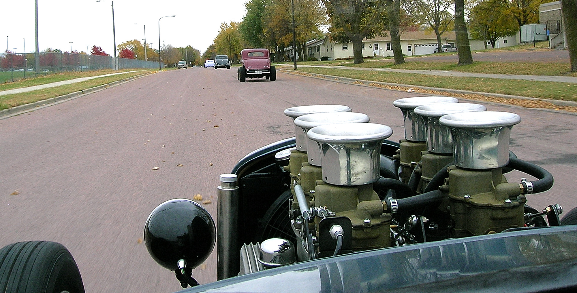

  4. Just read your complete thread, That is a great looking pick up. Did one pic show the carbs on reversed. What is the reason for that. Nice colour too.
    1927graham likes this.
  5. I don't see a picture with the carbs reversed, never had them on that way, no need to. Thanks for looking at my thread, will be adding more in the near future.
  6. Graham, Really love the truck as I said, but I have always run the carbs with the float bowls to the front. I just wondered why you have yours to the rear. My 6 carb hemi intake only lets me run the bowls to the front. Just interested, that's all.
    Cheers Phil.

  12. Went through the carbs, got the correct power valve set up in, stripped off all the **** (Eastwood paint), changed out the fuel lines to banjos, reworked the linkage, had both intake manifolds media blasted and chrome ceramic coated by Race Coating, Forest Lake, MN, they did a fantastic job, recommended. Also rebuilt the 40 Ford steering gear with new gears, bearings, etc., I'll put that back in the car tomorrow. DSCN9575.JPG DSCN9576.JPG

    but those Buick Manifolds I think can mount
    in either direction. And I've seen both.
    So they are really not "backwards"
    Just my $.02
    volvobrynk and 1927graham like this.
