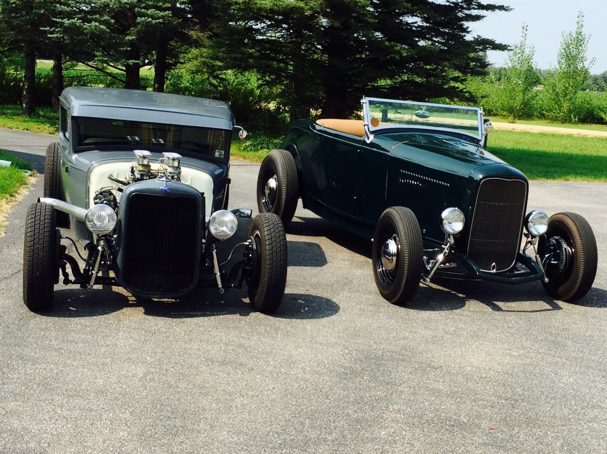

  22. Spent the day hanging out with Eric Hendrickson, he was driving his beautiful 32 Ford roadster, fun stuff in Mankato, MN.

    AHotRod, Hotrodmyk, Roadsir and 2 others like this.
