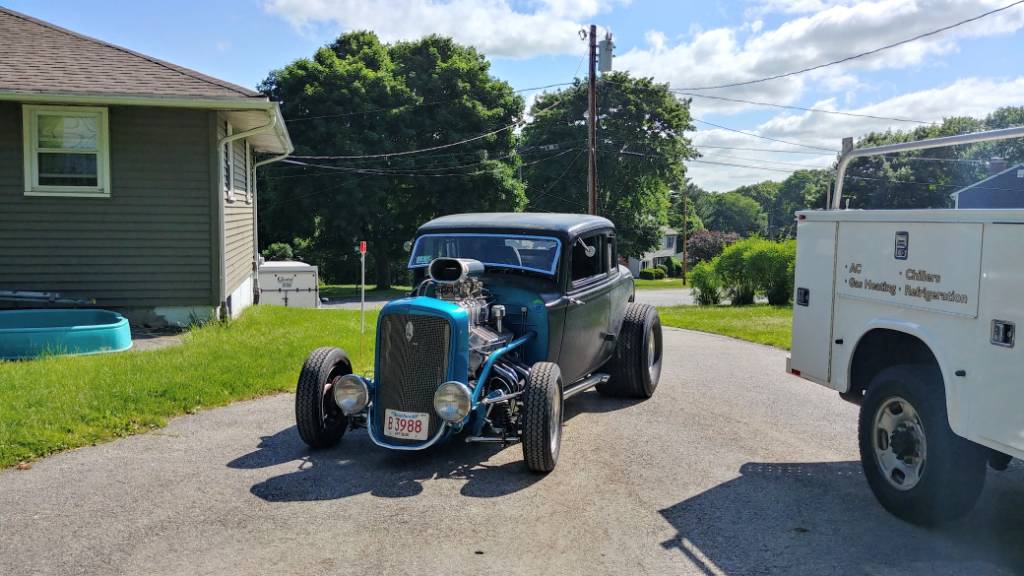

  3. Joe Lemay
    Joined: Nov 28, 2010
    Posts: 106
    Joe Lemay

  4. Mike Colemire
    Joined: May 18, 2013
    Posts: 1,431
    Mike Colemire
    Joe, let's see a pic or two of that, looks like a nice hot rod. I'm going to have to decide what I'm going to do on my 28 sedan. Thanks for the info, some of your best ideas you stumble on.

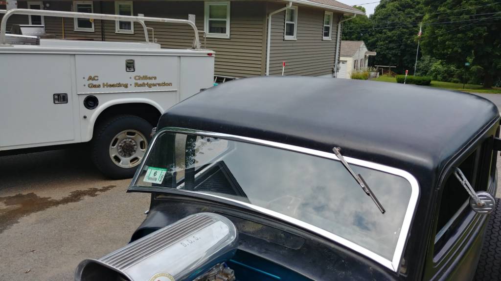

  5. Joe Lemay
    Posts: 106
    Joe Lemay
    Thx Mike, back to the Sedan issue. In other conversion another gentleman said he used a Volve wagon ...no ribs for a smooth roof which I thought was a great idea.
    In Fla. last winter saw a guy that used a Dodge Durango, he said off a '04.
    Again, using the Jeep I had to close the opening a couple of inches after trimming the patch, Made 3/4 x 3" strips and using a drinker made up the gap.
