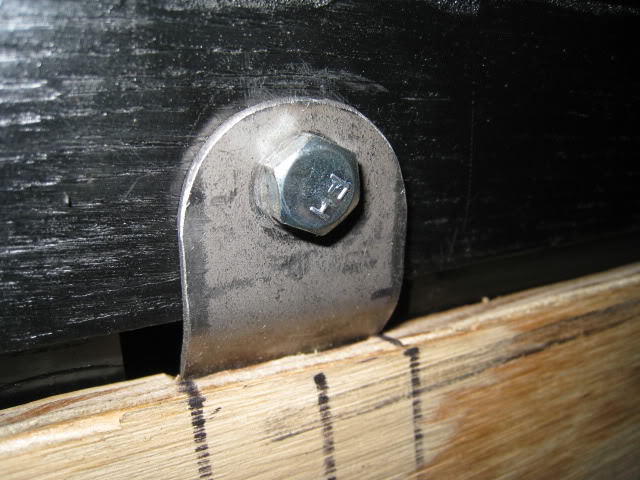

    It's just plywood that I'll glue high density foam to and cover in black vinyl until I get the real upholstery done. The back of the seat bottom rests on and bolts directly to the floor and the front has a riser made from a 2x6. I made all the tabs out of 1/8" stock and welded threaded bungs into the floor so it's easily removable. The seat back has five 1/8" tabs that fit into slots on the seat bottom and the top of the back is held in pace with 3 lag bolts into the wood body structure. I also tried to match the arch of the seat back to the rear window opening and the front seat backs.

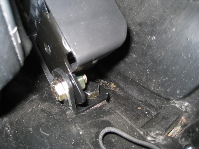

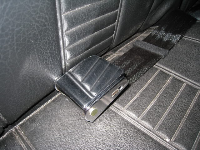

    Lastly, I finally got my front seat belts installed. I was able to use one of the body bolts on each side of the car that go into the frame for the retractable part on the outside. I made a bracket for the two belts on the inside between the seats.

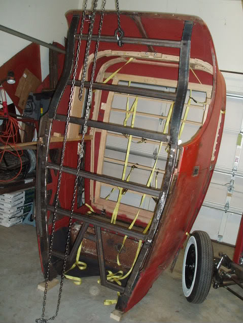

  22. I don't have any plans, but I can share what I did for my floor. First of all my frame is pinched at the cowl about 3/4 inch per side. I made the subrails from 1x2 square tubing right on top of the frame rails. I pie cut the tubing as much as I needed to match the shape of the rails and then drilled holes and bolted the tubing directly to the frame rails. From there I welded up all the pie cuts I could get to. Next I added several cross braces made from the same 1x2 tubing to tie the subrails together. Once the two sides were tied together, I unbolted the subrails from the frame and welded up the bottom of the assembly. After grinding the welds smooth, I bolted the subrail and floor substructure back onto the frame. Then I lowered the body over the frame. I channeled the body 3/4 inches and welded the body to the subrails. Then I unbolted the subrail/body assembly from the frame and stood the body on it's firewall to finish the welding from the bottom. From there, I just cut pieces of 16 gauge sheet metal to fill in the holes between the cross braces. I also figured out where my seats would go and welded in shorter pieces of square tubing perpendicular to the cross braces to bolt the seats to.
