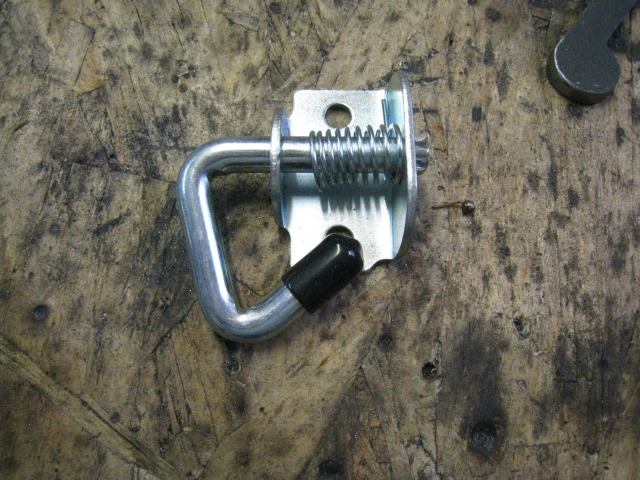

    Then I had to figure out a latch mechanism to hold the backs in an upright position. A trip to Lowe's landed these little devices – spring-loaded hold downs. They would be the foundation for my latches.
    After studying the problem for a while and taking lots of measurements, I made a couple of these little doohickies.

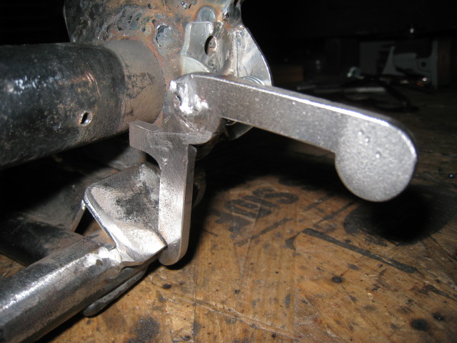

    I cut the hooks off the tie downs and welded them to the seat backs. Then I welded the doohickies to the hold downs. After a bit more studying and some trial and error, I welded a small square of 1/8 s**** to each of the seat bottoms at the appropriate angle and notched the doohickies so they caught the squares.
    Here's how they work.

    Cool- using old factory parts, metal stock and hardware store mechanisms to solve problems.
    Will your front seats be hinged at the front of their bases so the bottoms tilt forward as well? (like stock Model A seats)
