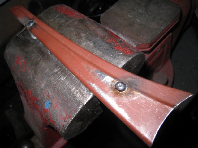

  18. So I've been entertaining myself with little detail projects while I wait for the upholstery shop to do their thing and for my back ordered engine adapter to arrive.
    My plan for the main garnish moldings in the car is gloss black paint. I finished those up a while ago. In Vickys, there's also a second decorative art deco style piece that goes below the main garnish. I plan to chrome plate them. They look like this:
    While thinking about the finishing details for the interior, I came up with the idea of buying another reproduction garnish piece for the dash, to flank the gauge cluster. So I bought one for the quarter window of a fordor slant window sedan and cut it in half to see how it would look:
    I cut the piece a little shorter and cut off the tab that tucks under the window garnish so it would fit flat against the dash. Then I the rounded the side of to fit it flush against the gauge cluster. I welded two screws to the backside to bolt to the dash.
    After a little more metal finishing, they'll be ready for chrome:
    And here's what they look like installed:
