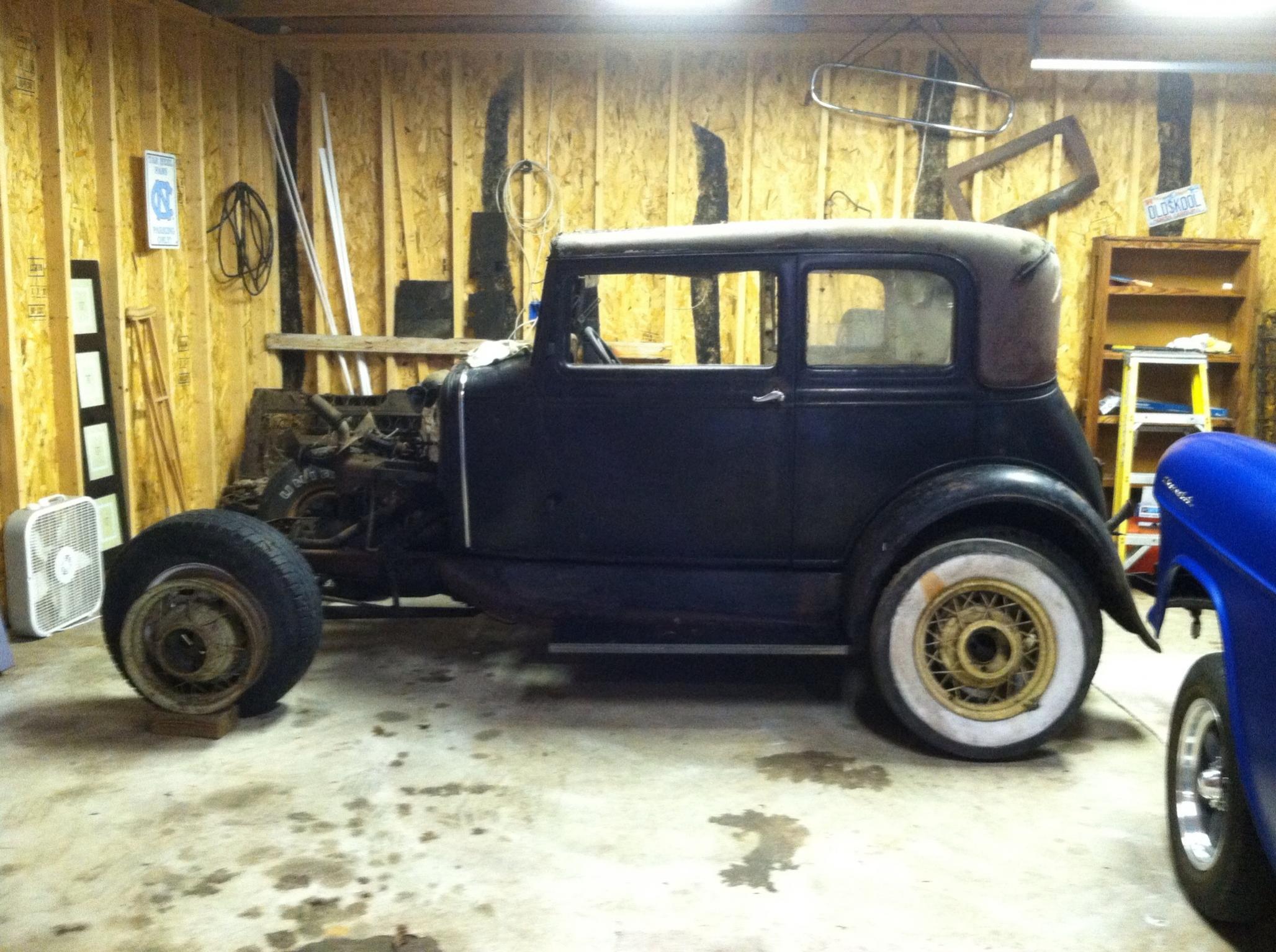

    I do have 2 questions for you. I wanna use my stock frame I am gonna box it. I'm gonna run a sbc Do I have to flip the firewall inside out to make room. Or is that a myth. And I saw where speedway makes a 10 inch rise rear spring. Will that spring bring the ride height down 4 or five inches for me. Or is that for a diff application?

    Regarding an SBC in an A without modifying the firewall I don't believe it can be done. My 327 was set back 3" with a 4" stock (but recessed) firewall, and my short pump pulley was touching my Walker radiator. I ended up moving my radiator forward 7/8" to clear, then used two electric fans.
    Not saying your wrong Dave, I'm just saying I don't see how its at all possible. I'm really hoping to see how to do it for future builds.
