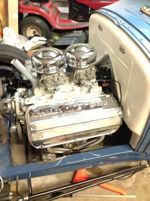

    BTW, the fresh carbs showed up yesterday so I did a quick mock up.

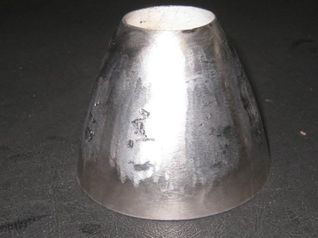

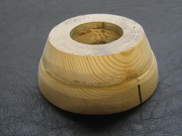

  15. I got my "lampshade" column transition done today. Here are a few pictures of the process.
    I cut it down to the correct size.

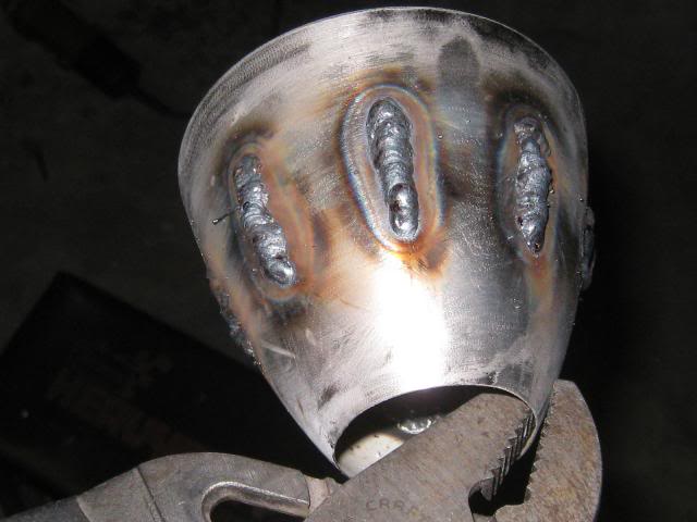

    Welded up all those little slots. Migging the thin material was tough.
    I ground down the welds.
    Then I cut a couple of wood donuts to insert inside the transition to center it on the column and to give me something sturdy to mount my tach onto.
    Then I glued the donuts into the transition with some JB Weld.
    And here's the finished piece.

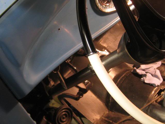

  17. Nice work Dave! Were you able to use the steering shaft? What secures the bell to the column, or is it attached to the wheel?
  18. I want to publicly thank you for donating the steering shaft Mark, I really appreciate it.
    I haven't finished the column mock up yet, but I should know if it's long enough today. It's looking like it will be. The problem I've now run into is the column drop is not long enough, so it puts the steering wheel and column at a awkward upward angle. Now I need to come up with a longer drop. :rolleyes:
    Oh, and to answer your question, the transition isn't secured to the column tube at all – the holes in the wood donuts are snug enough to hold it in place, but I'll probably add a sheet metal screw on the bottom of the small end.

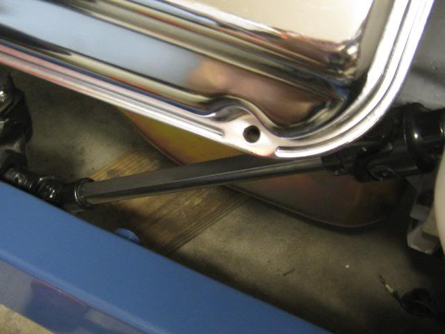

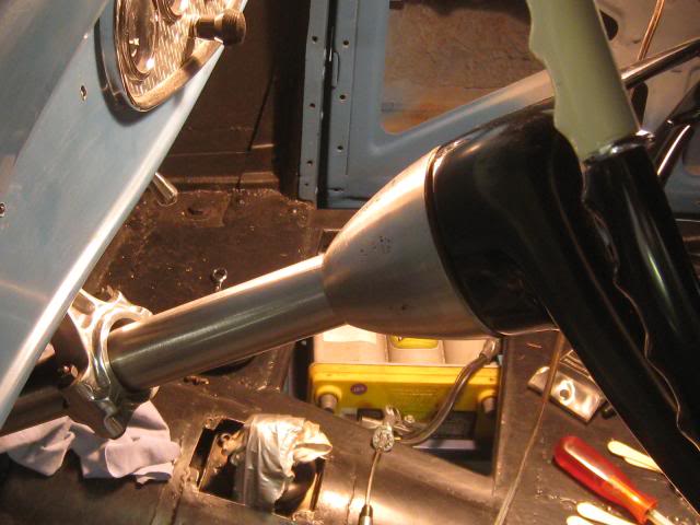

  19. Allrighty, the steering is mocked up. I was able to use the stock Chevy II steering shaft that ALISTER gave me so I didn't have to make the adapter I drew up in a previous post. I was also able to eliminate one of the steering joints and the support bearing I had with the 283. It's now a straight shot from the end of the column to the box. For the floor mount, I got a slightly larger diameter 1-1/2 inch long piece of exhaust tube and welded it to the floor. The steering column slides into it and stays put with a set screw.

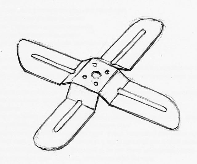

  23. I need to offset my fan back toward the engine. With the radiator in the same position as before, the fan is going to hit the bottom of the radiator. I was thinking of combining two fans to offset the blades so it clears. What so you think?
  24. Dave, make sure you get it balanced before you put it on the engine!
  25. How would I balance it Martin? Maybe it's electric fan time. :(
  26. Would it be possible to take a like amount off each blade?
    Out of balance fans can take out a water pump in short order.
  27. The rotational diameter isn't the problem, it's the forward curving pitch of the blades at the ends that causes the interference with the radiator.
    I've been searching for an aftermarket offset fan, but I really like the looks of the factory four blade.
