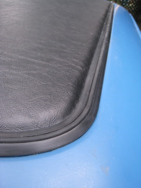

  4. All righty, we left off with some nice new vinyl stapled to the roof over the opening. (See post number 236.) Since then I've been messing with the trim and let me tell you, it was a pain in the arse. The corners were way to tight to bend the aluminum trim without the grove in the middle collapsing. I tried everything I could think of – several different jigs, heat, nothing worked. So I ended up having to pie cut the pieces in the corners.
    Once the pieces were cut and bent, I drilled enough holes to test fit it to the car. Then I gave the pieces to a buddy so he could tig the pie cuts back together. I figured while he was at it, he could weld the four individual pieces together too. So now the trim is one big rectangular piece.
    When I got the trim back, I had lots of grinding and filing to do. Here are a couple of pics:
    Once the trim piece was filed nice and smooth, I drilled holes every two inches in the channel and corresponding holes in the wood around the top opening. Then I sprayed a little Rustoleum semi flat black on the trim. It came out a bit too shiny, but that was easily fixed with a Scotch-Brite pad.
    Once the shine was knocked down, I started screwing the trim on. After that, I just had to insert the rubber into the groove in the trim and finally, it was done.
    I think it came out pretty good.

  5. Looks really good!! I love the contrast of the black insert and the blue body color.
  6. yankbuilt
    Joined: Jan 28, 2008
    Posts: 386
    yankbuilt
    Dave, your the man. Looks great!

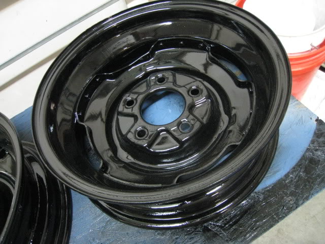

  10. I also found a couple of 16 x 5 truck wheels with the outer nubs that will accept my Merc caps. I shot them with some black acrylic enamel to match the fronts. I've wanted to get taller rear tires for a while, but I finally got around to buying some – 700-16s. They fill out the wheel wells a little better than the 820-15s I had, plus the new wheels are narrower so I think they look better. Here's a couple of pics:

  13. Great job, Dave!
    Really like the new wheels and tires.
