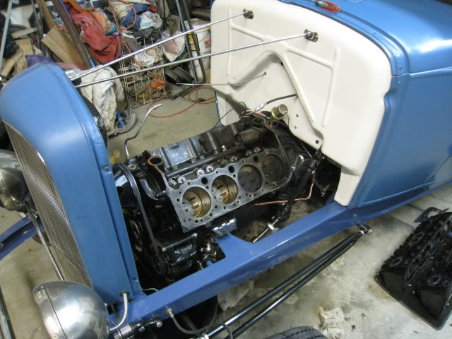

  2. Thanks Martin, I hope the heads will clean up OK. I don't want to have to go completely through them again. I mean they only have 800 miles on them. I do plan to upgrade to screw in studs and roller rockers though.
    It's funny you say that, because with the heads off, the short block looks a little like a flathead (size-wise anyway) sitting in the car.
    I'm not sure what you're hinting at about the trans Dan, but I plan to run the T5 I've got at least until the hemi goes in. Do you want to rebuild it? ;)
    My cousin's wife was definitely into it. She kept saying "I can't believe how fast it is" and I didn't get on it at all. Then she had my cousin shoot pictures of her posing with the car. I think she was already a closet hot rod fan.
    On a side note, I have all my old bicycles hanging in the garage and she almost immediately took notice of a custom I built back in college. She thought it was a fixed gear, but I built the wheel using a BMX freewheel.
    The motor will be very mild. It's a 66 283 with a forged crank, bored .030 with flat top cast pistons. The cam is a Comp Cams 268 grind. 12-242-2

  6. Yes, I said hemi. :D I've got a 331 extended bell and a 354. I plan to use what I can off both and sell the rest.
    Before I started acquiring hemis I had the Chevy short block built because I knew I needed to replace the old one. It's been sitting in my garage for almost a year. That will go in so I can enjoy the car while I slowly collect parts for the hemi. It will likely be a few years, but here's a fun pic for the time being.

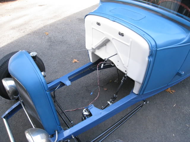

  14. I dropped the heads off at the machine shop last week for screw in studs, and I'm getting roller rockers for Christmas.
    Yesterday I took all the bolt-ons off, disconnected all the wiring, removed the drive shaft and shifter, drained the fluids the best I could and removed the trans cross member.
    And today I pulled the short block and trans out. I thought I was going to have to take the grille shell and radiator off, which would have required undoing my headlight wiring, but luckily, it wasn't necessary.
    Looks like plenty of room for a hemi. :D
