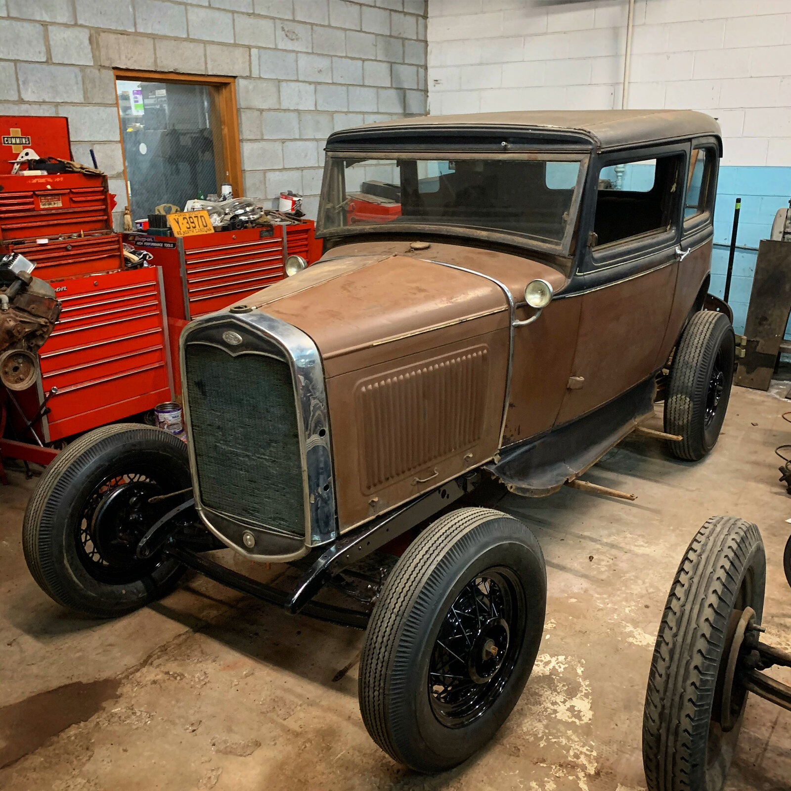

    If it doesn’t rain this might see daylight this weekend! I need to find a nice driver side splash panel for it, the one I have is pretty beat. I’m still undecided on what to do for headlights, to many ideas and I can only use one. 1EF6F97F-1618-4E7A-87E5-DEB6B0D86007.jpeg
    Sandgroper, Baumi, Vic Walter and 5 others like this.

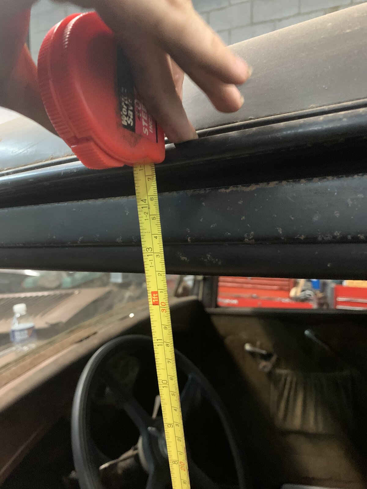

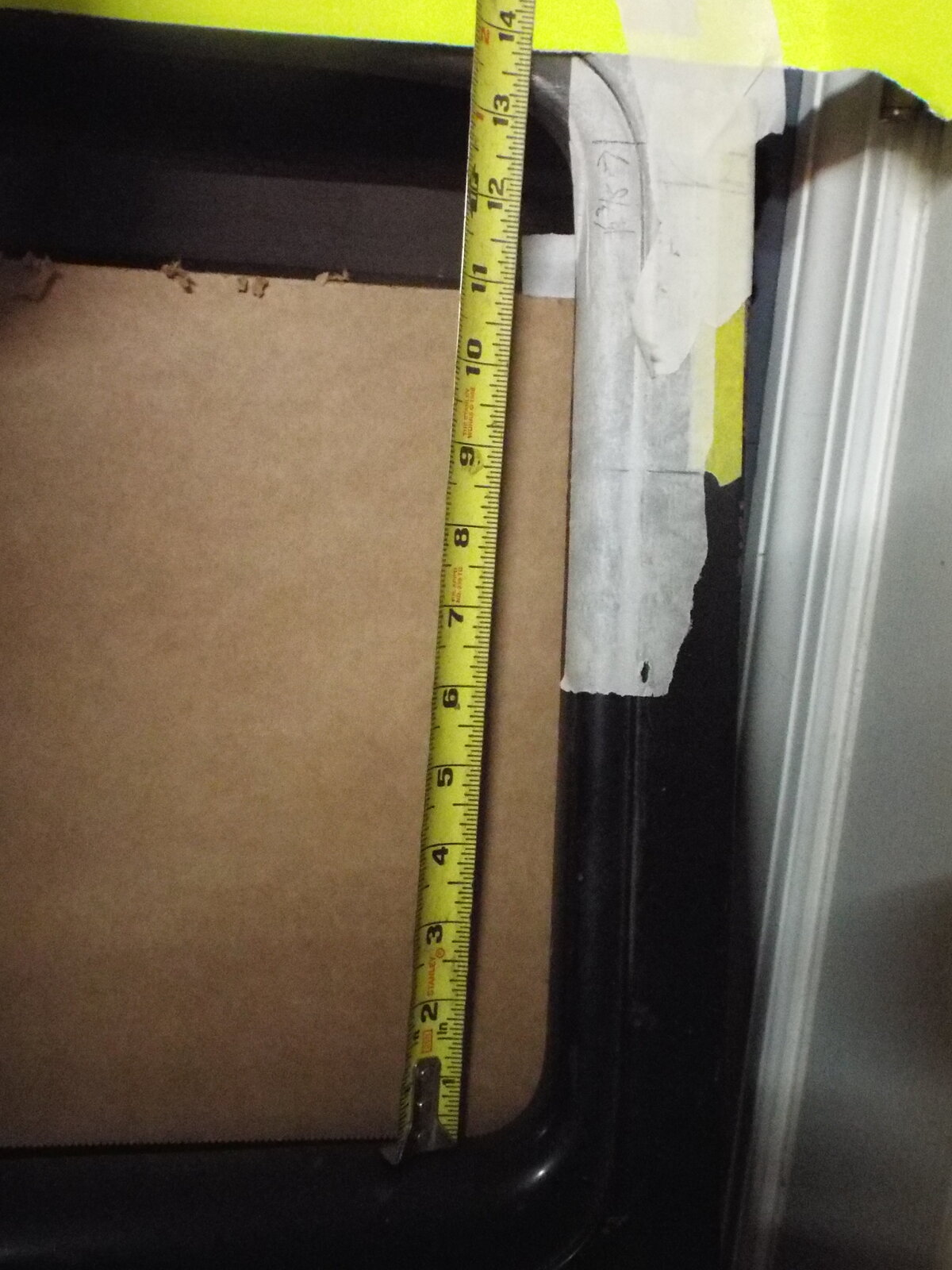

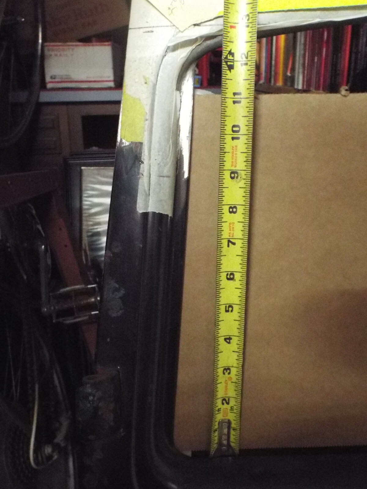

    Looking good! Could you take a tape or ruler and tell me how tall the window opening is in the door? Bob

    Thanks! I’ll measure it today and let you know.

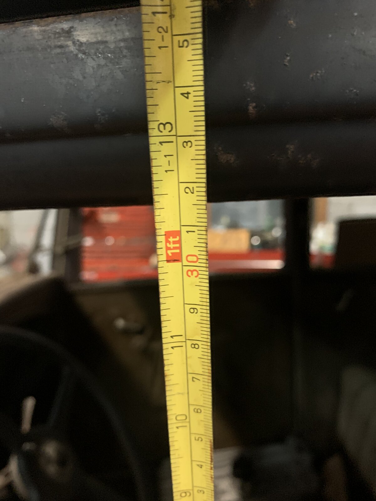

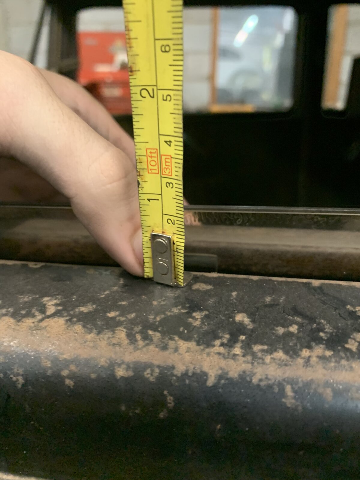

    It looks like about 12.5 inches, if you need any other measurements let me know. 9C2AE1B7-B655-4255-9147-74F426B4BA19.jpeg F1F453E4-978B-4A2A-8A24-36512249CEAE.jpeg 870F2522-4C85-4A7E-8BA6-1722C3F10E92.jpeg

    Thanks! The Fordor door is the same 12 1/2 up front but grows to 13 1/2 in the back. Lots of measuring and double checking before any cuts are made.

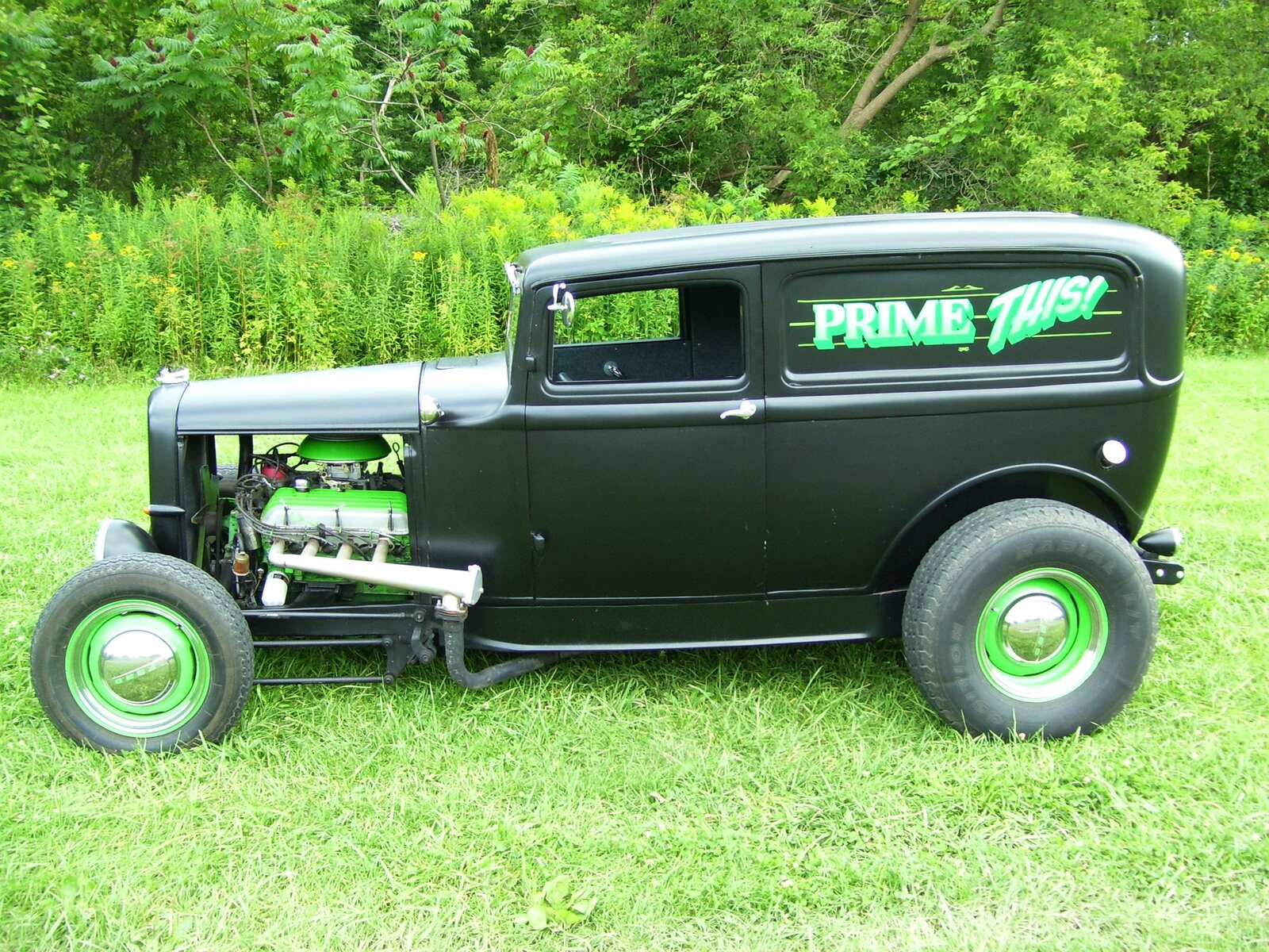

    I built my old Sedan Delivery from a '31 Slantwindow Fordor. The front door window opening is about 7/8" difference front to back. I slightly "angle chopped" it, 3" in the front, to 3-1/2" in the back.

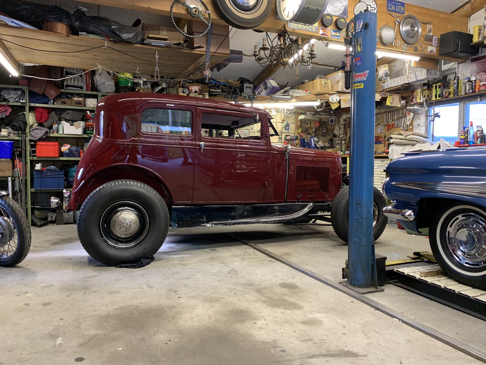

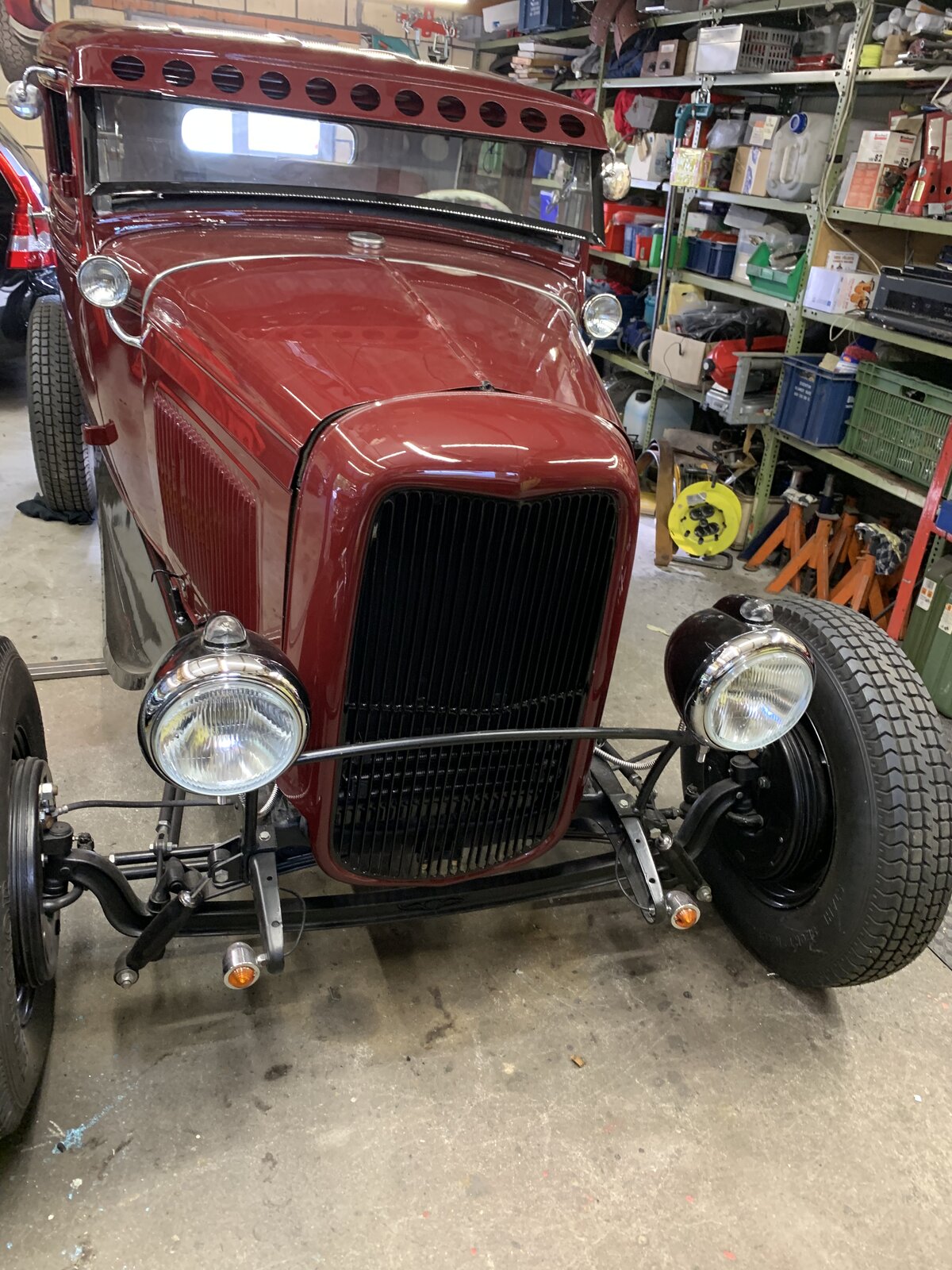

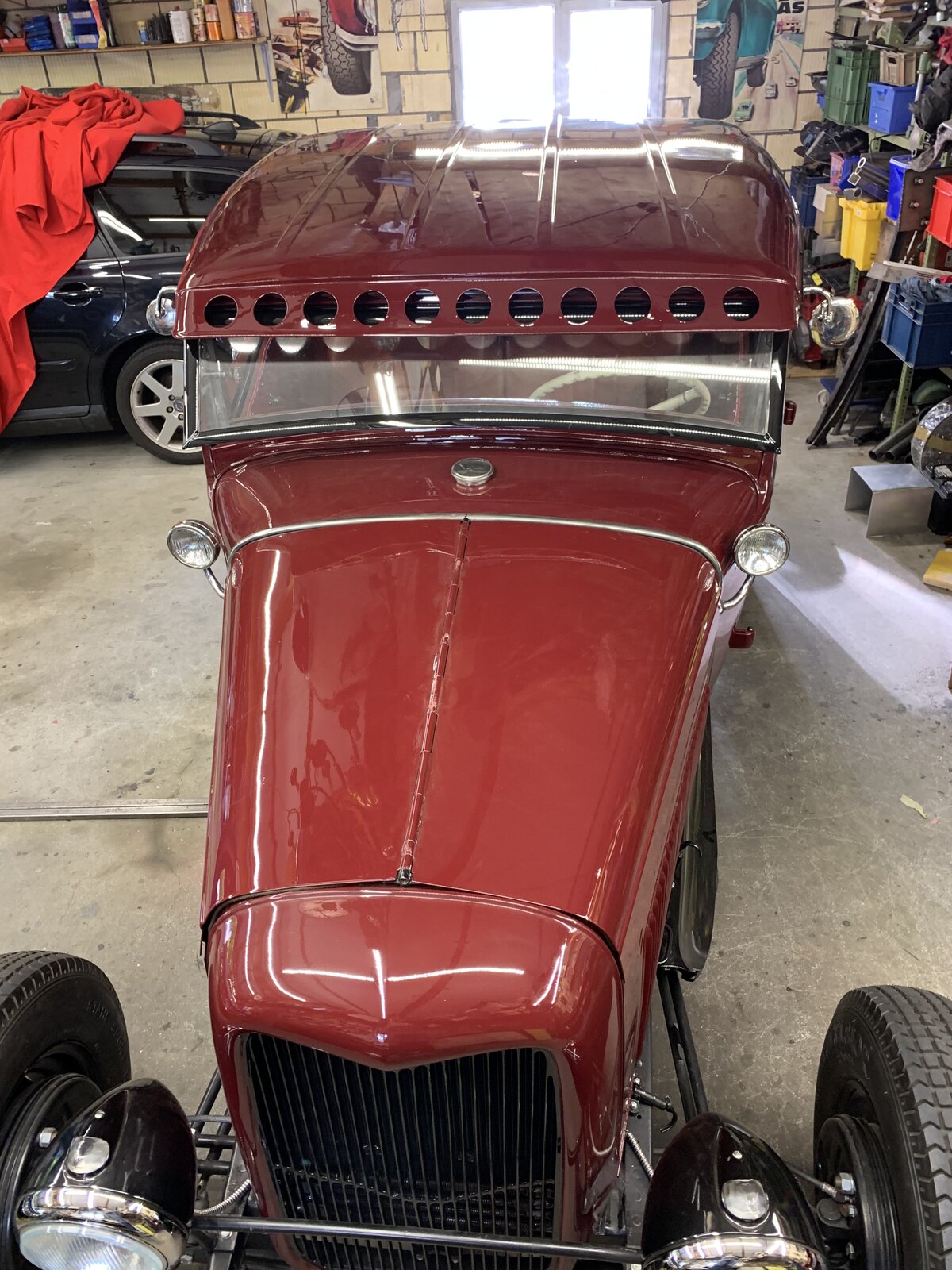

    Vicky‘s are cool, here a picture from mine:

    Nice! Do I see a visor on it? How tall are your windows after the chop?

    The chop is 7 cm or 2.75 inch. The visor i weldet in.
