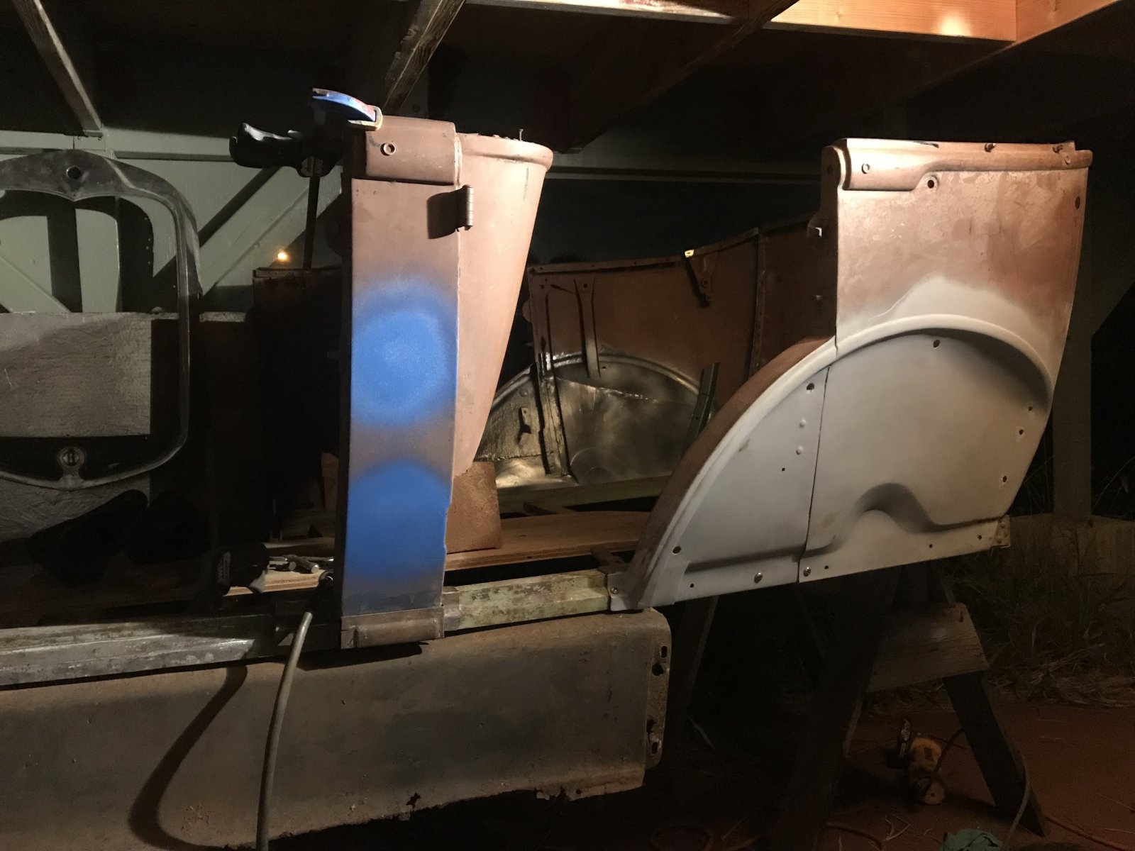

    With all the wood for this car missing in action. It needs much supporting inside.
    This thing is like a soft beer can.
    Got some these heavy wall 1 inch square tube 'X's left over from buddies rotisserie restoration project.
    Set about making some of the needed supports . Cut them apart and bent them in the trucks hitch again.
    Worked pretty good. Fab them with some plate, angle, and strap.
    These three pieces bolt to the sq tube on top of the three rear panels.
    Installed!
    pitman, Shadow Creek and loudbang like this.

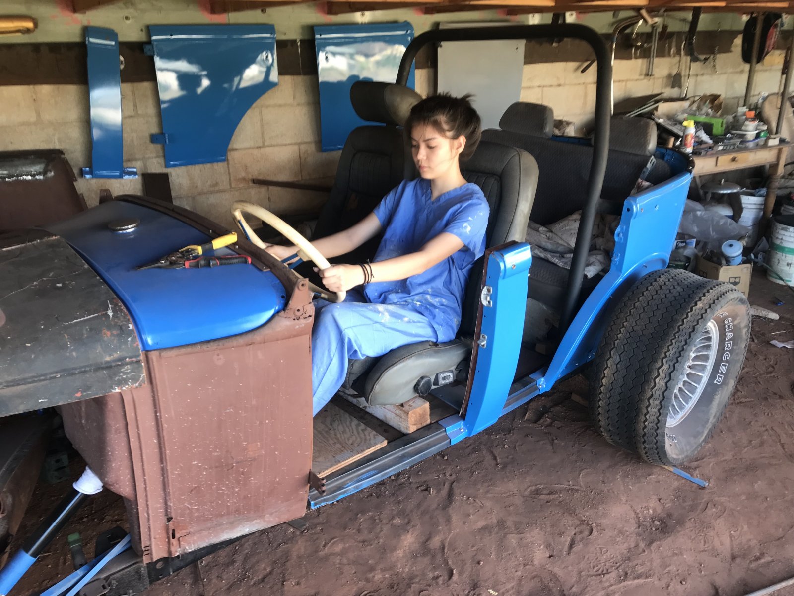

    My plan for bottom is to fit; frame, suspension, seatbelts, batteries, gas tank. amplifiers, speakers, sub woofers, tool box. and mufflers in the 6 cubic feet of space under the bottom seat.
    Well at least dreaming of it.
    I figure this is pretty close to the perfect profile height.
  28. 2Blue2
    Joined: Sep 25, 2021
    Posts: 427
    2Blue2
    Daughter has that look of "This could really happen and I could drive this" (just got learners permit)
    Has her paint clothes on as she just painted the third door.
    Didn't turn out so great.
    Was just getting the hang of chasing the wet edge across the panel when we ran out of paint.
    Best way to learn to paint is to just do it. Door and dash rail she painted is in pic above.^
    Not so shiny but loving her help.

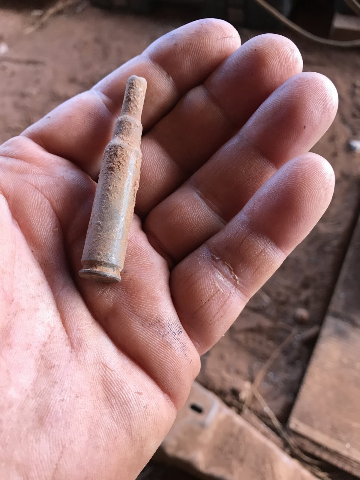

    Found some spent br*** wedged in a door.
  29. loudbang
    Posts: 40,351
    That br*** looks like it was a blank.
    LWEL9226 and kidcampbell71 like this.
  30. 2Blue2
    Posts: 427
    2Blue2
    I thought the double neck down was weird. No caliber marks on end.
