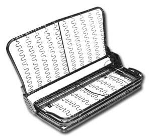

    Front seating for my ‘31
    I still haven’t reached front seat nirvana.
    Feeling like it should be a bench seat but not sure why,
    Probably because I looked at the glide engineering seat frame on line.
    Makes other options show there short comings.
    ‘65M-stang front bucket seats are ok and fit pretty good.(each about 22 inches wide)
    ‘65M-stang back seat better width on top part (42 inches) but really square corners ****.
    Bottom just too wide(52 inches).
    Both pieces haven’t real frames to hold it together for mounting on adjusters.
    Chrysler mini van seat (40 inches with out arm rests) fits good but already set to fit back seat and is a bit narrow.
    I have to sit on the left edge and it is already sagging, I’m big so wish it was 46 wide.
    You’d think something in this pile of seats would be satisfactory.
    Still looking for different options (meaning something free).

  3. drdave
    Joined: Jan 3, 2006
    Posts: 5,366
    drdave
    What about taking the covers off the Mustang rear seat and rounding the frame corners on the top and cutting the ends down to fit on the bottom? Wouldn’t take much and you could put the same covers back on and just pull them tighter around the corners. They wouldn’t fit perfect, but they’d do for now.

  4. 2Blue2
    Joined: Sep 25, 2021
    Posts: 427
    2Blue2
    I like this idea. Thank you.
    Anything ‘Chopped” for a HotRod is cool right?
    I think the actual path to a functioning seat is more convoluted.
    1. I Would have to weld a real frame around it, its structure came from package shelf/ trunk par***ion.
    2. Tilt forward would be nice for some map pockets behind but not necessary.
    3. If you make the top then you have to make the bottom.
    4. I want it adjustable so others can drive it too.
    5. Don’t want to pay a lot for my muffler. (was a great commercial)
    Still dreaming of the Glide engineering frame but its kind of costly.
    A search of the HAMB about Glide E. and some people have complaints and some love it
    It doesn’t look anything like my junky back mustang seat.
    drdave you got me thinking. For the price of welding wire and spray paint...
    hmm...how many seat parts would I have to weld together to be successful.
    Isn’t there lots of spring steel that can’t be welded?
    Maybe thats a non issue and just the frame would need it?
    drdave likes this.
  5. drdave
    Joined: Jan 3, 2006
    Posts: 5,366
    drdave
    I sectioned the bottom of the 64 Tbird seat I put in my '64 Pontiac in the 80's with a rented stick welder....and very little skill. ;) You clearly have more skill than I did back then, so I think you can do it with not too much problem. I don't think you'd get into the springs really. If I remember right, the springs are just clamped to the outer frame, so if the outer springs are in the way, you could probably loosen the clamps, slide the end of the spring over an inch or whatever and squeeze the clamp back down. The outer frame should be no trouble to trim and reweld, or even cut out and replace with 1/4 inch round rod to whatever shape you want.
    Now, for the hinges, if you don't feel too bad about cutting up another set of seats, how about cutting the hinges out of the bucket seats and welding them to the corners of the back seat frame while you have it apart. On the same 64 Pontiac, I wanted the front buckets (64 Tbird again) to not only hinge, but to recline. Had a set of reclining buckets out of my mom's 74 Maverick, so I cut the hinges out and welded them into the Tbird buckets...worked (and still does) great. Here's the before and after of mine (pardon the quality 110 instamatic film quality LOL).
    For the back panel, how about making a panel that's fixed and the seat cushion just flips forward and you have a cubby back there for whatever you want. Adjustable seat tracks is the easy part....just mount your new bench to the tracks from one of the bucket seats. See, easy, nothing to it. You should have it done in 15 or 20 minutes. ;)
