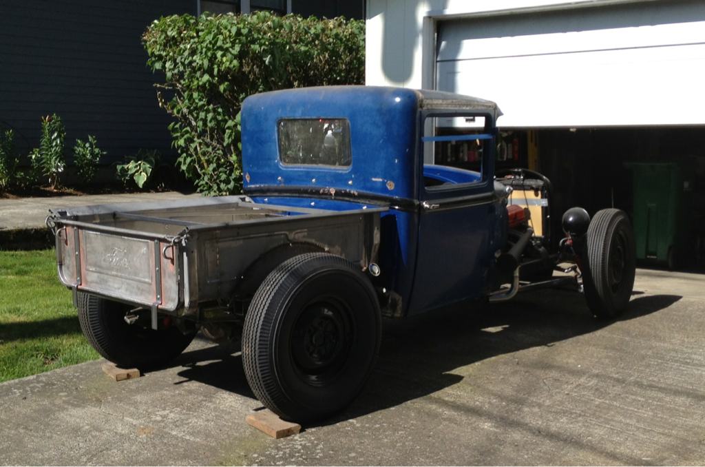

    Got a little done lately. Spring is hung and I got the steel for my kick. I'm gonna start that this weekend. I also think I decided not to channel it! We'll see when the ch***is is done and I mock it all up again on the ground

    Haven't had an update in a little bit and I haven't gotten a lot done either haha I got my spring mounted and I put my cab on today. I'm trying to figure out where to get axles from now. Once I get them I can see if I'm going to step the rear a little or not.
    Going unchanneled and 5in or so chop

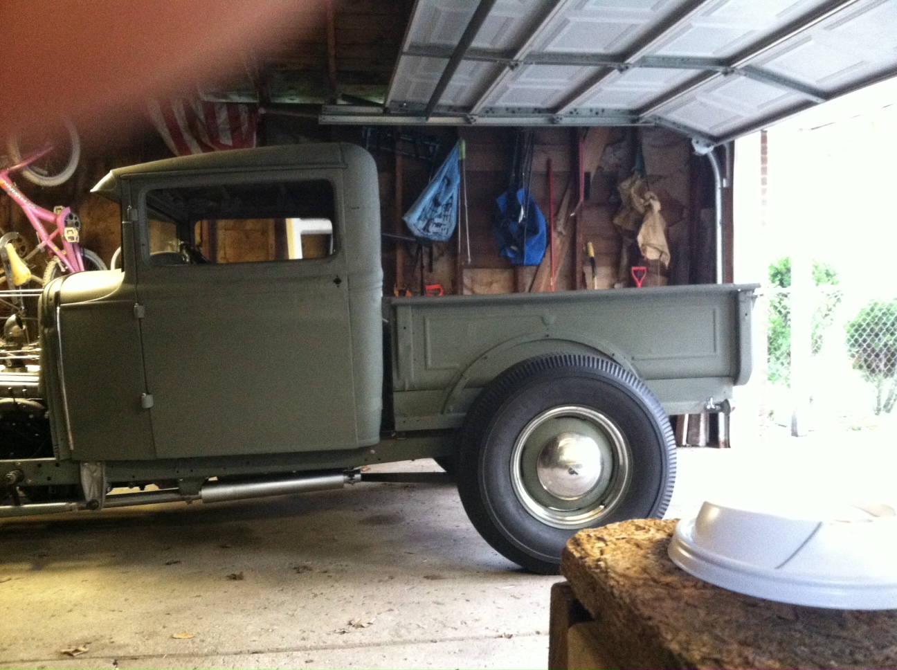

    I got my axles in so I set it up without the kick first and it had a little too much rake.
    I didn't really like the way it looked so I kicked the rear 3" like they did in the tardel book.
    This is what I ended up with. I think it looks pretty good. I might get a different spring for the front to bring it up some.

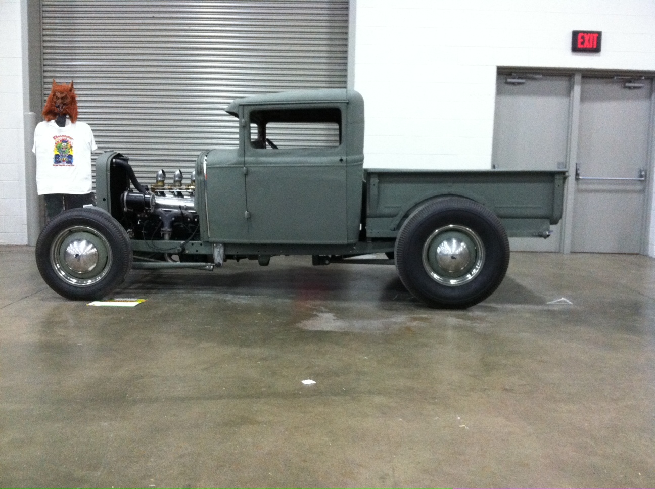

    Looks cool, what size are the front tires? I think I like them better than mine. I ***ume the rears are 7.50x16? Same here. My kick up is 6".

    + 1' up in the front. the rear wheels look good in the fender support as it is now, I wouldnt mess with that. With 750's in back and 500/525's in front, on level ground in the shop, a digital level reads 3 degrees when set on the frame rail next to the engine.
    heres a pic before I raised the rear of mine:
    And after
    You can see it's almost exactly where yours is.

    Yep the rears are 7.50x16 and the fronts are 4.50x16. Probably should have went with 5.25's up front but I can always later. Hows your truck coming along man?
    That's an awesome looking truck man!
    Yeah I'm thinking add an inch up front and it'll look good!
    Thanks for that comparison man! The top looks pretty level and the bottom looks spot on to me. I think if I add an inch up front like you said I'll be golden. Plus with the weight of the gas tank and battery the back will come down some. I'm actually going to throw an angle finder on mine tomorrow now that you said that!
