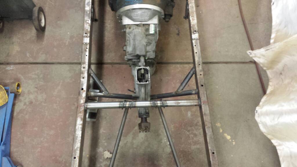

    Got my very simple trans crossmember made up and tacked in. I also made legs that tie into the frame that I have yet to weld in. Ch***is is almost done, so I guess I'll be starting on the body soon!
    Let me know what you guys think!

    Looks pissed! Stance is going to be killer!

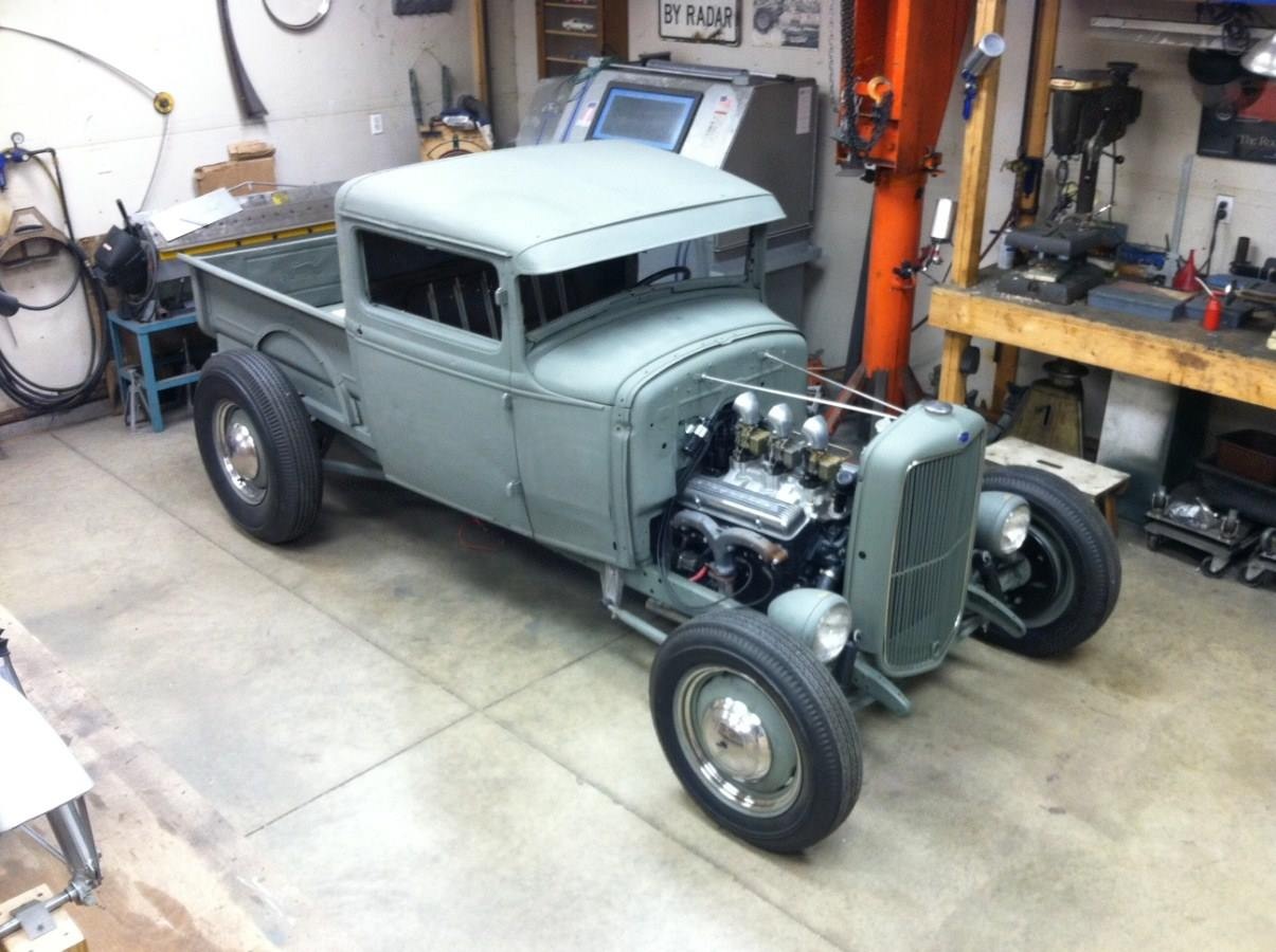

  5. kidcampbell71
    Joined: Sep 17, 2012
    Posts: 4,756
    kidcampbell71
    Love all the advice you're getting, and the work you have gotten into so far. Great place to be....this place....you're a smart kid to play thru the course....with them caddying. Won't go wrong at all.....
    Awesome truck you have. Dig your dad's car, and his drive up ramp too. Have fun sir. I am looking forward to more of your stuff......so get it get it !

  7. 31pickemup
    Joined: Apr 9, 2006
    Posts: 1,304
    31pickemup
  8. fastmike
    Joined: Aug 6, 2013
    Posts: 290
    fastmike
    from Mesa AZ
    Hell yeah man! Honestly you have the coolest A pickup on the HAMB! It's actually the reason I decided not to channel mine.

  10. 31pickemup
    Joined: Apr 9, 2006
    Posts: 1,304
    31pickemup
    I don't know about all that but Thanks! You'll be much happier with a truck not channeled. I'm 5.7" and it's feat to get in and out and thats with a 15" steering wheel. I finally somewhat finished the inside this summer. just a few more things to do. unnamed (7).jpg unnamed (6).jpg

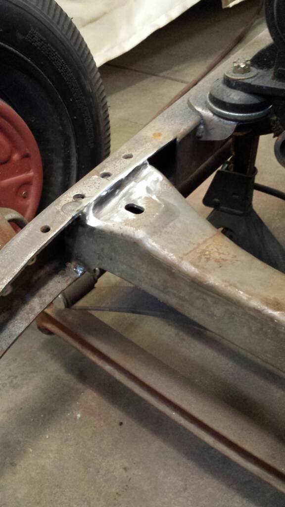

    Got a lot of my frame welded up the past couple of days. Just gotta yank the engine and trans to fully weld it up! What do you guys suggest for a pedal setup? I think I wanna use frame mount pedals but I'm not exactly sure which I could make work.
