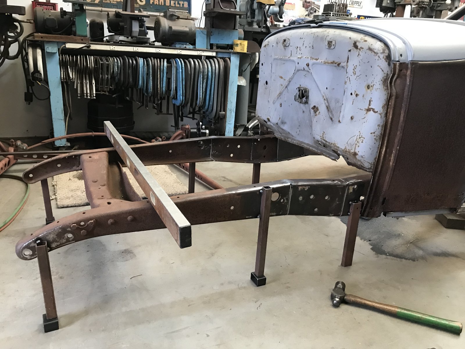

    To mount the body I welded some 2” flat bar tabs to the bottom of the frame sticking out a few inches. The 1” tubing along the sides/ bottom of the body landed on the tabs, it was drilled and bolted. With the body mounted and the hood in place There was a 1 1/4” gap between the frame and the hood. I kicked up the front of the frame 1 1/4”. Lucky I enjoy doing this stuff because the endless hours cannot really be justified. Weekend after weekend after weekend of spare time!

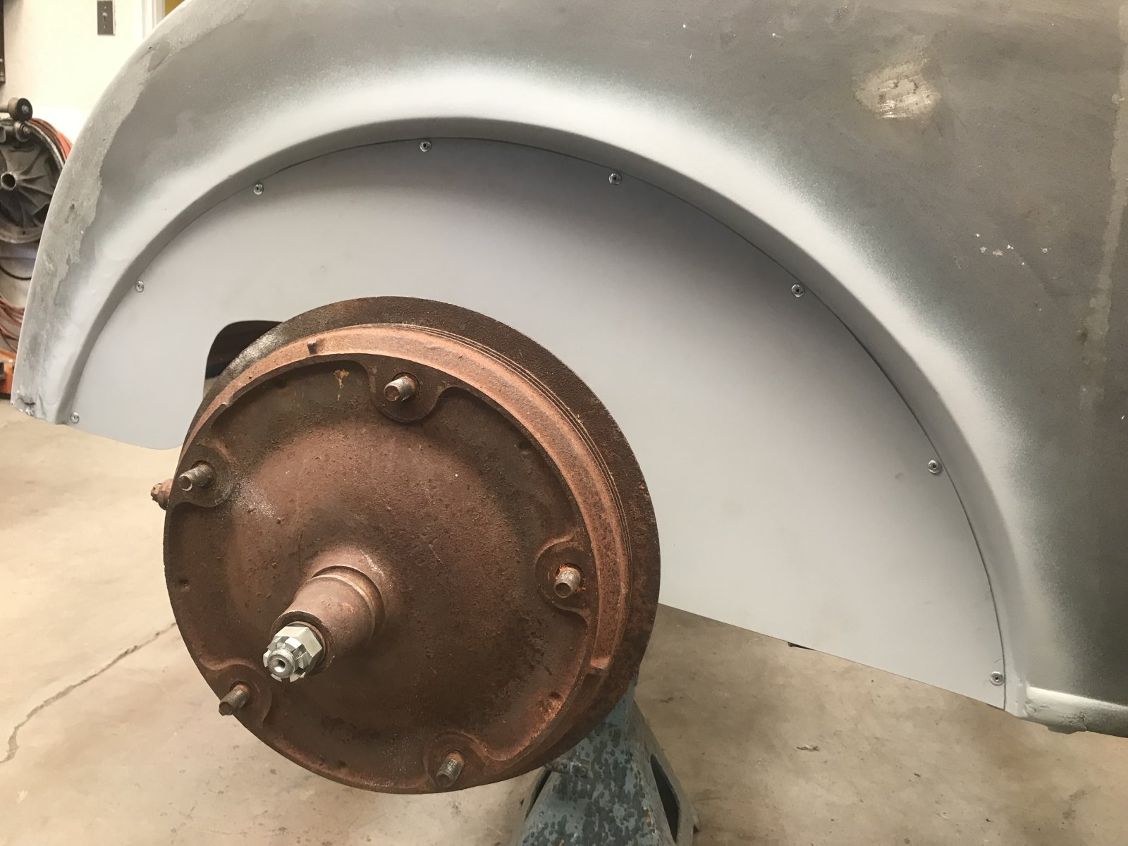

  3. My good friend Tony McDonald hooked me up with a 39 Ford rear end ***embly. I added a kick up and simple crossmember to the back of the frame. I used some ladder bars I had (swap meet) to locate the rearend. If new owner uses the banjo rearend it will need an open conversion. I didn’t fully weld the brackets to the housing and I have more spring mounts so any rearend could be installed. I made some simple inner fender panels and riveted them in place. I made a grill block off panel, mini windshield, trunk hinges and installed a simple latch. Car was now a roller to push outside, stand back and see what the hell I’ve got.

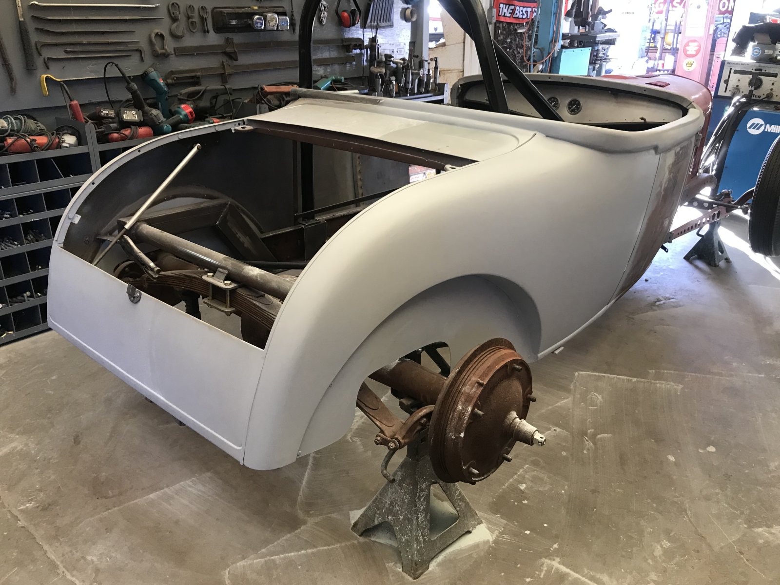

  11. After a lot of welding holes and cracks, a few patch panels, beating on dents, heat shrinking some high spots etc it was time for the real body work to begin. I called in the help of another friend from work, Tony. There was filler dust flying for a few weekends.

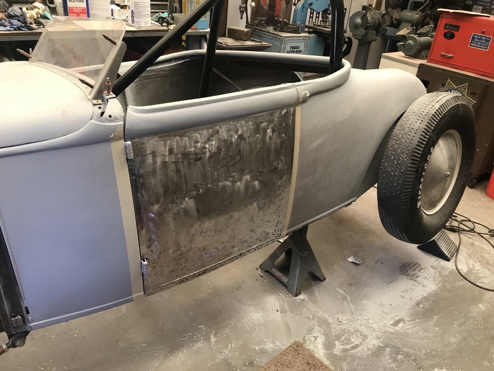

  13. One part I paid full price for was a door skin for the driver door. I made a 1” square tubing frame on the inside. I used a generic latch/handle I had from who knows where. I was worried there would be flex in the door and jamb but everything is rock solid. You can grab the door and shake the whole car, slam it or just push it, click!

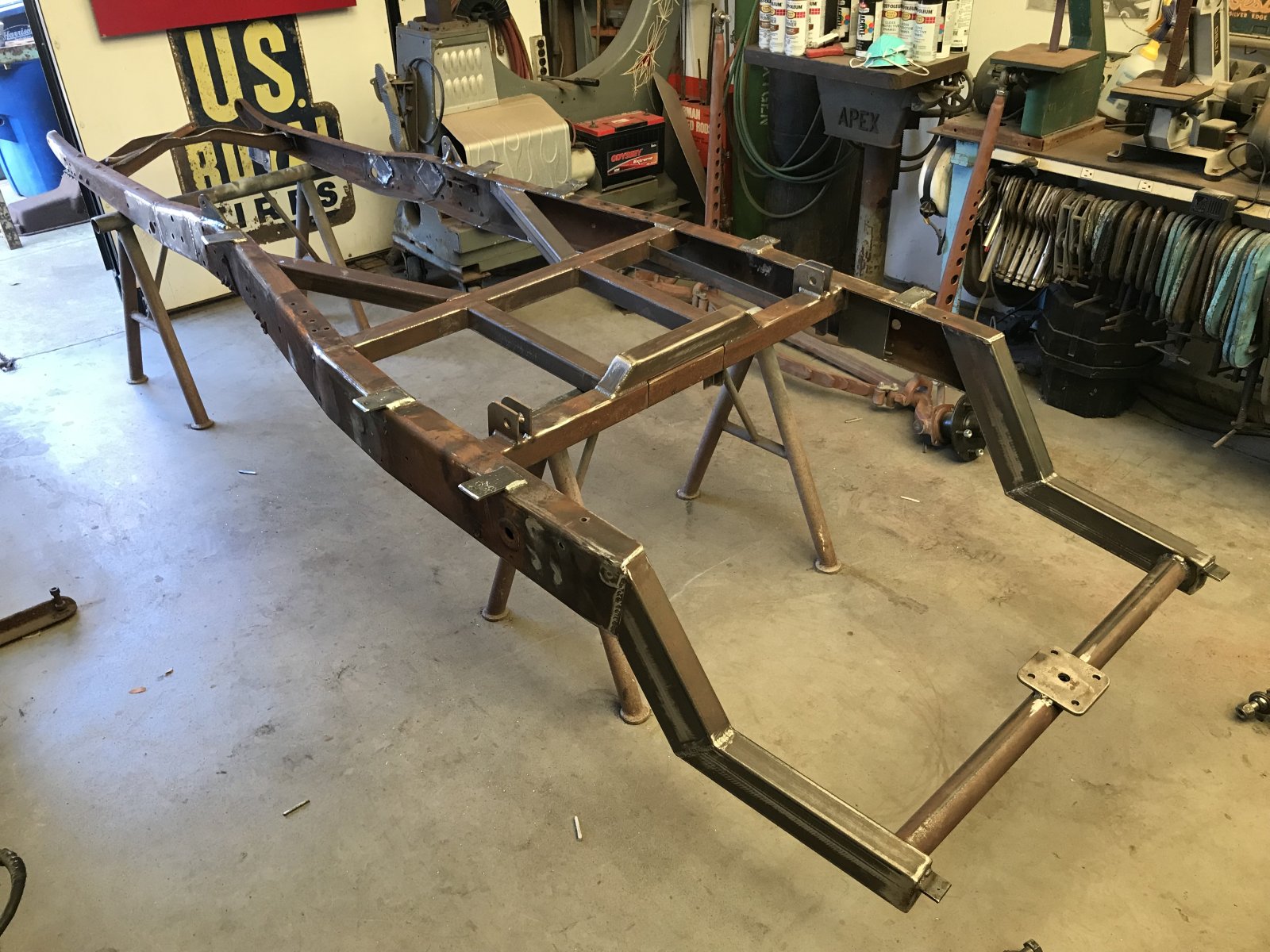

  16. Next the body came off and I finished up the radius rod brackets, body mount tabs etc and fully welded the frame. There was a lot of sanding and wire wheeling before the black paint went on.
