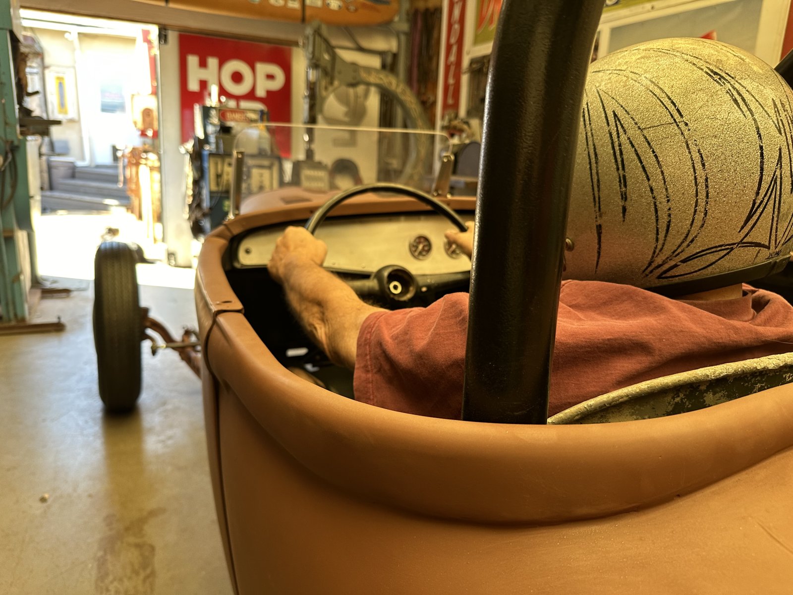

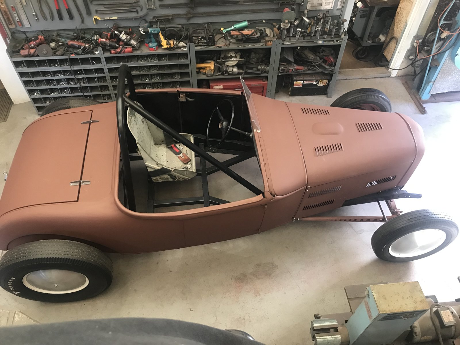

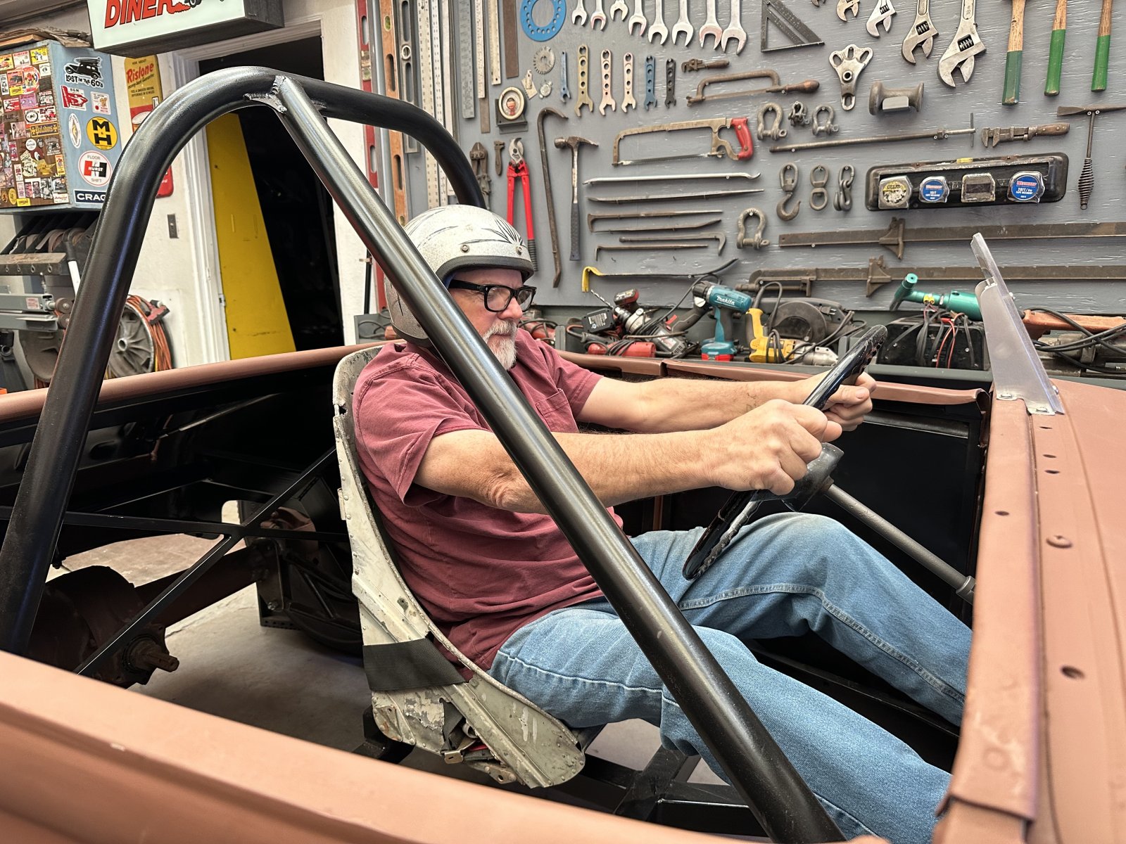

  3. Some pics to show the driver position. I am 5’8” and with no seat cushion I am a little too low in the car. Should be a great fit for any size driver depending on pedal placement, cushion thickness etc.

    Smart move…center/trans crossmember is mounted near the bottom of the frame rails…seat is mounted below top of frame rails…perfect!
    Rustoleum Rusty Metal primer is a great color…don’t like the bright orangish primer…too much in your face.

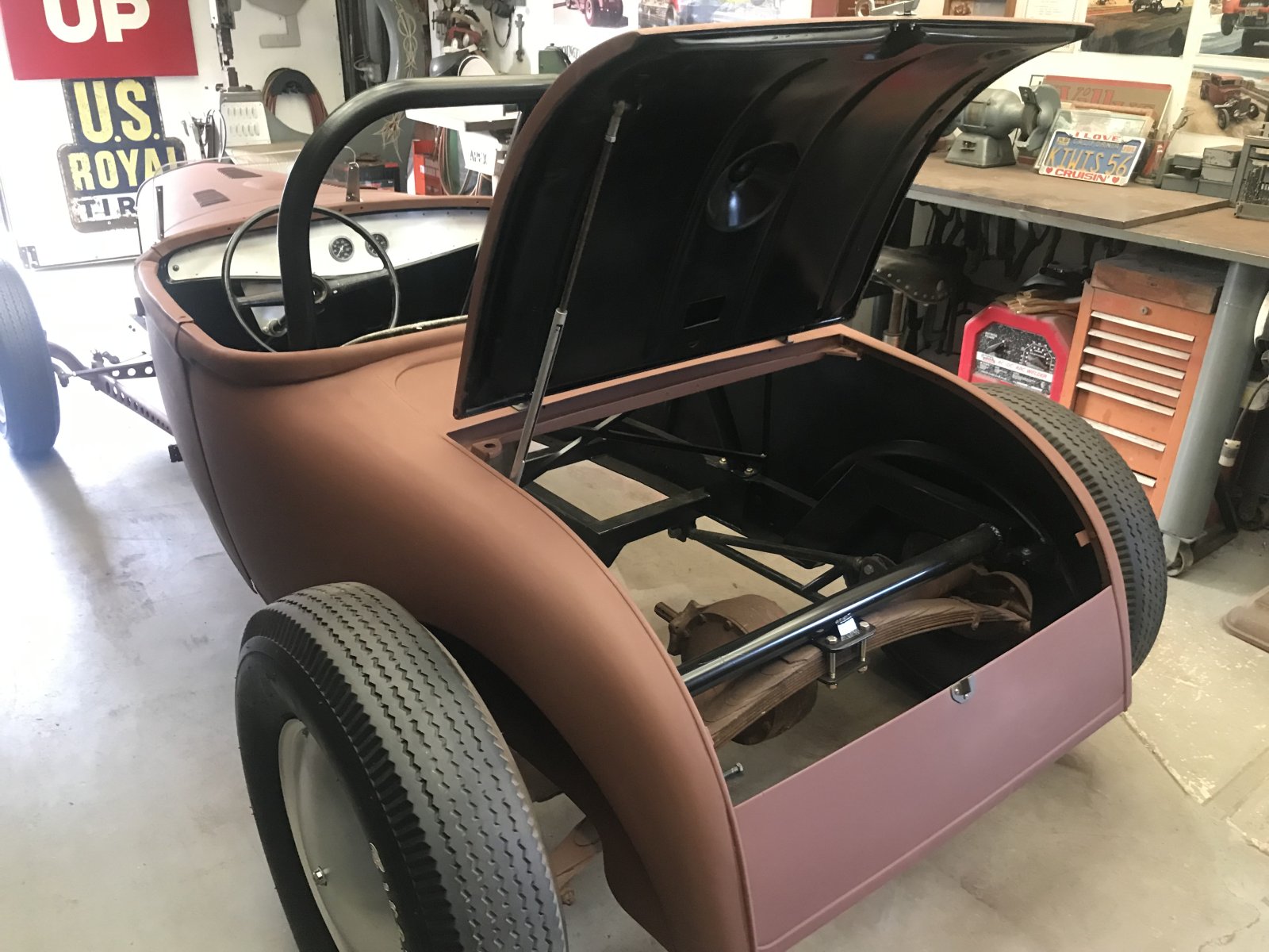

  9. This pic shows the trunk prop, given to me by a friend years ago. Helped a lot to have it in place while working on the car.
  10. Trunk hinges were cut from 1”x1/8” angle iron.

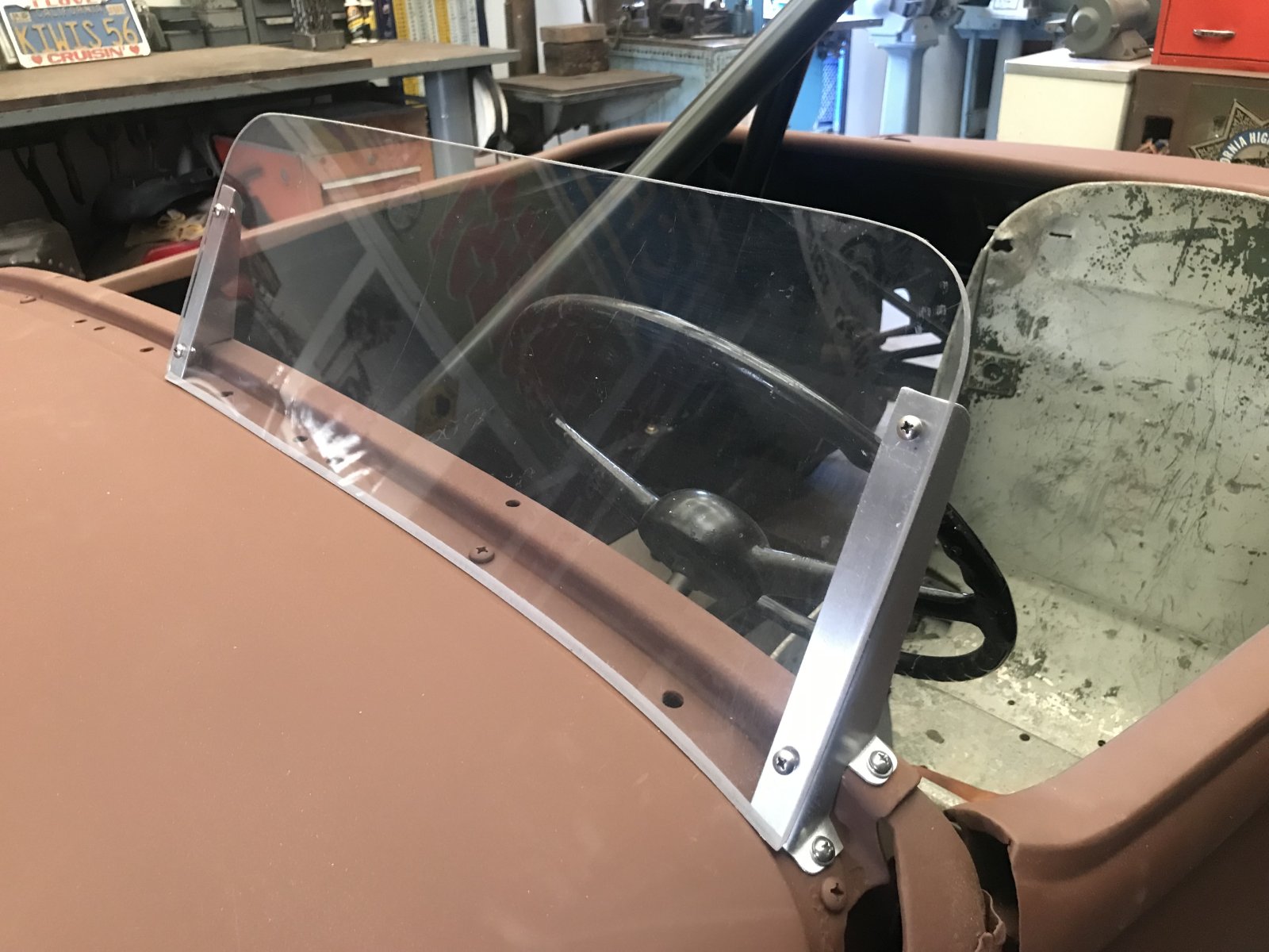

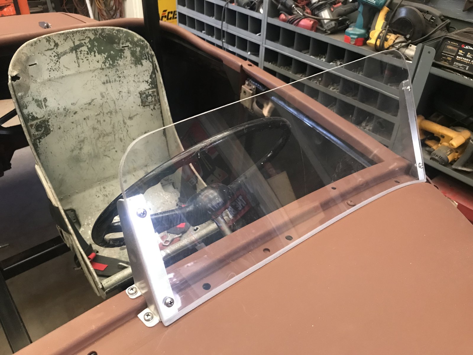

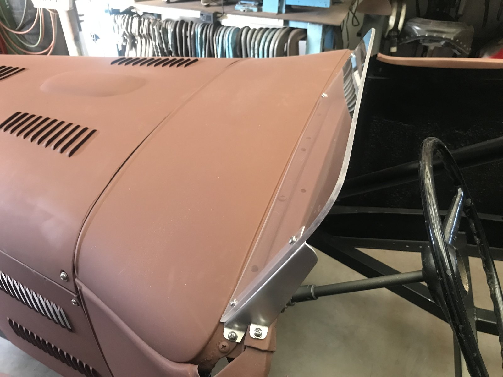

  20. Here are a few pics of the windshield. Made from .0650 5052 aluminum cut and bent to shape and 3/16” Lexan. It is surprisingly sturdy.

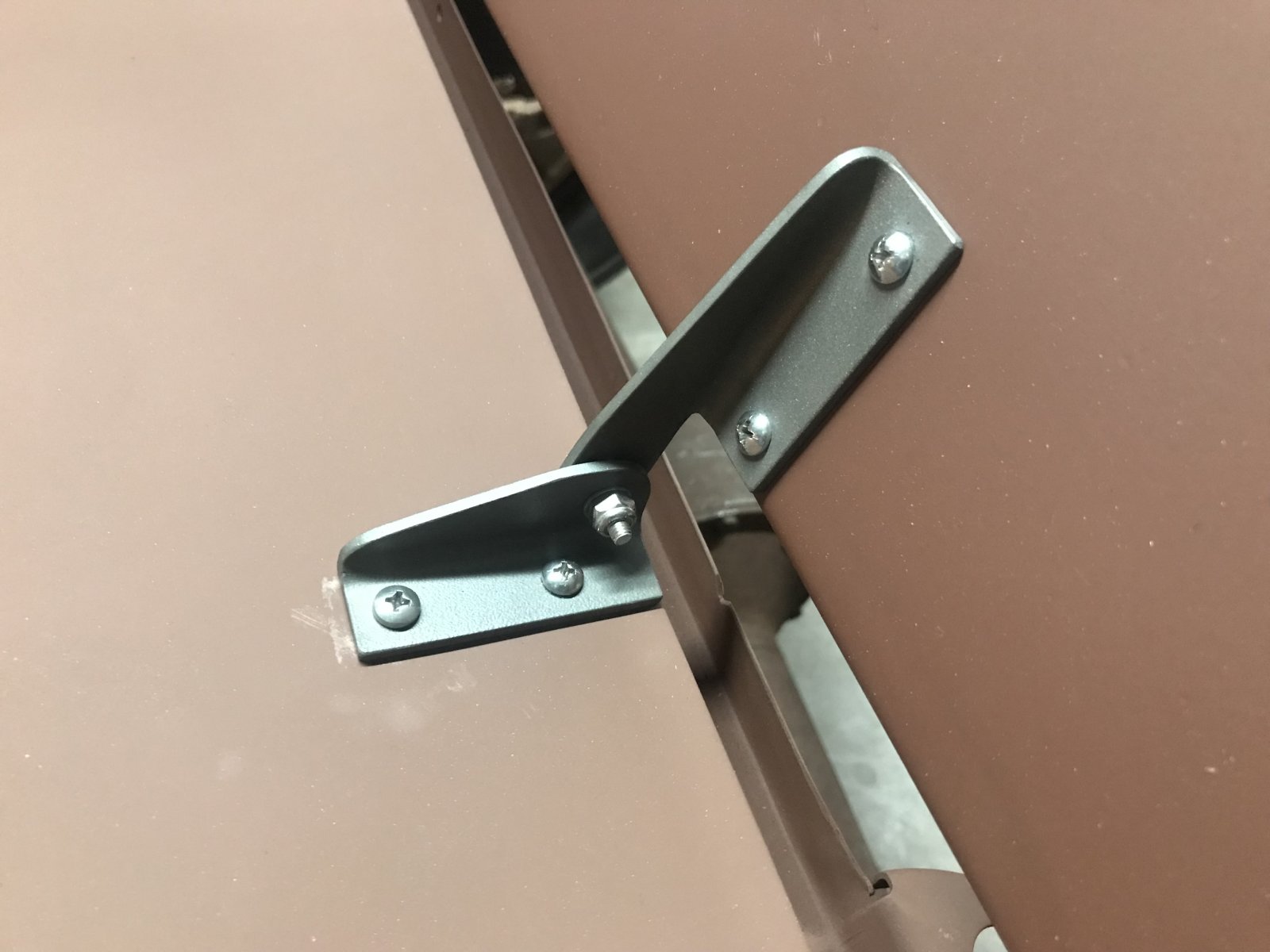

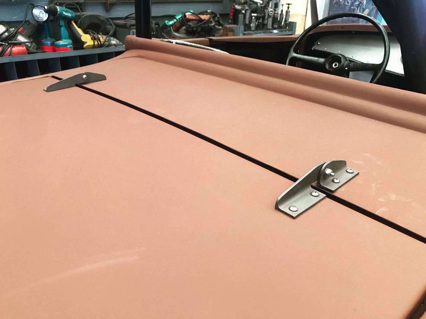

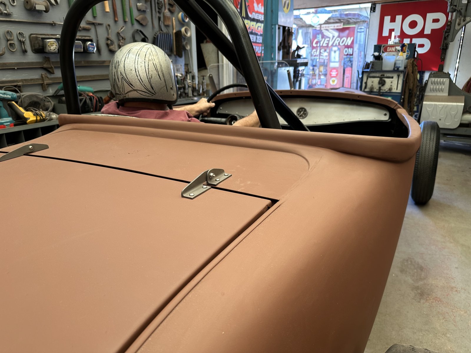

    Here are a couple more pictures of the hood that started it all. It is held on by 1/4. 20 machine screw but the top needs a hinge on one side and 2 lunch box latches on the other for quick access. Have a hinge and I’m sure the latches are available at Lowes or Home Depot.
