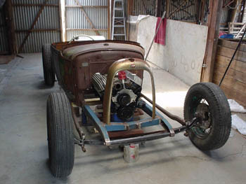

    heres how the pick up looks now,doesnt seem like a lot of change, but theres a lot of decisions made, about proportions,cab length etc.
    the motor is a '67 289W,pretty much stock,will build a three carb manifold out of the stock 2barrel alloy one.Bones will be shorter and attach just in front of cowl.next job is engine mounts and trans crossmember/pedal mount, then fab up the rear end (4 bar with A spring)

    heres how I lengthened the rear panel,with a section of a fordoor back door,had to angle the piece to get the reveals to line up,they turned out pretty close.also tapered the inserted piece to angle the rear panel back a few degrees to allow more room for the seat back.waiting to seew if i get a henrob for xmas before i weld em up fully [​IMG]

    Looks great so far. What kinda speed will those front spindle mounts be capable of? [​IMG]

    Can we see photos of the engine mounts? I will be using a 351W or 289 in mine as well!

    the rear view, gonna run these tyres,aussie made light truck 7.00x16
    will have 5.25x16 firestones up front.what do you reckon?i think they look a little bit dirt tracky..and they were free with the rims!

    Im doing the engine mounts next,will post shots when theyre done.

    Running the perch bolts upside down, presto! instant lower shock mount.
    spring mounts to another set of perch bolts running horizontal thru bones just behind axle(oh yeh gotta do that bit too.... [​IMG]
    grille shell needs to come down more,maybe an inch and a half.
  10. Hey, one shot the grill shell looks too tall and then the next it looks OK. What gives?
    Nice progress though....
    The narrowness of the Windsor will be kinda handy. Will make it easy to set up the exhaust, for sure, without looking so cramped.

    What kind of axle and bones are you running?

    46. I dig the wide track look, reminds me of old aussie hillclimb specials like my dad used to race.
    Drilled 13 holes in the axle.
    for luck. [​IMG]
