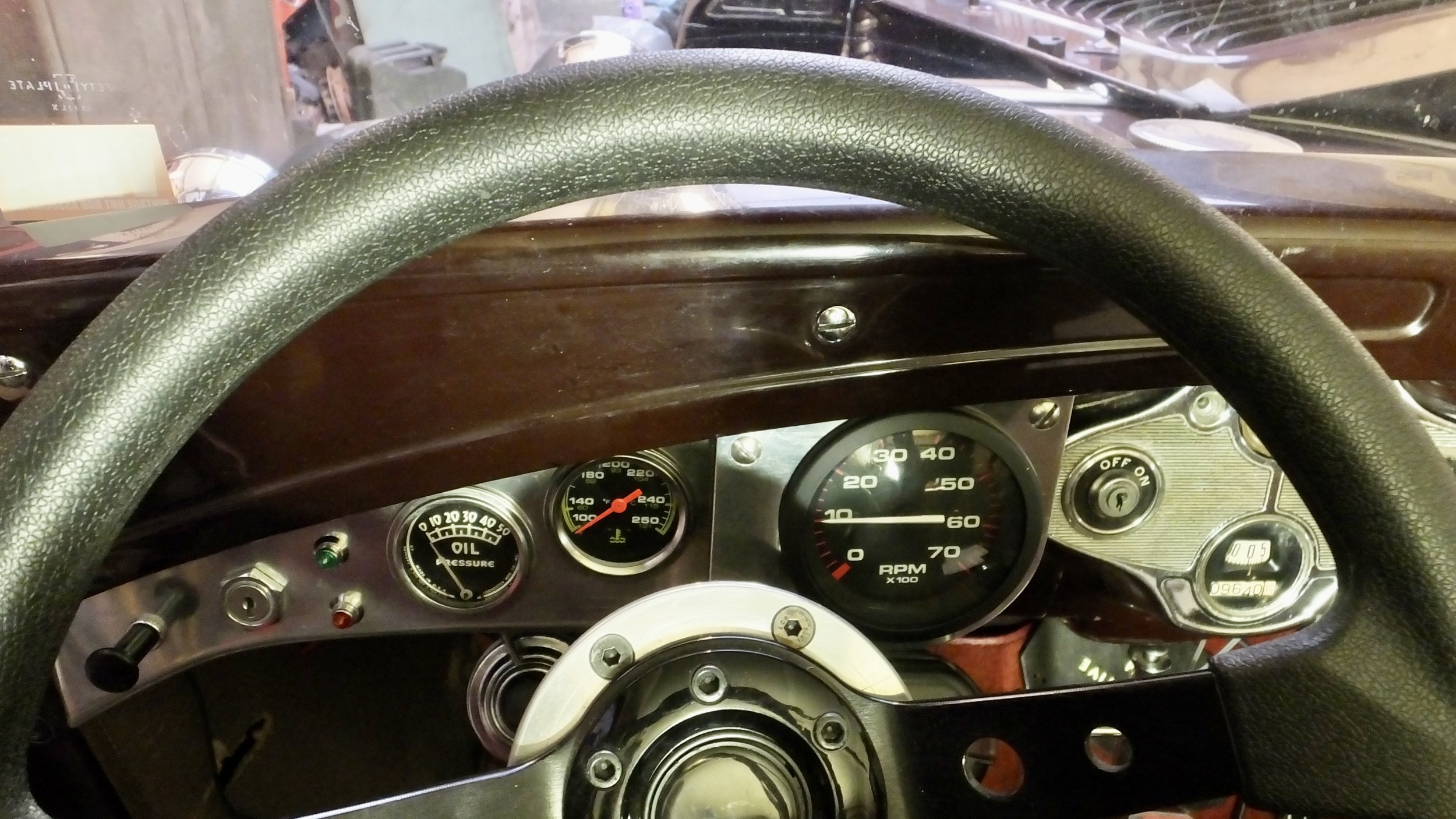

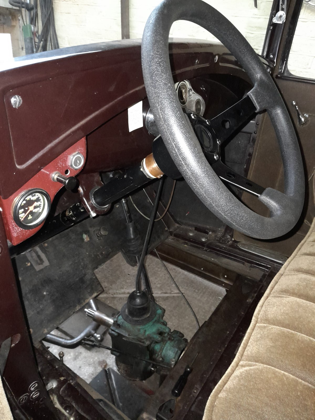

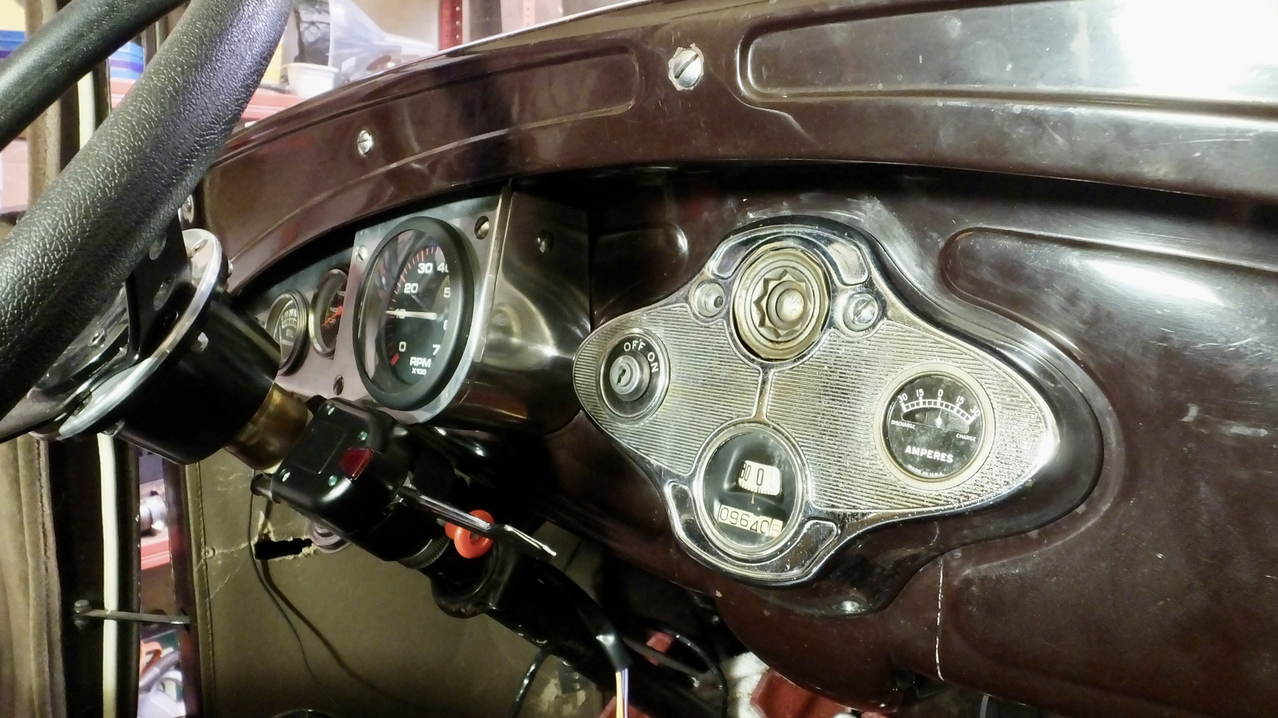

    Meanwhile to stop me going crazy I thought a rev counter and a couple of gauges would do the trick, I quite like the way it's turned out.
    From this,
    To this,
    Then after a proper look at the state of the wiring on this car I had no option but to rip it all out, so that'll be next.
