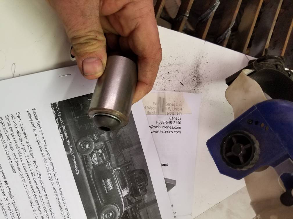

    Wishbones mounted using the through the frame tie rod mounts from welderseries. [​IMG][​IMG][​IMG]

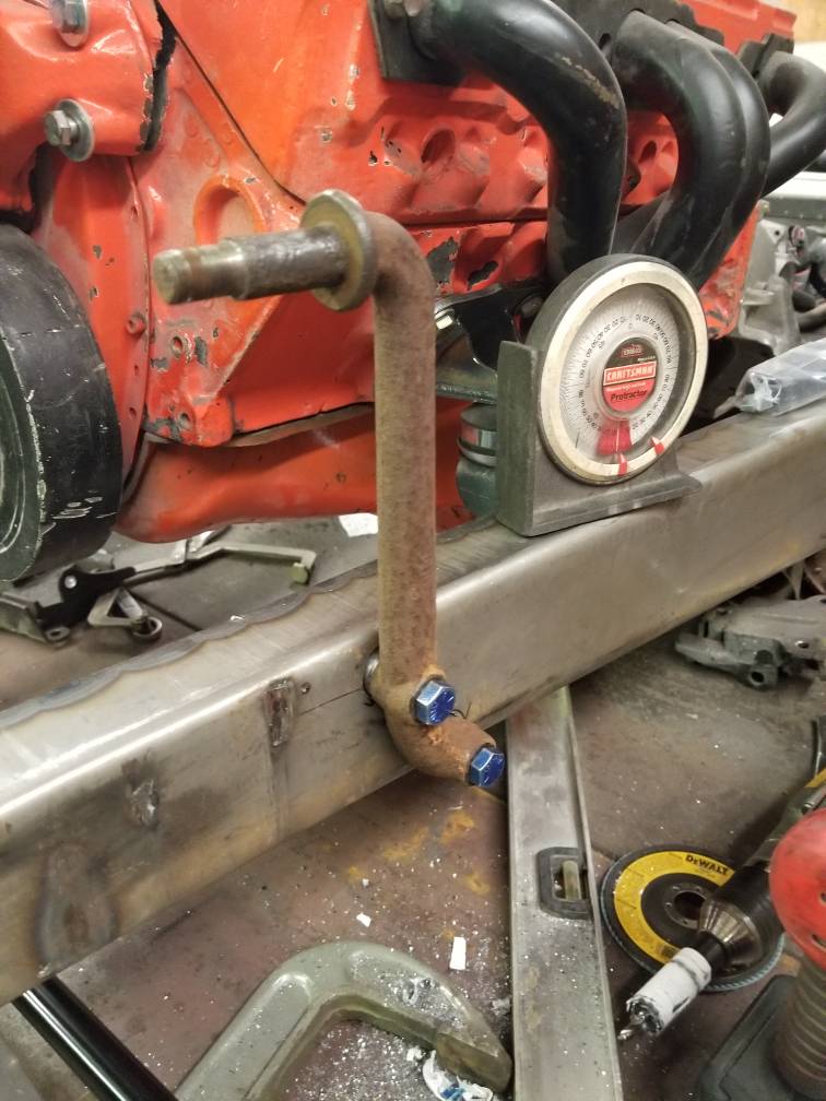

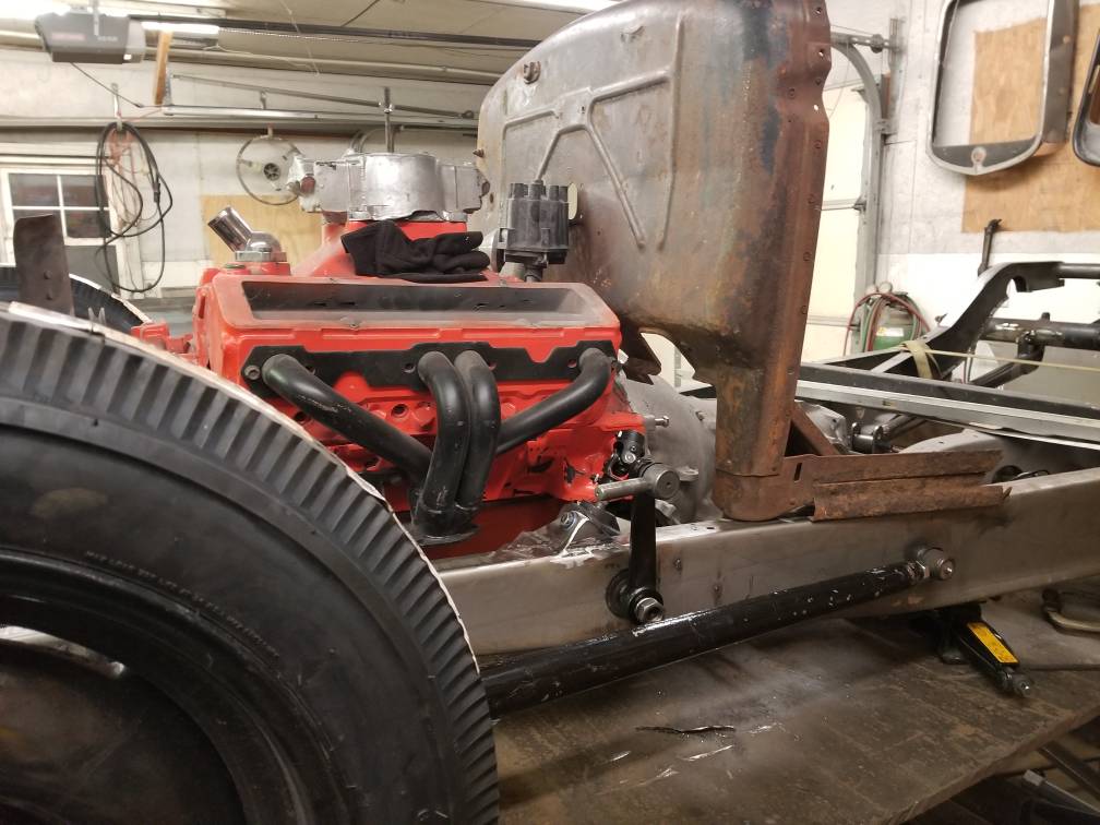

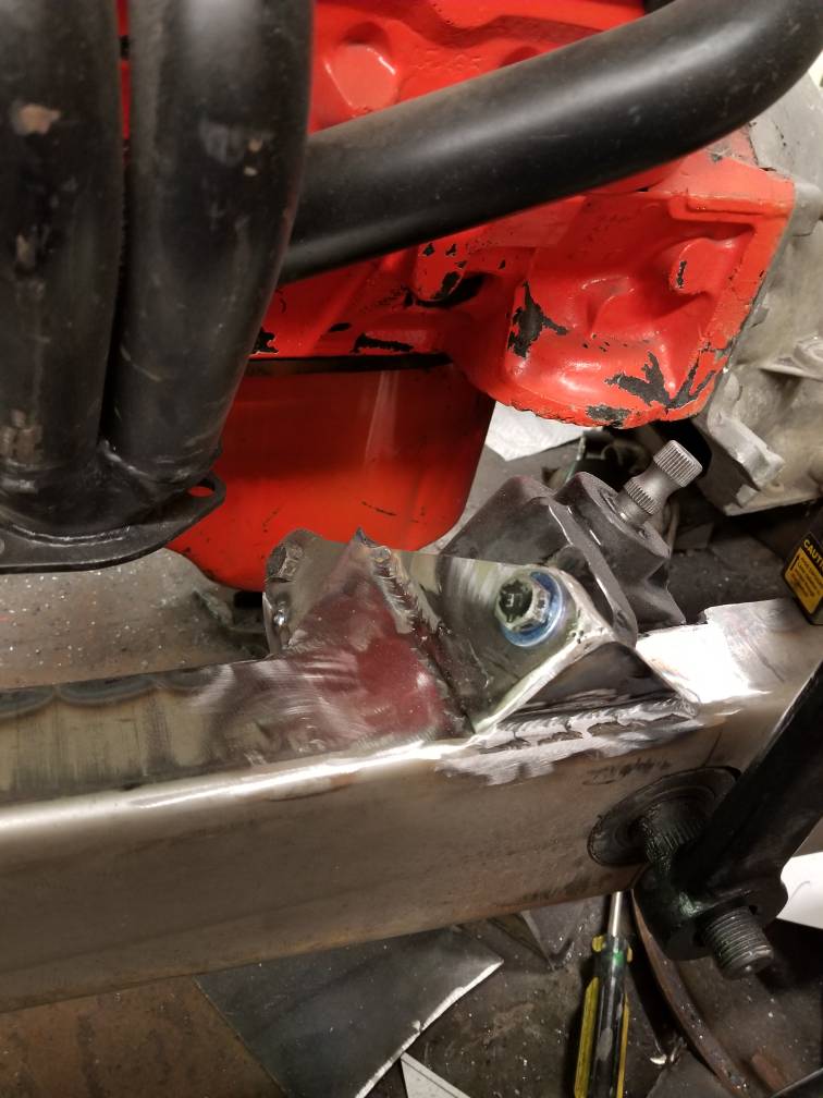

    I liked the steering set up on a article i read in hot rod magazine i believe. How to fabricate a ground hugging 32 chassis. Only difference is I'm going spring over the axle set up rather the spring behind. [​IMG][​IMG][​IMG]

    Its a vega box on its side. I do realize the possibility of bump steer and i am in know way wanting to start a discussion about it.
