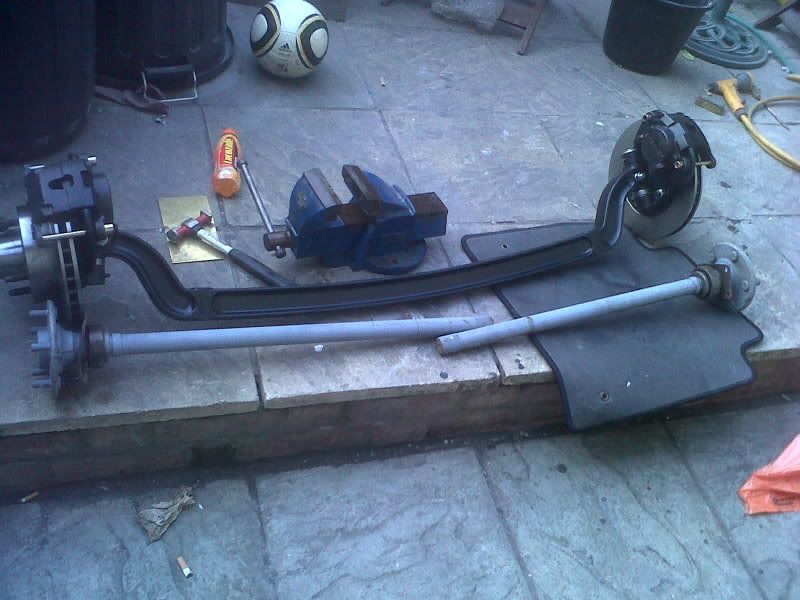

    anyways, was axle fun today
    collected all my front brake parts too.
    getting close to having rolling axles...
    you have to start from the ground up?
