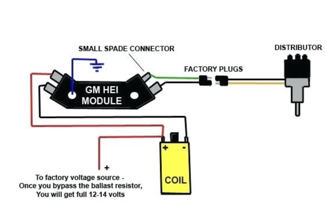

    If points were insulated (not be grounded to breaker plate) would it work? E31554CE-4C6A-4BDC-B6C7-938A5540ADA6.jpeg

    It uses the factory electronic distributor.
    It just takes the 2 original wires out of the factory electronic distributor and goes straight to the hei module. The hei module is now the "brainbox".

    That is clear in the photo. But does not answer the question if a mechanical contact switch would trigger the module?

    Thanks Jim. It was a quick thought at that moment of seeing the pic. I’d never use it, just another “ middle man” not needed in my opinion now that I know it’s possible via more add on’s not foreseen (resistor).
