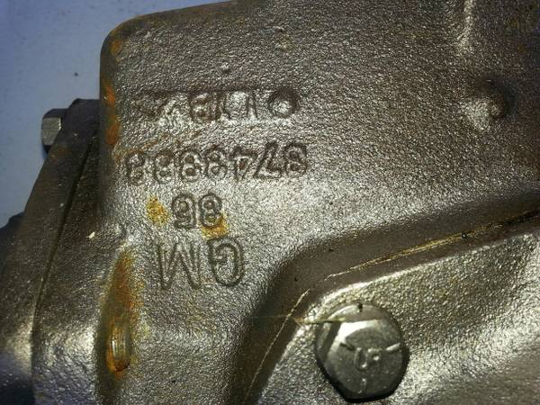

    Okay is this a muncie looks like one to me the guy selling it said it's a saginaw. 00f0f_cgjD5Gb0rKK_1200x900.jpg

  25. Yes that's a Muncie. a Saginaw has a 7 bolt side cover. many people mistakenly believe because some of them where manufactured in Saginaw Michigan they are Saginaw trans.

    Okay that what I thought but I'm new to the identifying Transmissions. Thank you sir.

    Typical standard 58-64 Chevy 3 speed. The close ratio ones did not have the necked down input shaft. No synchro on first.
