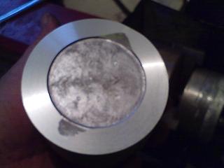

    Before any machining of the piston proper is done one must always establish a register or a reference point. because of how my fixture holds pistons I use the head of the piston and machine a register on the balance pads in side the skirt. EVEN (pay attention this is important!) if the piston is already machined there (these were not) it is rarely accurate or parralel with the head. So always do that first.
    I use this deal I made some (Yikes!) 20 years ago to hold my pistons for machining. It can deal with pin offsets , tapered skirts and so with a bit of care I can centre any piston and clamp it tight enuf for machining. I am very gentle by the way. Just a wisker each time so nothing moves.
    here is the finished deal. Taper matches the original valve relief for angle and since the cylinder head casting fills much of the combustion space I need so much removed I may as well just do it this way.
    Using averages this piston dome will give the same result as if the whole piston was plus .070 out of the hole. Stock piston was traditionally .003 out with one particular 4 barrel engine being 012 out so gain is substantial.
    by the time I give the heads a haircut and use my NOS steel gaskets all will be well. I am caculating a minimum of 11 to 1 for cam selection and figuring. The relationship between comp ratio and cam duration is a BIG deal in making and engine perform.

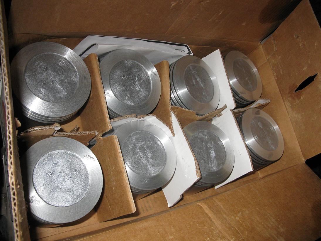

    Today I dug out the new pistons . I have 8 or a whole set. The one you have all seen earlier is only my "trysee." I always mess around with a spare first, just in case. Since I am happy with the plan I set all these up in the lathe and machined the register on all of them. Perhaps tomorrow if I have time I willl do the taper on the piston crown. Seems to be going very quickly this project. Pin fit then balancing and it is ready for rings and bearings.
  27. 2 pistons machined, 6 to go. Machining reduces weight by 19 grams. Set up takes less time then I had antticipated.
