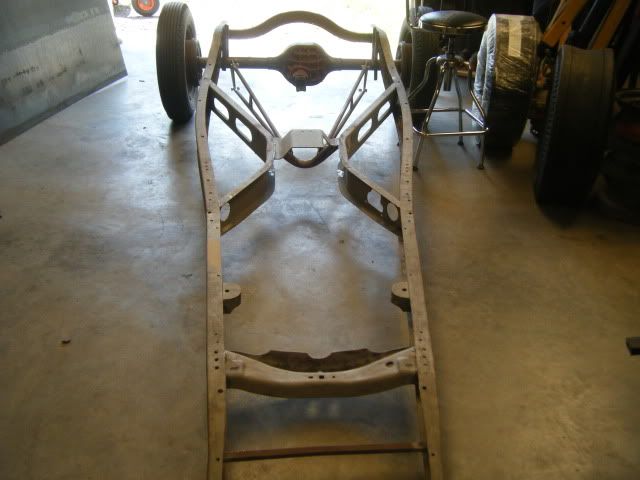

    I wanted to put some more thought into the pedals, so I jumped back on the frame. I got the body mount bolts welded in (Grits Style).
    I cut up a bunch of angle iron (1"x1") and welded them flush with the inside of the frame every 6" and then started tacking in the boxing plates.
    This took forever and was done slowly over a couple of days since I am without a frame jig and I was concerned with warping the frame.
    After a ton of grinding. Mounting the boxing plates flush was a lot more work but I would do it again.
    The front boxing plates will be next and I am hoping the rear end will be done by then. I ended up picking up the engine after two months since nothing had been done, I was really disappointed. Anyway I have found someone else but it will be three weeks before he can start. Which is ok because I really need one more mockup to check the exhaust manifolds and steering column.
